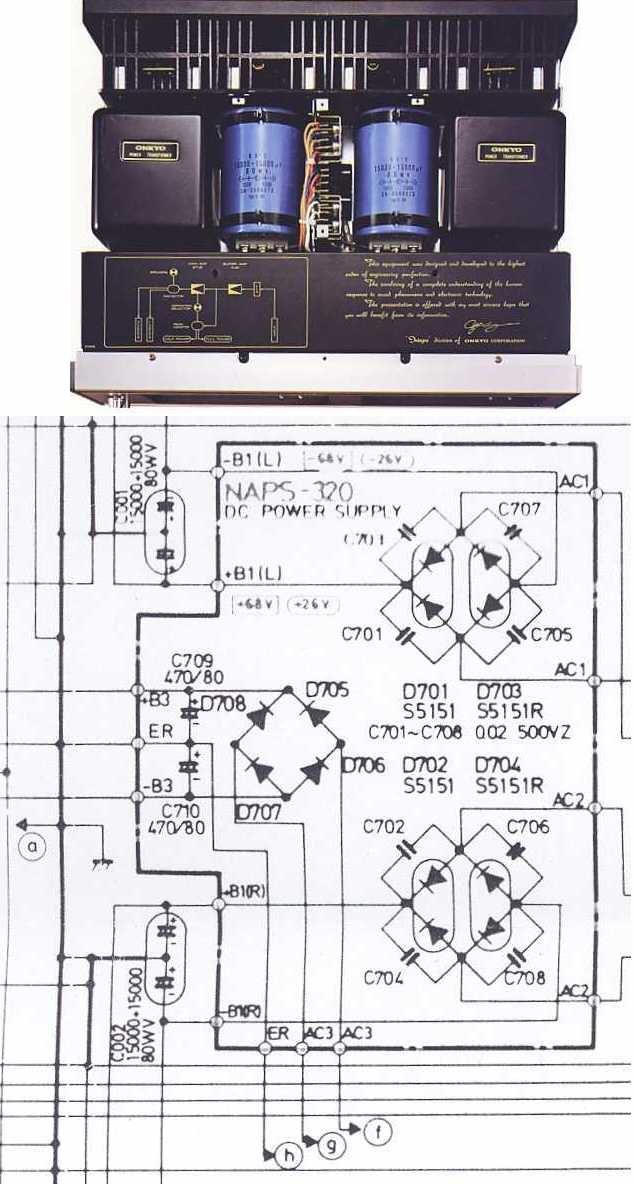

Hello! I'm subscribing from Tokyo. This is my first post.
I'm inexperienced in amplifier building and repair, but I need to replace a rather unusual electrolytic capacitor in the power supply of a 28W+28W Class A transistor amplifier made by Onkyo in 1976. The component to be replaced is a single large (75 x 110 mm) component but is functionally the equivalent of two 15000uF capacitors connected in series, with the center point connected to the bus earth line. This component has three connectors, "Plus," "E," and "Minus"; it is marked with the values "15000uF + 15000uF 80WV."
Since I have enough room and since I found a cheap source of computergrade capacitors, I am thinking of replacing this component with an array of six identical 12000uF 80V capacitors. (For example, creating two 36,000uF parallel chains and then joining the two chains in series would be one possibility.) Other configurations are also possible, and it would also be possible to use only four of these capacitors rather than six.
Here are my questions:
1) What is the best strategy to take here? Four capacitors? Six? What configuration?
2) Do I need to use balancing resistors? If so, how should I use them?
Thanks for your help!

If I connect only in parallel, how do I earth?
Joe Dirt, thanks for your reply. Perhaps connecting in parallel w/o resistors is all I need to do; however, I'm curious as to what I need to do about grounding the capacitors . . . the original component has three connectors; the one in the middle is "Earth." If I have all my caps connected in parallel only, where do I put the connection to earth?
I decided to post a pic of the amp and part of the schematic after all. (I hope this works!) At the bottom of the big caps in the center of the amp, the three connectors can be readily seen. The corresponding parts of the schematic are where the letters are rotated at a 90 degree angle from all the other lettering.
Now, assuming I *shouldn't* connect only in parallel. but need to have a series connection to facilitate earthing as in the schematic, if I have two parallel capacitor "chains" connected in series, can I still get away without resistors? I have read that if only two caps are connected in series, a balancing resistor isn't needed. Can I consider each of the parallel "chains" as a single big cap? Or am I asking for trouble if I hook up capacitors this way without using any balancing resistors?
Thanks very much to all.
If you connect N caps with a capacitiy of X Farads in parallel then you get a thing that behaves as a single big cap with N*X Farads.
Balancing resistors are needed for series connections of caps.
I think your amp has two separate power supplies with center tapped transformers. So you will most probably not need any resistors.
The amp seems to be a nice and tidy construction and worth the hassle of a refit.
Regards
Charles

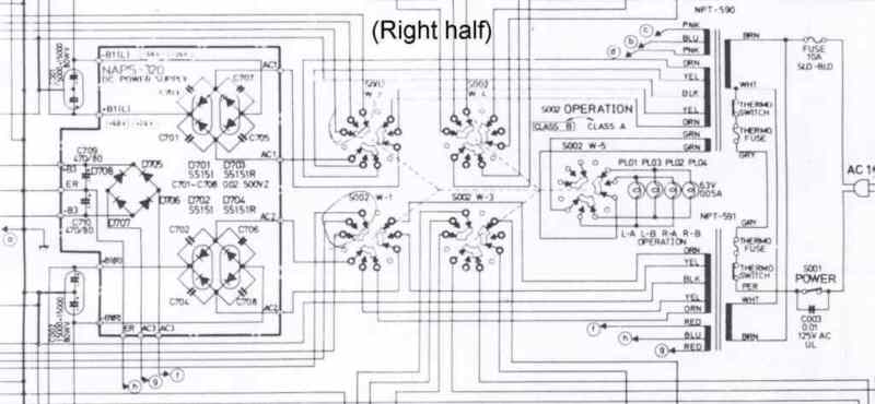

I'm going to post more of the schematic now. The right-hand half goes in this post, and the left-hand half in the next.

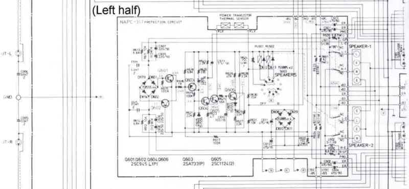

Re: Here's the left half of the schematic
Can we have a look at the rest of the circuit?
Have you tried doing B & W scans instead of gray scale? Files may be smaller in that way.

Hi-res scan of complete schematic
Clicking on the following links should take you to two scans of the complete schematic. They are black and white, 300dpi, in GIF format.
These are posted at a Japanese website, and your browser will probably "complain" or ask you if you want to download a plug-in to be able to read Japanese on your computer. If you just answer "No" to that error message, the image should display just fine. The image will be displayed in a frame, but if you right-click on the image, you can open it in a new window of its own or download it to your computer for printing.
Each half of the schematic fills an A4 or letter-size sheet of paper if printed at 300dpi.
Also, the free site where these are posted gets busy at certain times of the day, so if you have trouble accessing, it probably means it's a peak traffic period for that site.
If there are any problems, please let me know.
Here's the left side of the schematic
Here's the right side of the schematic

cdwitmer said:This component has three connectors, "Plus," "E," and "Minus"; it is marked with the values "15000uF + 15000uF 80WV."
Thanks for posting the schematic. The centre terminal of the capacitor goes back to a tap on the transformer and so this is a conventional full wave bridge. Balancing resistors are not required in this arrangement.
As for the number of capacitors I would be tempted to replace each capacitor initially with four of your new ones. This gives a capacitance of 24000 uF per half of the old 15000 uF cap which is closer to the original value as designed. The only reason not to use six for each cap is that the charging current through the diode bridge will increase as you add capacitance. Most bridges will cope with the extra current pulses ( which are quite short - a low duty cycle ) so you may be okay with the extra caps.
Hope this is understandable - I can draw you out the capacitor arrangement if required. Joe Dirt has also offered earlier in the thread, I think.
James
Thanks again, Jonathan & James
