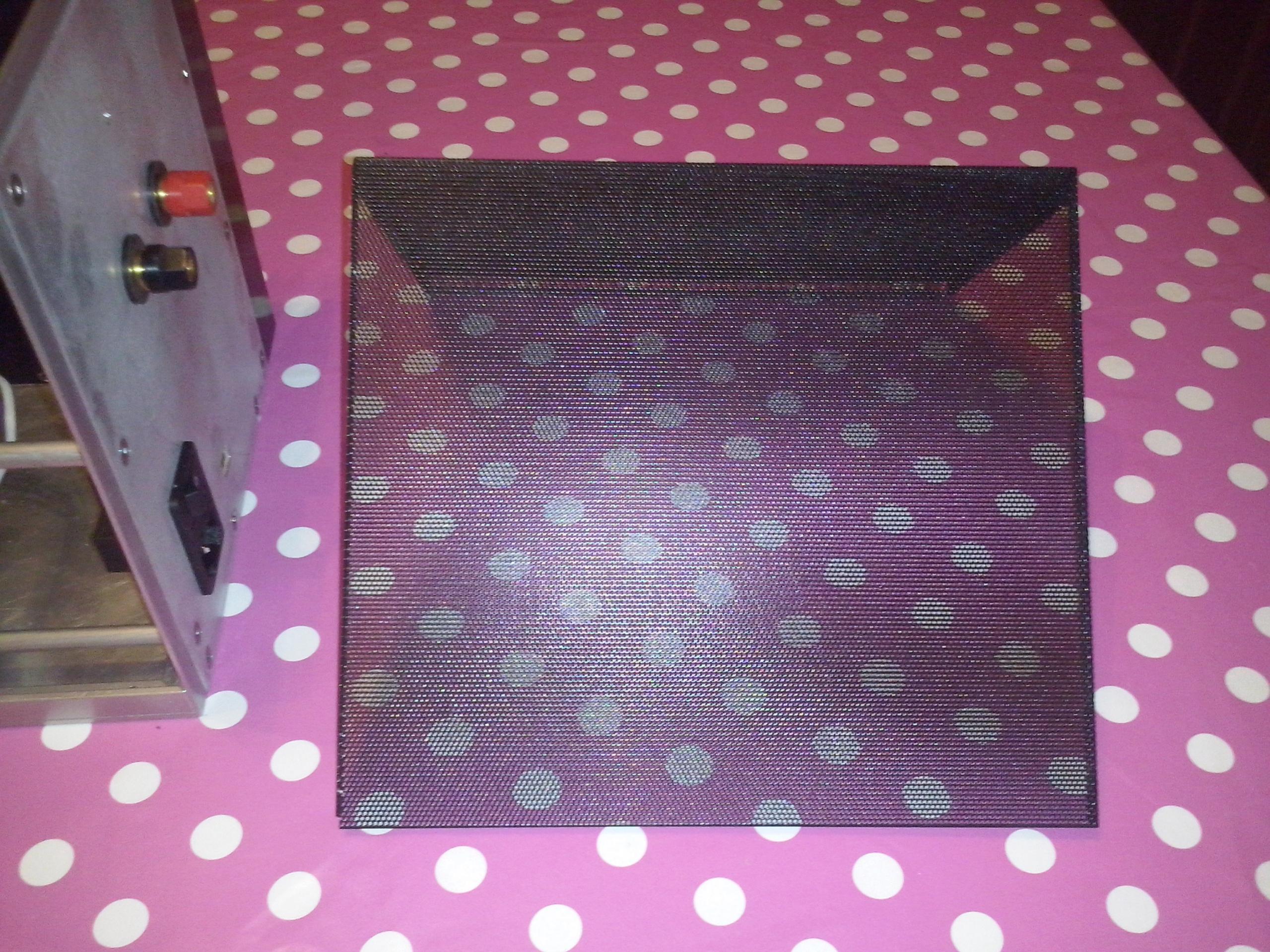

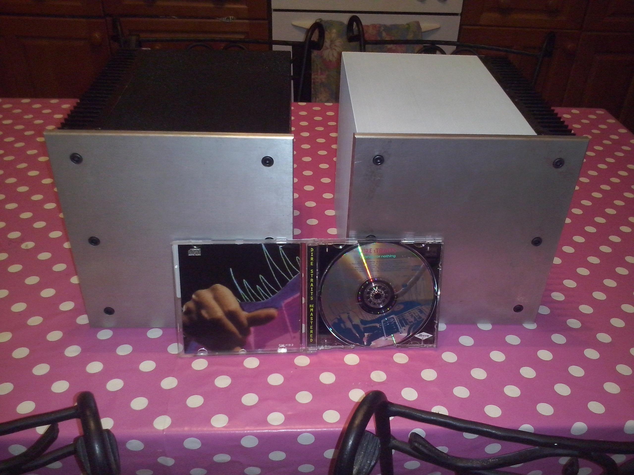

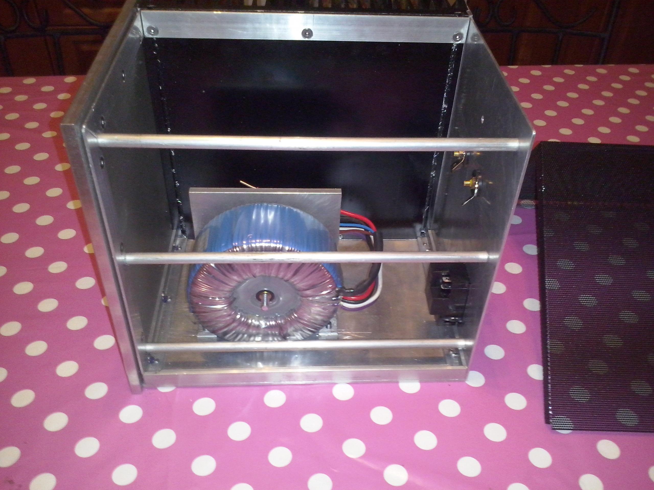

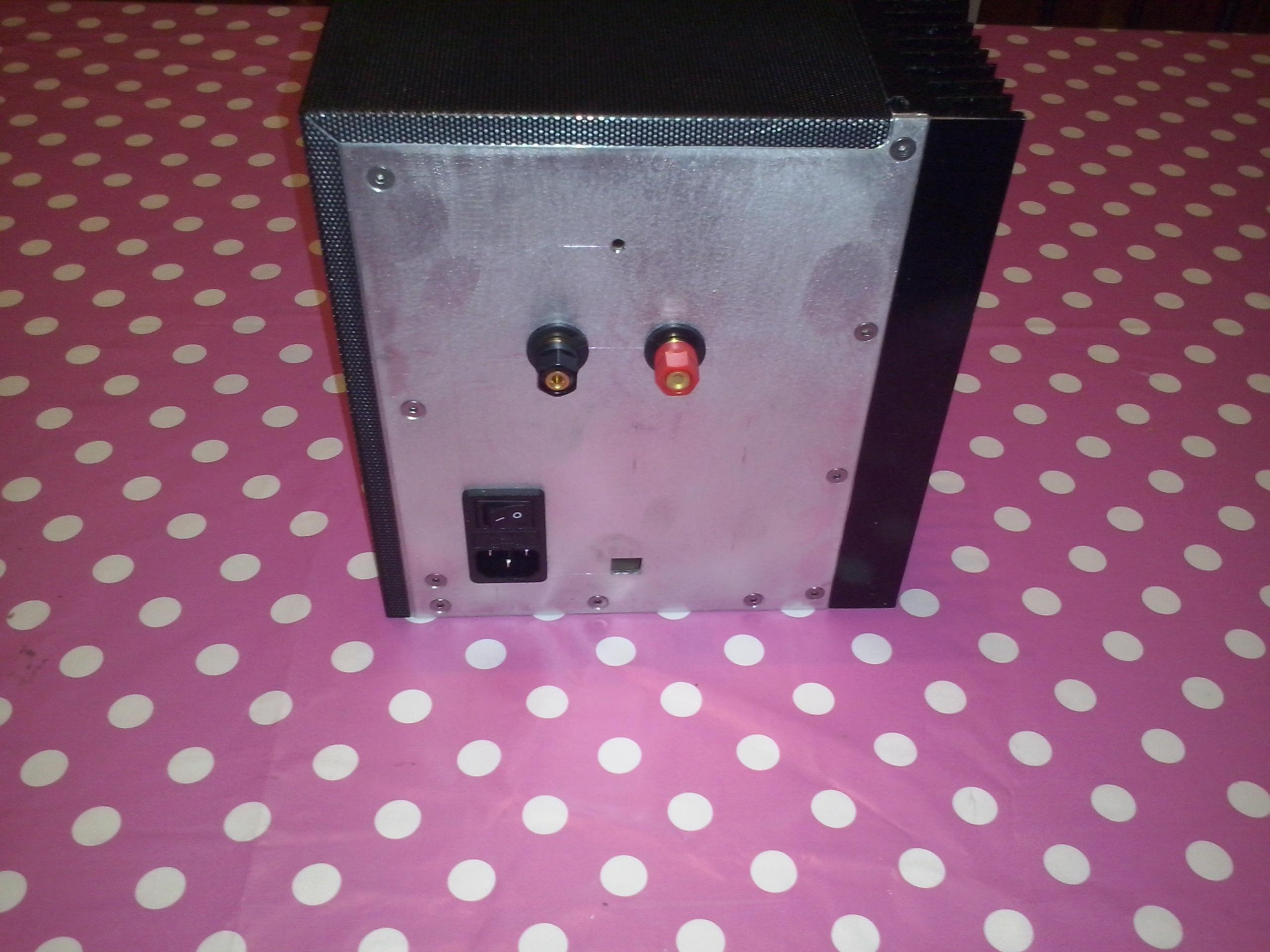

Played a bit more today
Main plug with fuse in the back panel and speaker posts, made hole for control plug and pilot hole for the RCA.
Fixed the main transformer to the chassi.
