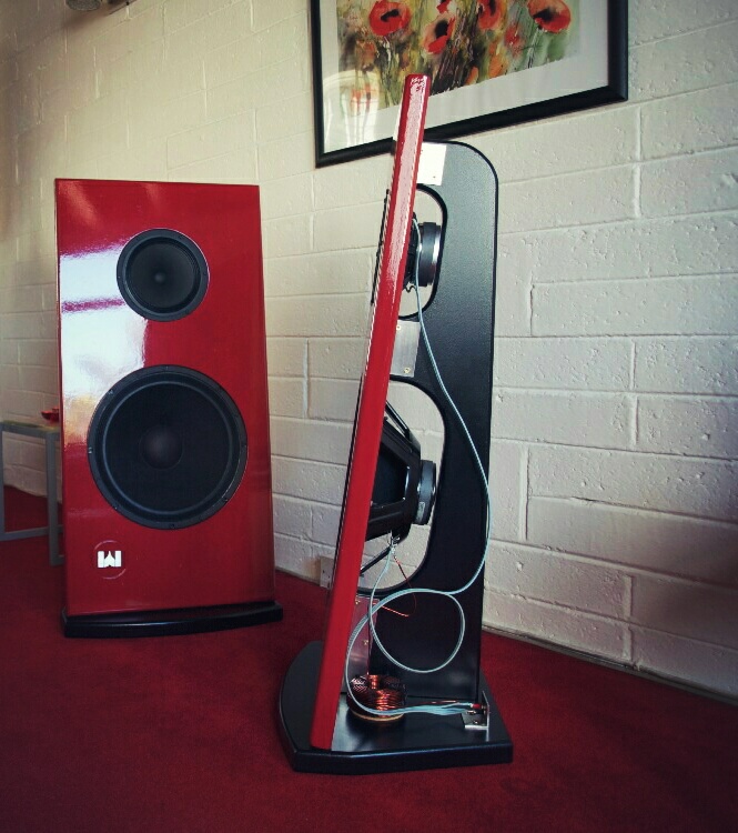

Is this the PureAudio Project you were referring to ? Why are they using 2 Sub and 1 midrange ? Is it because they want to achieve more of the lower frequency from 40 hz - 20hz with -6dB slope at the end ?

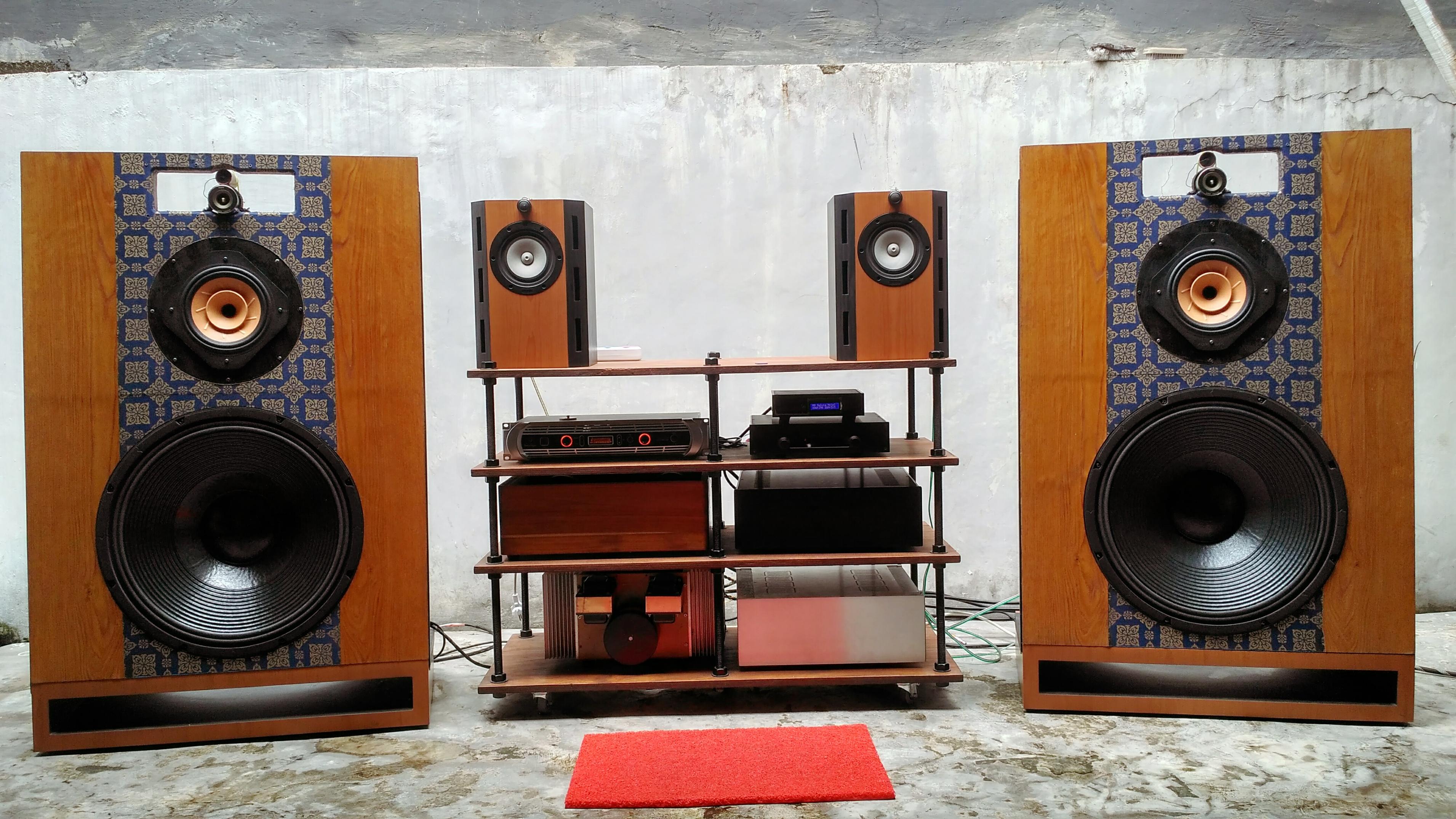

I consider my system as FAST ~ 8" Fullrange ASsisTed by subwoofer and supertweeter.
currently i'm using active xo only for subwoofer, while for 8" fullrange is unfiltered then followed by additional supertweeter which only use simple 1st order filter with 0.47uF caps.
As i mentioned previously, I have tried 3way approach but using passive xo and it was a headache for me. All those theories and calculation drove me crazy, especially when I dont hear good result from the xo that i tried.

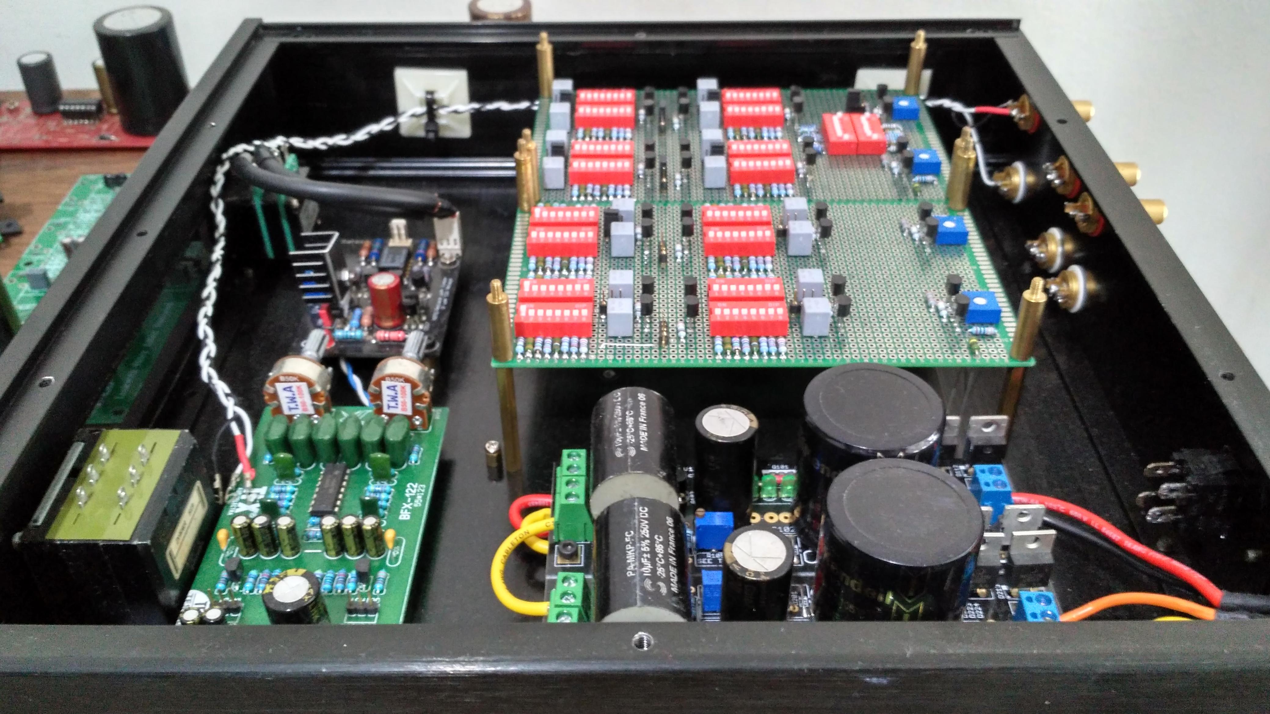

I also tried to build B5 active xo but extend to 24dB, i read you are also interested on this, however I did not finish it yet. I might revisit it someday after i complete my 5th variation which will require 15" & 8" xo, i will try it first with passive xo.

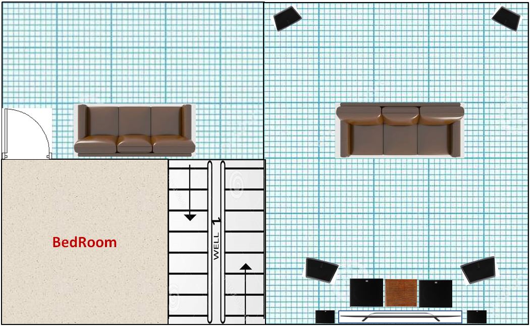

gadut, thank you for telling about your projects and experiences!
I started to think about wall reflections when I looked at your pictures. Obviously walls are concrete/tile and because of the room being relatively small the speakers must sit close to front and side walls. Dipoles are very sensitive to front wall reflection/interference and they need lots of free space to breathe.
Your measurements are obviously mostly at listening spot, then we see also back wall reflection and room modes... I have found that it is very difficult to get reliable and consistent measurements of bass indoors, because nearfield of a dipole doesn't tell much. Often reflected sound has more energy than direct, at listening spot!
My guess is that these problems are major factors making the challenges that you have had.

Thanks Juhazi, your building history inspired me, had a thought on baffleless build but maybe not in short time :)
I agree that OB need extra room behind to breath, some say 80cm is minimum. But i dont have that luxury in my room now, i have 5x6m space on my backyard which i have to build one day (half right side on below picture) 1st floor as family room & 2nd as my children bedroom but this will be in the next 6yr after my saving is adequate. I might need around $25k to build that.
attachment.php
on previous month i had brought my setup to this backyard and put it on 6m side with 1m backside. Indeed i got better imaging and focus, with this experience I have to stop my greed to apply any extra mortgage for my renovation, I'd rather save money instead of paying extra interest.
attachment.php
The improvement that I got on moving from boxy speaker to OB is greater than what i experience from moving my system from 3x5m to 5x6m room. my point is that do not let room restriction to stop you step into OB, indeed it will give more eargasm to any room that you have instead of keeping on boxy speaker.

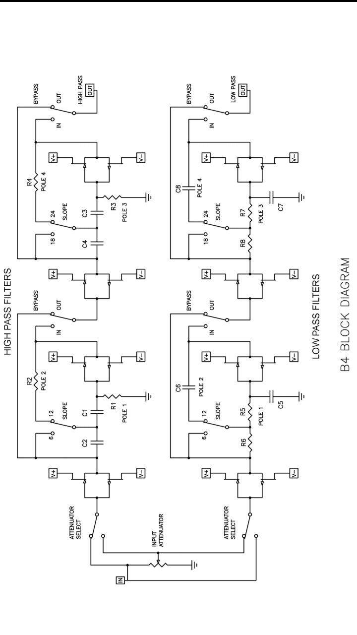

related to B5, i have no schematic at all, everything is flying on my head when i build it, like always. but i use information from here
B1 Active Crossover
what i understand is that B5 basic is using dcb1 buffer, plus additional bass boost and bsc circuit where it's limited to 12dB filter. When I read B4 manual, i find it has more interesting option 24dB filter but using J74 will be very expensive
attachment.php
so what i build was B4 dna but using K170 only

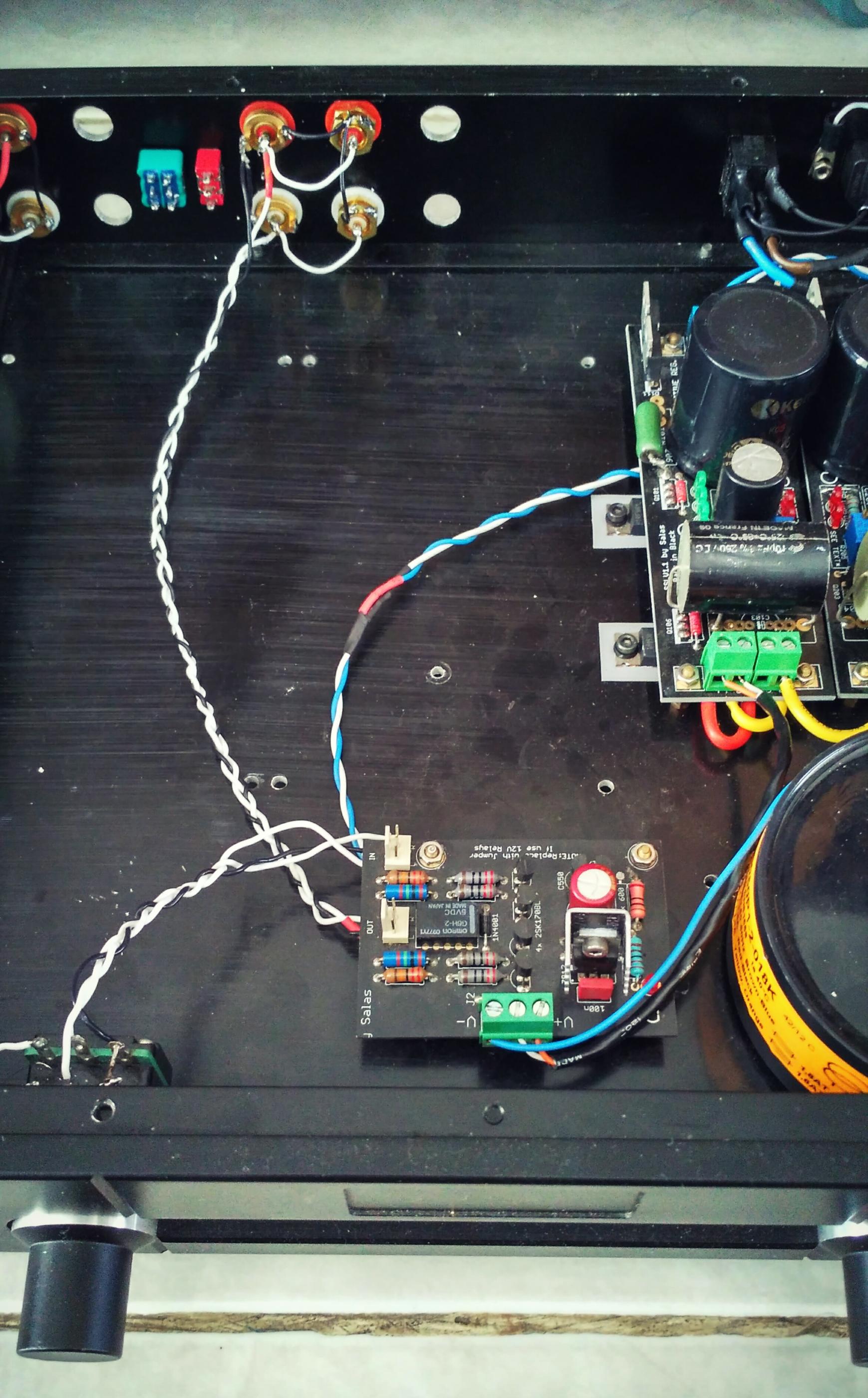

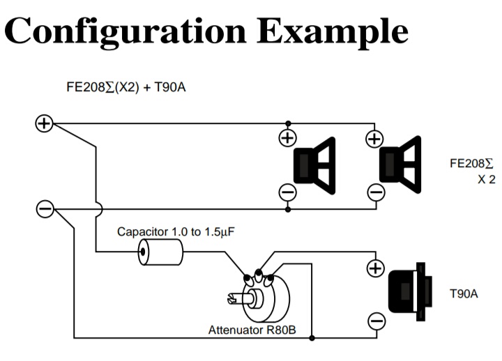

Gadut, in your FAST system, if you use only active Xover for sub and non-filter for full range, and a 0.47uf cap for super tweeter, how would you connect your music source to the speaker ? I would assume music source go to Active Xover, then you have 2 or 3 outputs from the Active Xover to go to amplifiers to either LF, HF of speakers. Did you just only use 1 LF output from Active cross ? how would you connect your music source in this case to passive cross for full range for super tweeter ? Sorry for alot of questions. Hope you don't mind :)

Hi Tom,
i suggest you pick 15" woofer that is designed for OB, Augie should be good but maybe AE dipole will be better.
I find that MJK is happy with AE dipole and there are many other happy post about it.
8" Fullrange for OB is more common size that is used, i suggest you pick this size hence later you can swap different driver on the same hole. You have 8" option for AudioNirvana, Lowther, TangBand, etc. SAL driver is pricey and 6.5", better you start with AudioNirvana or TangBand, because spending more than $1k will be a real challenge. I will have an audition first before buying it, you can find someone near location that you can contact.

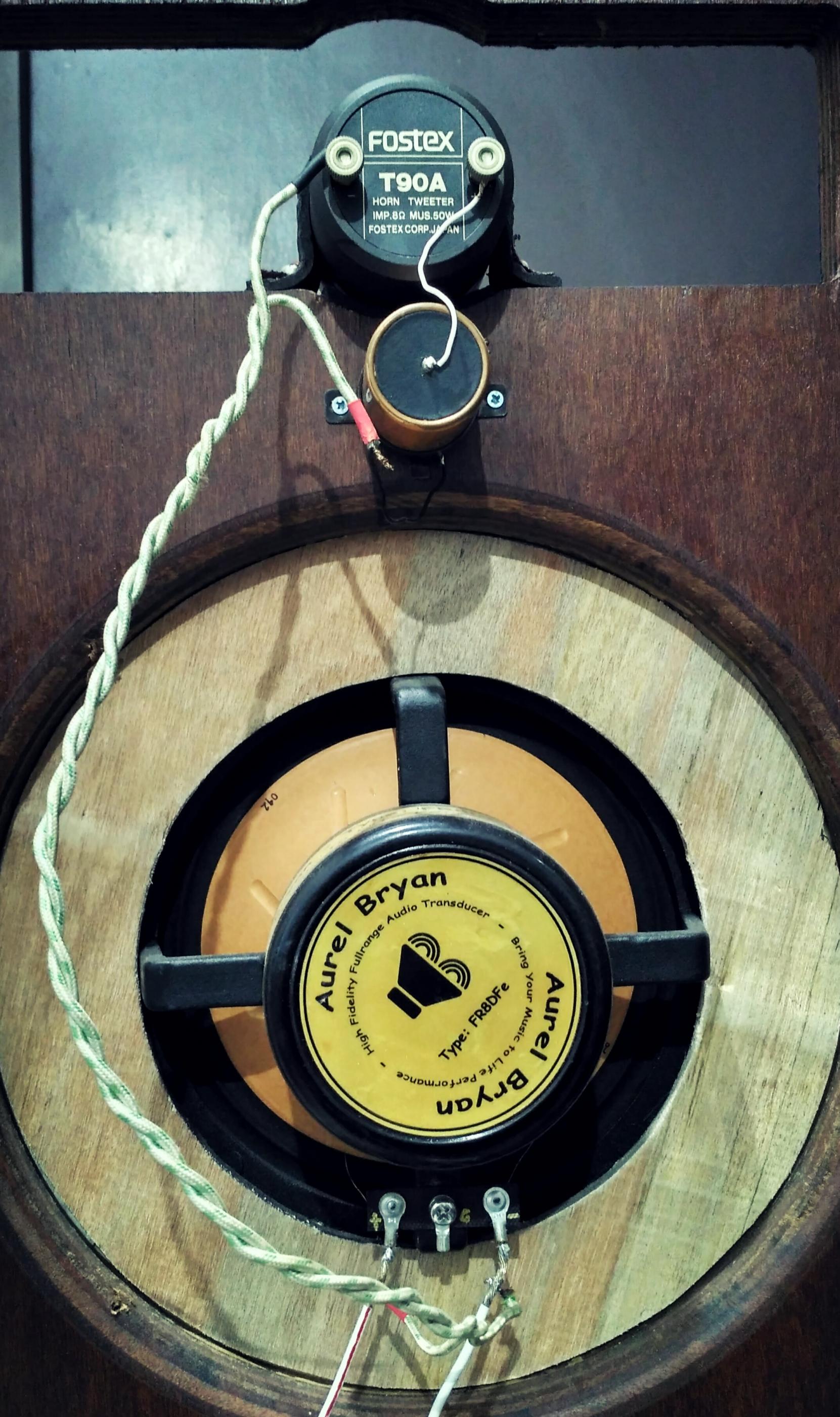

I'm using DCB1 which i add extra rca output, 1 goes to behringer that power my sub and another goes to FW clone which power 8" & T90a, easy and simple connection.
attachment.php
On fullrange side, you can look at T90a datashet that shows connection sample. While i'm using 0.47uf without attenuator or you can follow it.

Gadut,
Thank you so much for the valuable inputs. It is a great starting point for me. I will follow your advices to look for 8" full range and 15" sub for my OB design.
One last piece of info, when you said "I'm using DCB1 which i add extra rca output, 1 goes to behringer that power my sub and another goes to FW clone which power 8" & T90a, easy and simple connection. "
--> I would assume, you are building an active 2 way Xover using DCB1, output LP of Xover goes to behringer which power sub and output HP of Xover goes to FW clone that power 8" and T90a, right ?

Hi Tom,

Hi Tom,
i think it is a good time to start your build during holiday :)
it is just a regular dcb1, no additional filter at all. what goes to behringer and FW clone is full signal.
Hi Tom,
if you cross sub too high or T90a too low will have crosstalk effect, for me i want Fullrange to do most of the job. I had tested my sub amplifier which has internal active xo with 12dB filter between 80 & 120 Hz, i found the midbass is too dominant, hence 24dB is the best for me right now. While T90a was also tested with 1uF and was too dominant, so 0.47u the best for me.
Your ears and drivers option that are different with me will lead to different configuration, but you can start with what I had tested as starting point then adjust it later.
