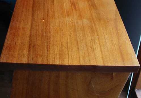

The second one looks amazing! What kind of veneer and finish did you use?
jbateman said:Have you ever tried wiping varnishes? I get pretty good results with Minwax, and there's no equipment costs.
It's curly maple dyed using a product from www.Constantines.com. They call it a "water soluble stain", but it's just a dye powder that you mix with water. They sell a sampler set of 7 colors for about $18. The one you mentioned was red mahoganyzoooh said:The second one looks amazing! What kind of veneer and finish did you use?
