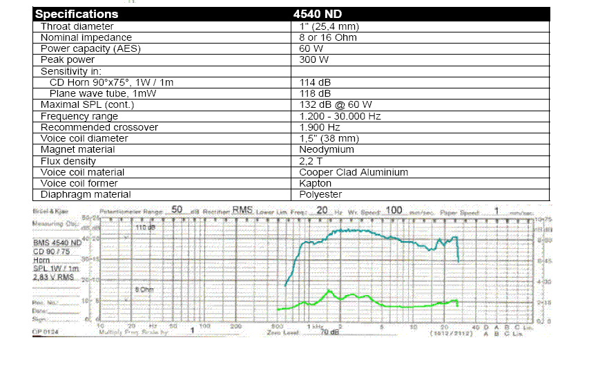

Recomended xover @1900Hz for the BMS CD.
Another idea for the woofer is a BMS ($200.00+/100dB+).

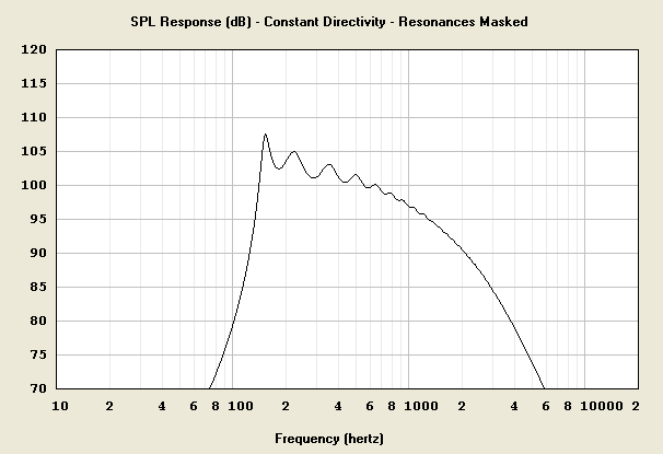

I can't get the JBL 2206H driver to respond well up to even 1200 Hz in HornResp. I've attached the SPL graph of the best that I could get. Am I doing something wrong, or is this just not a very good driver for a horn?
It seems to me that the drivers with a low Le seem to model higher frequencies better in HornResp.

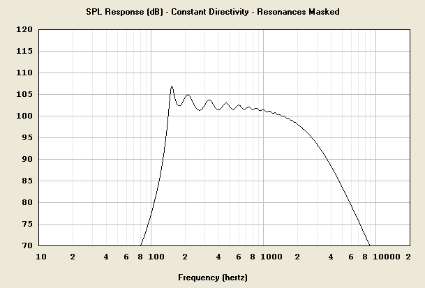

I'm guessing that the driver that they are referring to is the Eminence Beta 8A:
http://www.partsexpress.com/pe/showdetl.cfm?&Partnumber=290-404
I was able to model this one in HornResp a lot better. I can actually get from 150-1500Hz with it. I've attached a graph. Are the wiggles on the low end normal?

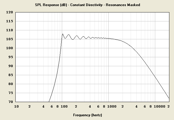

I'm really set on at least trying the horn thing. I might later decide to do a direct radiator system. Also, a friend of mine might be doing a speaker system at the same time, so I'll pass along the info. I did notice that JBL has the 2012H 10" driver that is intended for horn use. That one modeled very well. It has an inductance of 0 at 1kHz. Its $250 though and I can't find that one used.
