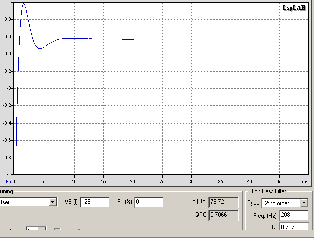

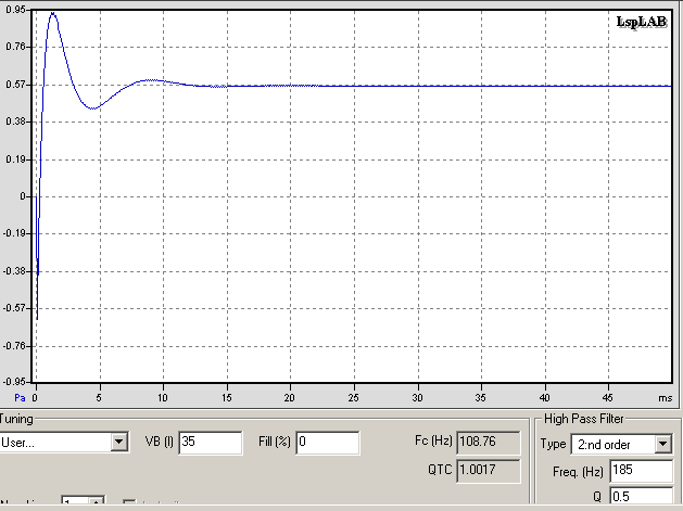

The fact is that I use a very big midrange driver vith a Qts of 0.56
In 125L, the Q of the enclosure is 0.707 and Fc is 76Hz
In 36L, the Q of the enclosure is 1 and Fc is 109Hz. I add the Q=0.5 Fc=109Hz filter and the overall Q becomes 0.5.
The little issue is that the modelled step response shows some overshoot that is not that strong in the bigger enclosure...

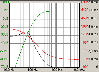

AndrewT said:Hi,
Midrange driver going down to ~100Hz?
Most people would use a driver of 100mm to 170mm as a midrange and probably extend it down no lower than 200Hz to 300Hz. My 135mm driver (93mm cone) is -3db at 400Hz, although it is capable of going down to 69Hz, it would run out of Xmax too soon if it were used as an upper bass driver.
In fact the driver is quite particular : it is sold as a fullrange driver but I wanna use it "extended range" in quite an high-end system.
It is the Supravox 215RTF and it is an 8" driver with Xmax=2mm
I have two choices to filter it :
- load it in a big volume with a low Fc and low Q, and filter it at 150Hz
- load it in the 35L box with both the filter and enclosure tuned at 109Hz.
In both cases, the speaker never runs out of Xmax at the rated power and still produces 114dB/1W/1m
It is filtered low to get all the bass qualities of this driver.
But the problem is that I get some problems in both cases :
- in the big volume, the filter is not "synchronized" with the natural rolloff of the enclosure and it may lead to phase/delay problems
- in the small enclosure, I get some ripple on the modelled step response which looks a bit like the step response of a bass reflex (what I precisely want to avoid)
I don't know which is the "least worse"... (place is not my mian problem)

Coming back to my filters, I have modelled the combined effect of a 126L enclosure with a 208Hz 12dB filter : I almost get the same response as a Q=0.5 Fc=160Hz 4-pole filter.
With the advantage of a much cleaner step response (no more ringing)

As I said before, the small volume for the midrange + the effect of the active filter lead me to a form of ringing on the step response. I really want to avoid this because I know how it degrades the sound.
Furthermore, the group delay increases much more in the 35L enclosure than in the 126L one (in fact 100L, with damping it makes ~125L) and the same overall filter slope gives a less linear attenuation. (given is the step response of the 35L box crossed at 160Hz)

The frequency response of the 35L filtered enclosure : compare with the graph I posted yesterday, and note the higher group delay and less linear response.
