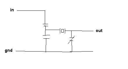

If you have a low-impedance output on your oscillator that can drive a small capacitive voltage divider, you can probably make a filter like this:
capacitive voltage divider (C1, C2) - crystal - capacitor to ground (C3)
where (C1+C2)*C3/(C1+C2+C3) must be the crystal's load capacitance, and C3 must probably be a trimmer to fine-tune the filter's centre frequency.
As a netlist:
V1 1 0 // input voltage from the crystal oscillator
C1 1 2
C2 2 0
X1 2 3 // filter crystal
C3 3 0 // trimmer
The output is then taken from node 3, so across trimmer capacitor C3.
The trick is to dimension everything such that the crystal is driven hard, but not (far) above the allowable drive level.
The most difficult part is to convert the output signal of the filter into a square wave without messing up the phase noise too much. Fast bipolar comparator maybe?

The datasheet seems to imply that the second crystal (acting as a filter) improves things beyond 100Hz. The improvement below 100Hz comes from other things such as careful mechanical and thermal design. This is roughly what one might expect. I guess an expert on oscillator noise with good fabrication facilities might be able to DIY something similar. Your average audio DIYer? No chance!
The second crystal filters phase noise from 100Hz away, and further. A second crystal oscillator is no help, because it is an oscillator - not a filter.
The oven and mechanical design deal with closer phase noise by isolating the circuit and crystal from outside influence.
All this has already been said in this thread or in the datasheet - apart from the knowledge that a crystal filter and a crystal oscillator are not the same thing, which is basic electronics.
