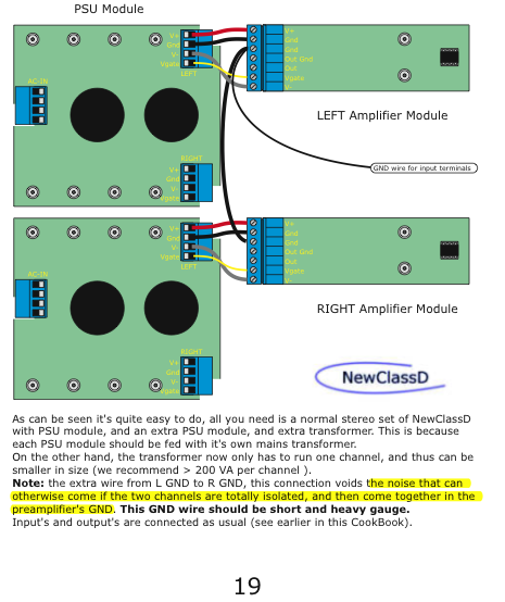

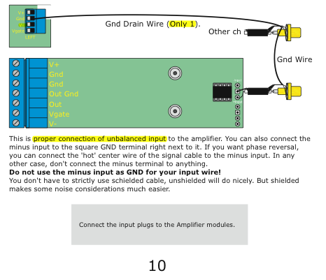

I suspect you have a ground loop that's creating ripple across Lars' numerous ground lift resistors under load, thereby triggering the protection repeatedly and causing repetitive load dumps.

After a 2567 km trip to Holsterbro and back i have no a working amp - at least it was working when I left Holsterbro. Had a long day with Lars and Brenda i their workshop with my HTPC, my fourwinned balanced silver signal cables, my fourtwinned speaker cables and my dual mono NCD1 with a new and fresh module instead of the last burned one.
We checked everything with instrument and an oscilloscope and found everything in order. Nothing found that could be strange at all. Maybe maybe there could be some strange kapacitance in the speaker cables as we found the resonance frequence maybe a little bit low - but that is nothing that was absolutely stated.
Averything was working, playing as loud as the facility (and Brenda) was allowing for hours without any module closing down or burning......
I was confused - and Lars was smiling, he said that he still hasnt burned any modules or speakers. . .
Back at home I haven´t started up the system yet as I want to measure the electrical system in the house for stange voltage in ground or zero. . . There HAS to be something strange here.
Just wanted to keep you posted guys that was engaged in this strange phenomenom.

The power in the house is checked and fine 229VAC, no strange power between ground and Zero, no power i ground or zero etc.
The only new thing in the setup is a better cooling plate for the modules in the amp - which was put on down at NewclassD (at no cost - once again thank´s Lars).
So I might set the whole thing up during the weekend - keep Your fingers crossed guys....
BTW - Does anyone know how to 1) get cones & surrounding for a Thiel C220 element that my Ncd1 smashed, 2) get the element fixed and/or 3) buy a new C220 for a reasonable price? It seems impossible to do any of theese in Sweden?
Maybe check for "stray" DC between null and ground, and DC on the AC line as well? You might want to consider an el cheapo power conditioner with DC trap and surge supressor, I have used one of these for years Br 505 og Br 507 - Netstøjsfiltre. - just an idea.
