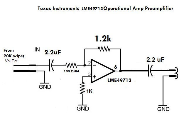

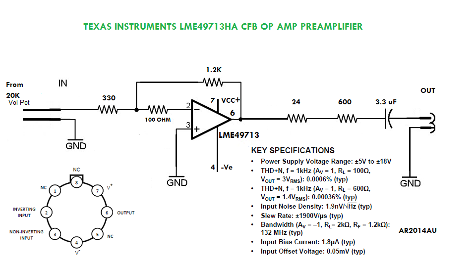

Anyone try and succeed at a simple LME49713 pre, either inverted or non-inverted configuration?
The one I tried (attached) is far from working without a lot of noise. I have also tried the non-inverting config by swapping pins 2-3 input and it is even worse with about -6 volts at the outputs.
I'd hate to waste these parts, if you have a working schema, by all means...kind of been in the "try this try that" road and need a proven working circuit.

Now to schematic.
The inverting topology has a gain of 1k2/100 = 12times (+21.6dB)
That is a lot for a pre-amp. Ends up adding noise when the excess gain is not required.
Have you read
http://www.diyaudio.com/forums/diyaudio-com-articles/186018-what-gain-structure.html
Zin, the impedance seen by the Source is 100ohms. That is bad for the sources.
The bandwidth is unlimited at RF except by the limitations of the LME. That is bad for interference.
The LF bandwidth is set by the 2u2F and the 100ohms. It has a roll off F-3dB @ ~700Hz. That is bad for mid and bass reproduction.
did you download these two technical documants?
http://www.ti.com/product/LME49713/technicaldocuments#doctype10
Do you know that CFA opamps require different feedback from VFA opamps?

The current feedback opamps are better suited to driving low impedance loads and fed from low impedance sources. A voltage feedback opamp driving a current feedback opamp would be more successful in this application. I would use an LM49880 for the input and the LM47613 for the output with feedback from the output. Set the '613 for unity gain non-inverting and the '880 for about 6 dB gain using low value resistors, e.g.: 475 Ohms feedback and 475 Ohms to ground. The bandwidth of the '610 won't add phase to destabilize the '880 in this configuration. You should be able to drive something like 50 Ohms with unmeasurable distortion to possibly 1 MHz at 3V out. Input Z can be as high as 1 Meg so it won't load the pot and add distortion there.

You might get some clues from this,
http://www.diyaudio.com/forums/anal...rent-feedback-opamps-simulation-practice.html

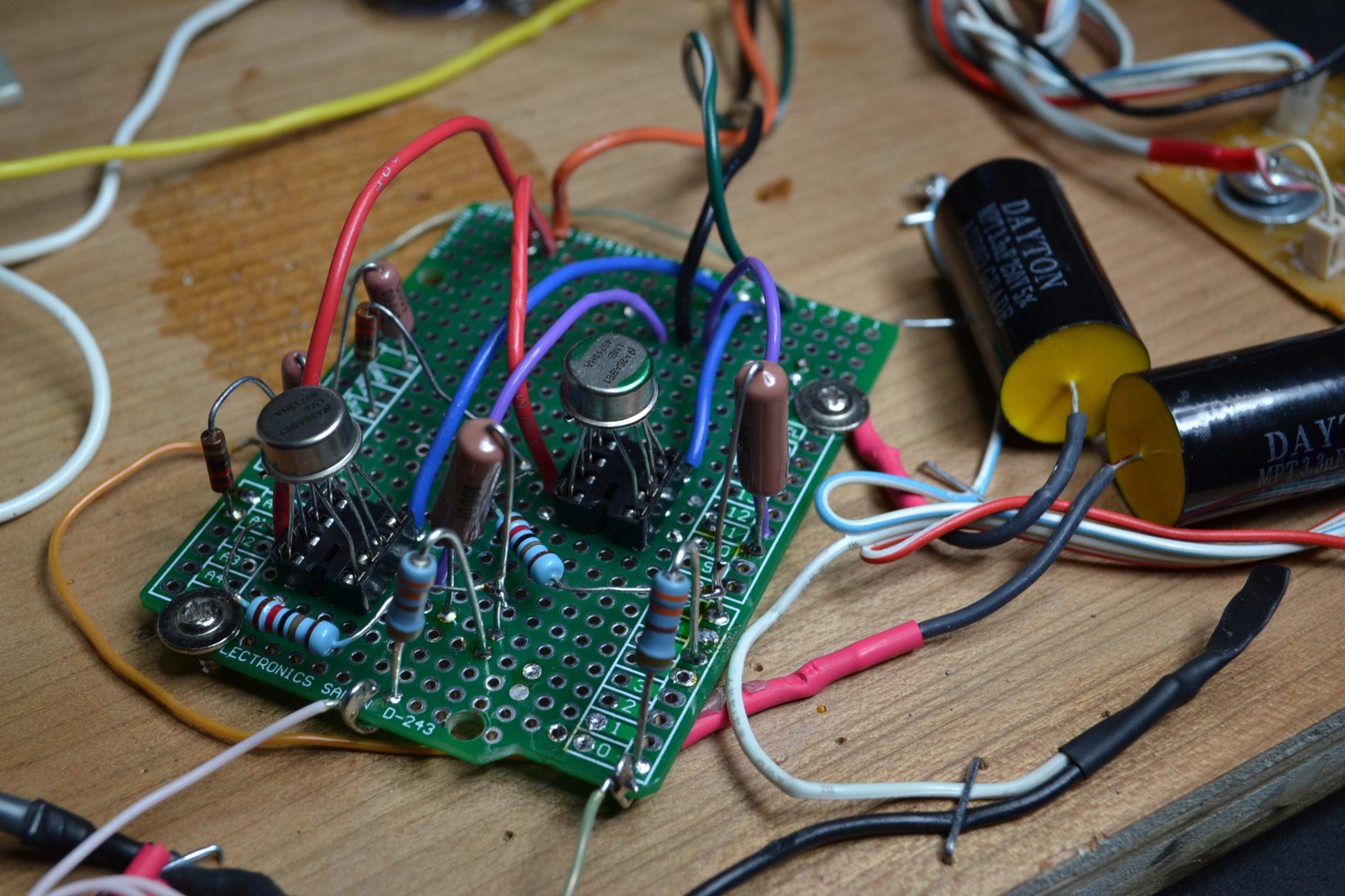

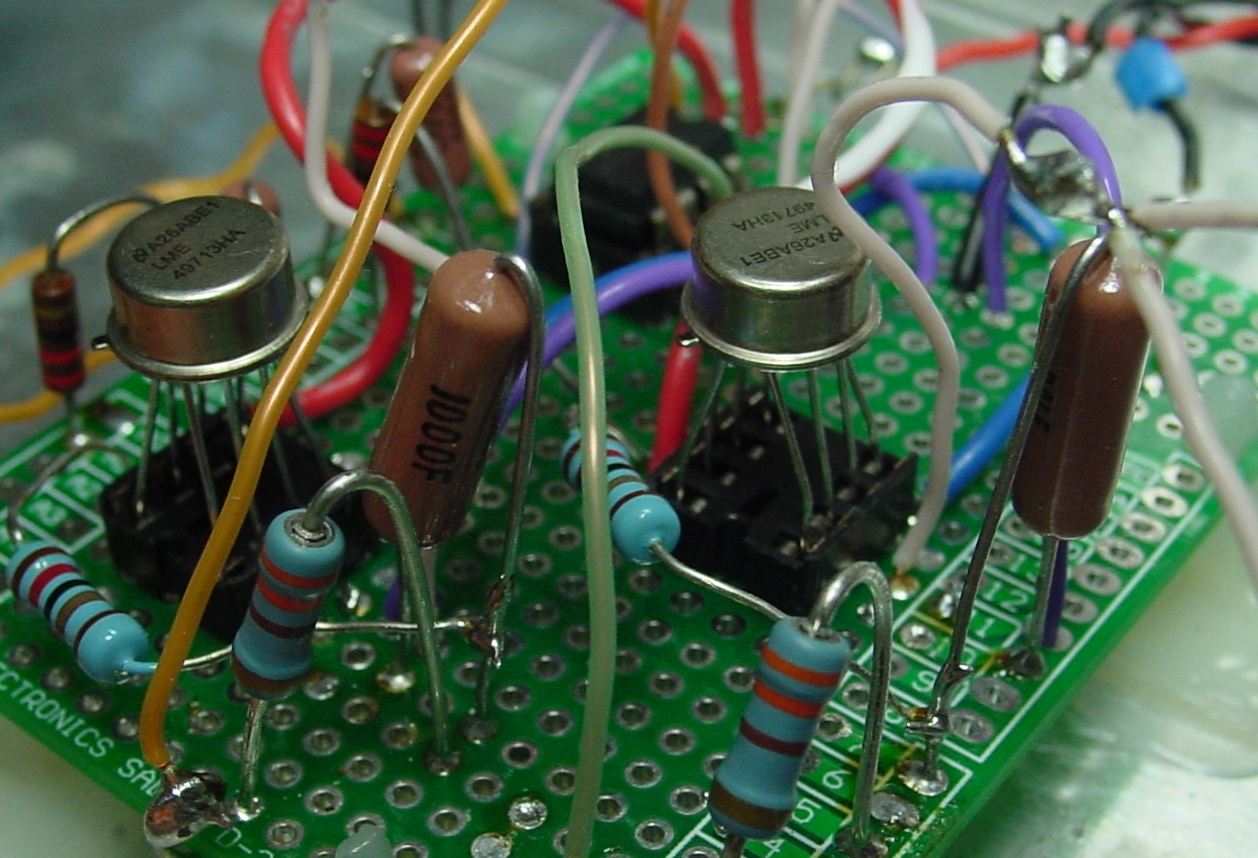

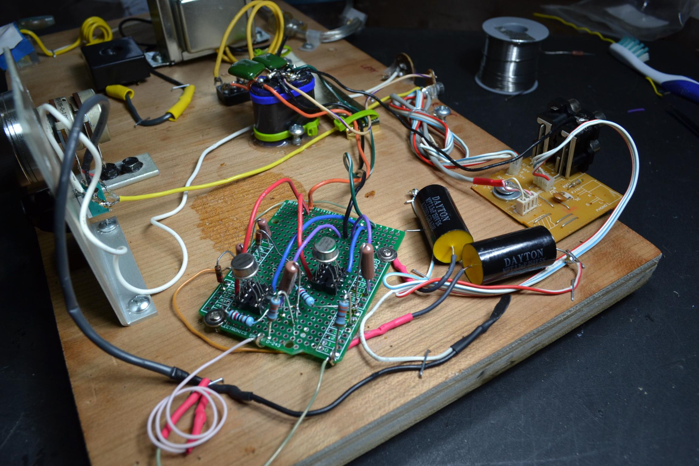

Thanks Mooly, that was some needle in the haystack information and helped me solve this problem. You are right, not much practical information on CFB op amps out there. Lots of theory though.
I matched the closest resistors I had to your schematic and got rid of the input caps that were too near the inputs and breaking one of the golden rules. Not sure even the output caps are necessary. The schematic attached show a real life working LME49713 pre. The circuit appears to work well in real life, sounded great and crystal clear--too tired to scope now.
Only mishap is one of the LME49713 blew up in trials or was deffective, it hums and is cool to the touch and not warm like the other. Swap channels and problem follows it. $12 and change each!
Only change I will make to the below schematic is to go with a 150 ohm input resistor for 8X gain and the vol pot will be 100K ohms.

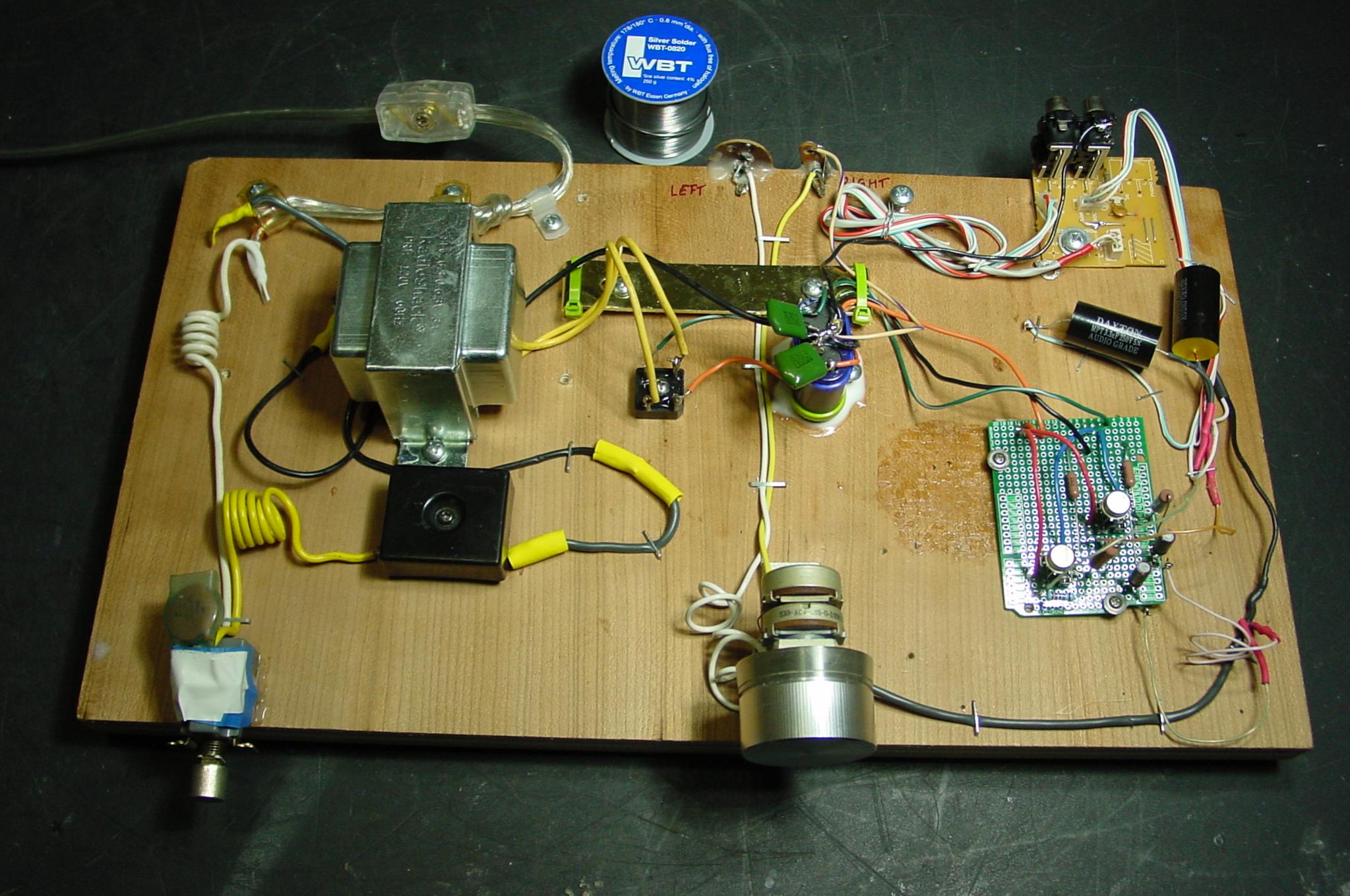

No, much appreciated. This is by no means the final pre, but the scratchpad as the piece of wood foundation witnesses. Now that I have the circuit somewhat figured out, (after Mooly shared his experience), I can proceed to fine tune. Apparently, he is one of the few that has actually tried it other than in Spice model.
All prior comments were absorved; but this is totally different animal and I am stuck on making an inverting configuration work, perhaps stubbornly.
One of the guiding principles I have is to keep Rf at around 1.2K (I think mentioned earlier), hence if I want gain, I must go low on Ri.

With some limited time and the only working channel (since I blew up one of the LME49713HA--yes, I am a hack and nowhere near an engineer obviously), I compared it to my other LME49720HA pre, and I must say it easily edged it out. So I am working towards building another chassis like the one that wraps the LME49720HA pre (attached), or just replace it altogether. I do plan to use regulated power supply for it and was aiming for 15VDC, but I think you said they will handle 18 VDC comfortably.

The input impedance of your circuit will be a couple hundred ohms with the 150 ohm input resistor. So you will need a buffer between the volume pot and this circuit unless the pot is also no more than a couple hundred ohms. Why not use a non-inverting stage instead?
thanks for the suggestion Mirlo, I think I will add an op amp buffer stage there and see how that works. I have some extra BB op amps laying around.

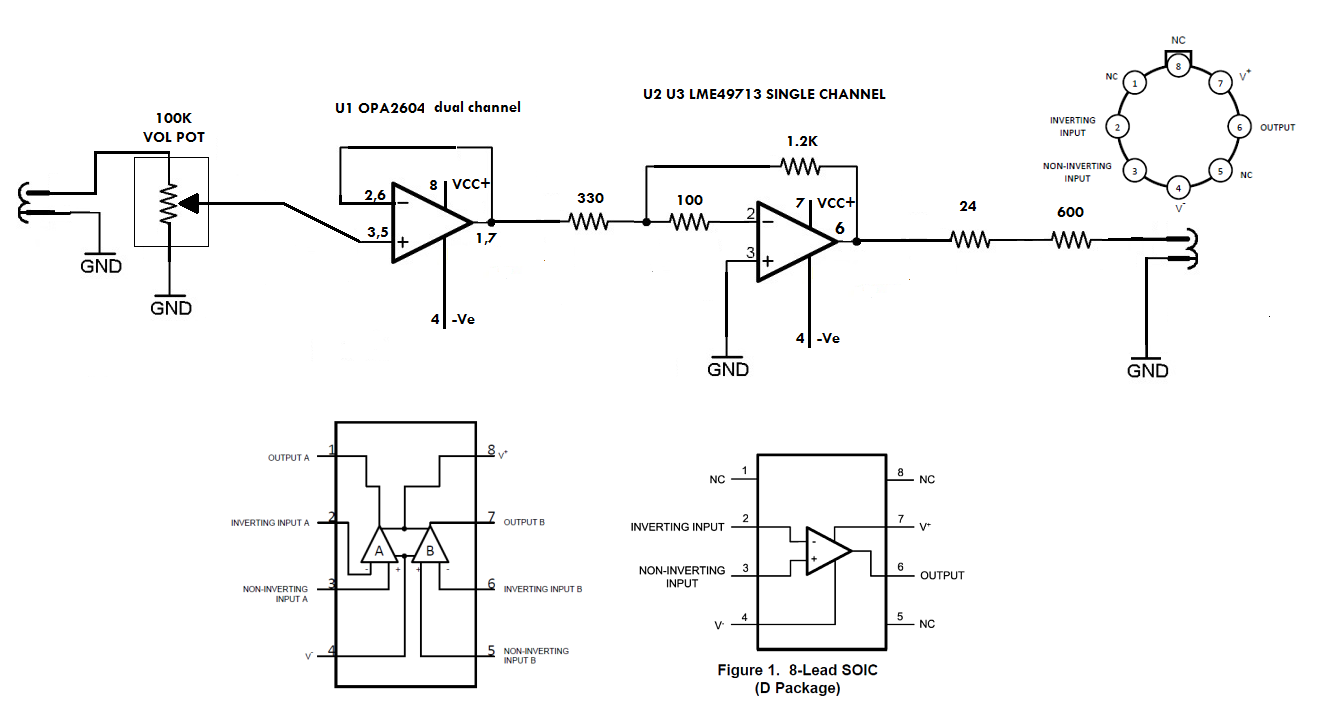

The LME49713 op amps arrived from Mouser yesterday. I quickly replaced the damaged ones and tried the circuit attached. If the volume control was say over 8 o'clock, things seem to work just fine. Turn the vol pot all the way down and pink noise appeared that seem to be getting louder and louder. Also the vol pot was very scratchy and popped with movement with no signal. The op amps were getting warm to the touch as well. I did add the buffer as suggested by Mirlo. I then replaced the 13's with some LME49710 instead and the circuit works wonderfully, no noise of any kind, op amps not even warm to the touch, and may just leave it there--unless someone has the clue. I thought about placing the vol pot at the end of the circuit and maybe try that, but blowing these op amps again is another $30 proposition. Anyhow, that is the update...
Some ideas to think about.
Reduce the bandwidth very slightly by increasing the 1k2 feedback to 1k3, or maybe 1k5
Add a 360r to the +IN to SG of the 713
What does the 24r do for the 713 output?
What is the output offset of the 604?
Does the 100r on the -IN add to the 1k2 to give an effective 1k3?1.5k to 1.2k for the feedback R is the mandatory range
