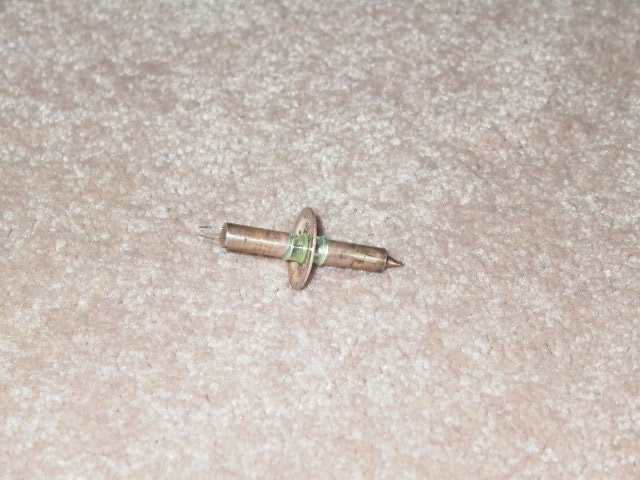

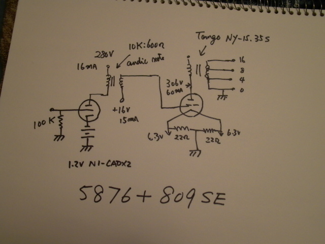

5876 is a high mu triode, price is reasonable, 20-30 $ around,NOS amplification factor 56, plate dissipation 6W so it can be one stage in gain and drive, even the power tube is in positive bias, I built one in 10 years ago, very simple circuit . it can deliver 8W (8ohm) with 1.5V in-put, if you want more sensitivity you can replace the 100K resistor with a 600 ohm 1 to 2 step up in-put transformer, than you will have 1V in-put to 8W out. this amp costs much cheaper than a 300B SE, but sound better to me

809 is a radio transmitting tube, it's power is bigger than a 300B, in audio use you can let it works in negative bias with high voltage (1000v) and small current (3ma), but do not sound good, in other way, positive bias, voltage can be much lower and have a high current(similar to 300B SE) then sound wonderful. the only condition is need a power tube or semi power tube to drive, also need a interstage transformer to match the impedance .

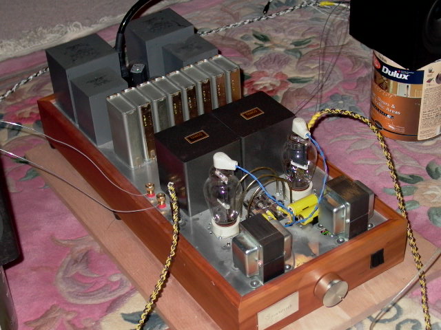

no socket for 5876, I use a big fuse holder for it, quite hot at plate, make holder's metal change color, but use for 10 years problem free,
sound quality, it can challenge any other 8 watt class SE amp in negative bias, no matter how expensive they are

for 5876 is negative bias, I use a ni-cad instead a resistor, save a by pass cap. 809 is in positive bias, about 12 ma, I use a LM 317 for voltage supply, just make sure the two currents (at the interstage transformer's pri and sec.) is in opposite direction, magnetism will cancel each other, I like triode better than others I only judge by listen and compare,curves, as long as it can work
