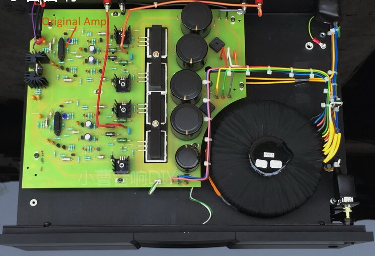

There's plenty of capability there - a fine choice if affordable. It's also quite a tall style at 75 mm but should fit in many varieties of 2U rack case. As a note also to myself, I'll have to think about the placement of the rubber "feet" to ensure the case supports the transformer reliably too. At 400VA +, it's a tad heavy for simply bolting down on unsupported sheet metal. The bottom of the case also acts as a substantial part of the the heatsink so it needs to be thick (≥3mm) aluminium which should solve the problem but may not be easy for everyone. Perhaps it means a Modushop case for European constructors, as suggested earlier......I've requested a quote for the following.....

What you can do is bolt the transformer as usual and then use a rubber pad between lid and transformer top. As heat is an issue not too much side padding. This not only saves money it might damp vibration a bit. If the bolt goes from top to bottom of the case the transformer will get very hot and will fail. It's a shorted turn. The rubber pad helps avoid that also. When the box is slightly taller than the transformer this becomes a real risk. I have done it myself and I felt very stupid.

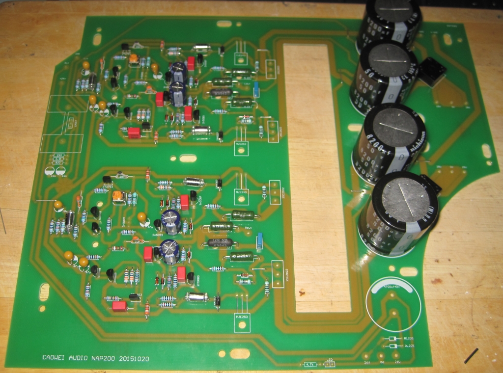

I've almost finished the PCB build, image attached, but progress will now slow down whilst I await the case and transformer. Still yet to figure out how to thermally connect the output transistors to the chassis, a few pieces of aluminium bar will probably suffice. Helpfully the kit came with mica washers for the 2SC2922s, these see to be quite difficult to obtain.
Generally all parts in the kit appear to be of good quality, the resistors have mostly measured exactly the labelled value on my particular ohmmeter.

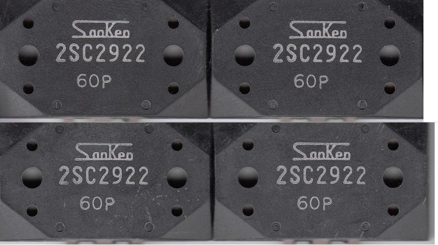

Close-ups of the supplied 2SC2922s are attached. They appear to be genuine, comparable to those included here at least.

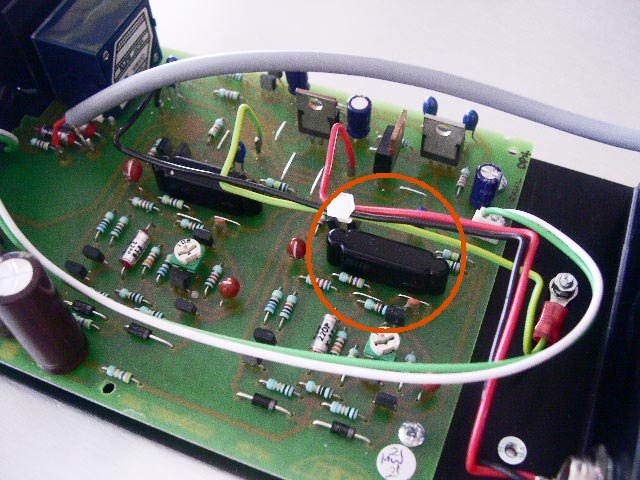

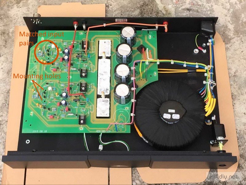

We should try to implement some kind of transistor cap to keep the input pair at stable temperature. There is mounting holes for that on the PCB. Quote from Naim forum:
''Two very significant ones are the black things that look like a blackcurrent winegum. Unique to Naim and arrived with the NAP500, and then found their way into all the amps from the NAP150 upwards. They're actually a very simple and elegant transistor housing that ensures a pair of transistors are kept as thermally close to each other as possible. This cured a common problem with closely matched transistor pairs - their matching would vary with differences in temperature with a knock on reduction in performance.''
I was considering maybe using a piece of flat heat-shrink tubing, but opened up a little and sealed above the transistors.
Something like this could be a starting point. I'm sure there are many other options though.
Not sure how effective such an item would be on these boards without matching the transistors in the same way that Naim, presumably, does. I've certainly not made any attempt to match these transistors, maybe something for future refinement.
Chris
It's no bad idea. Heat compound and tyrap works. You can expoxy join them head to head and then solder in. They show most changes with the lid off. Lid on and 10 minutes music usually makes them stable. Remember Naim force the balance out anyway. Lid on seems all they really need. If you blow cool air one side of the amp you will see offset change. Below 100 mV I doubt it matters. In fact it the offset pulls the speaker cone in speaker distortion should fall a little bit ( very small amount ). DC offset at worst does nothing. It might actually make an amp sound better as it helps the feedback circuit work. 0.1 x 0.1 x 4 = 0.04 watt. That is 100 mV into a 4 ohms speaker.
Chris
Alternatively you can bolt the output devices to the chassis bottom (assuming 3mm or more alu). However this method requires some sort of jig to solder the transistors the correct depth below the board, before the board is fitted. This way the transistor legs poke upwards through the pcb.
