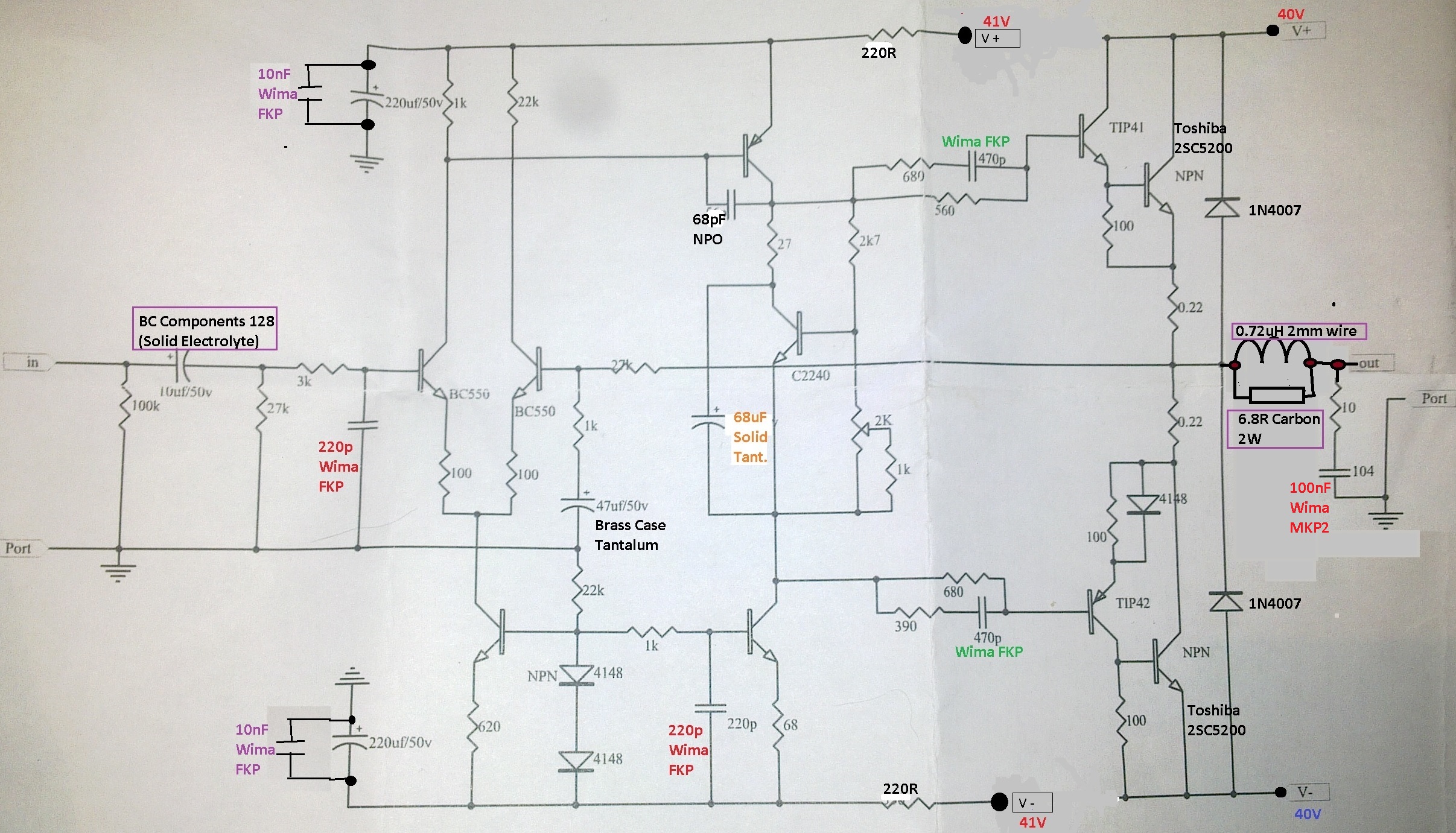

I have tried lots of modifications on the schematic except VAS and LPT stages.
1. Removed 220ohm Front-End PSU filtering resistor(Separate Regulted SUP).
2. Replaced ceramics with MKP WIMA except compensation(56pF<-- replaced with 68pF NPO for less Oscillations).
3. Output inductor is now paralleled with 6.8OHM Carbon resistor.
4. All AC coupling and feedback capacitors are now Tantalums/WET, BC Components 128 <---exact same values as in NCC200 newest schematic.

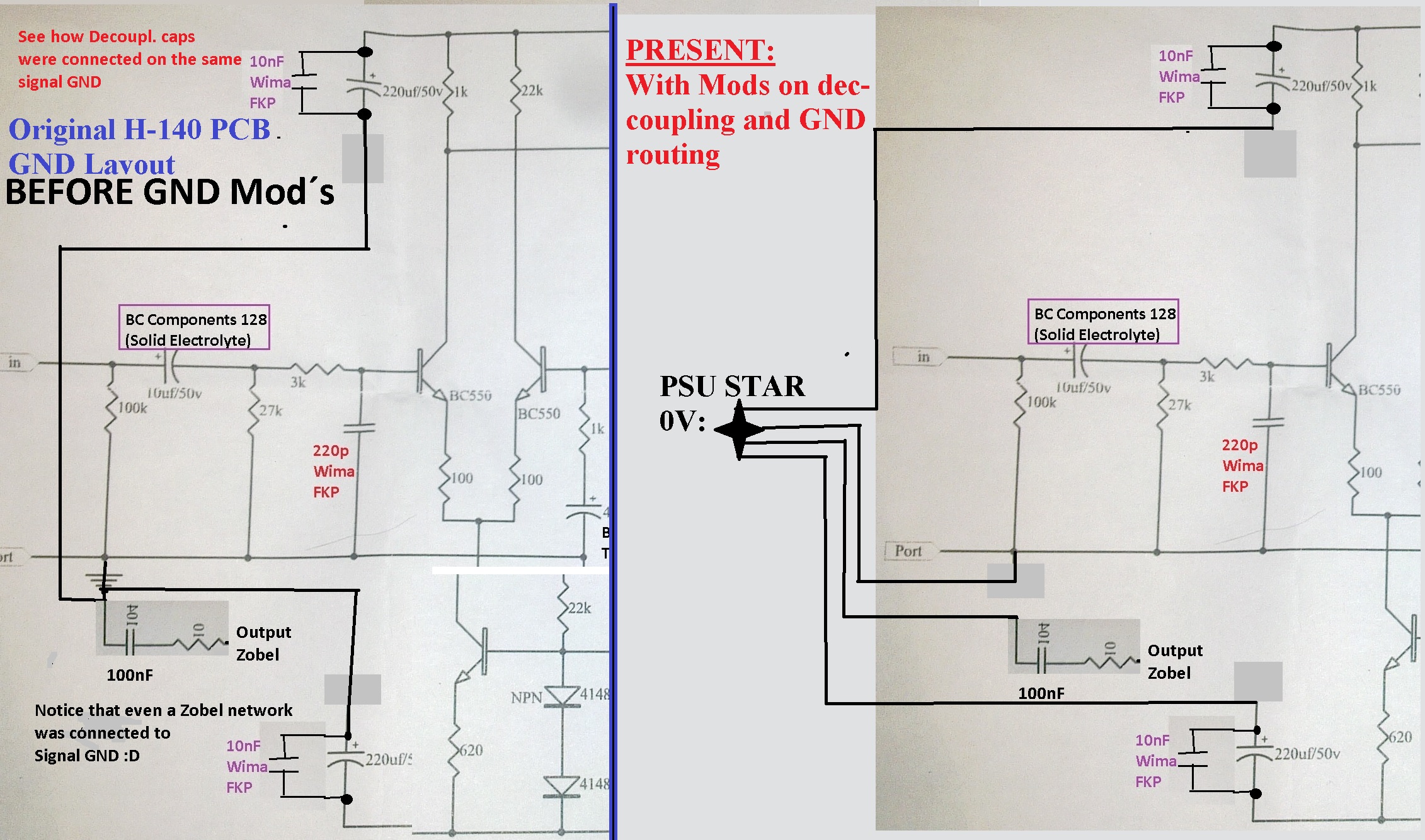

Re-done some front-end decoupling grounds.. more separate.

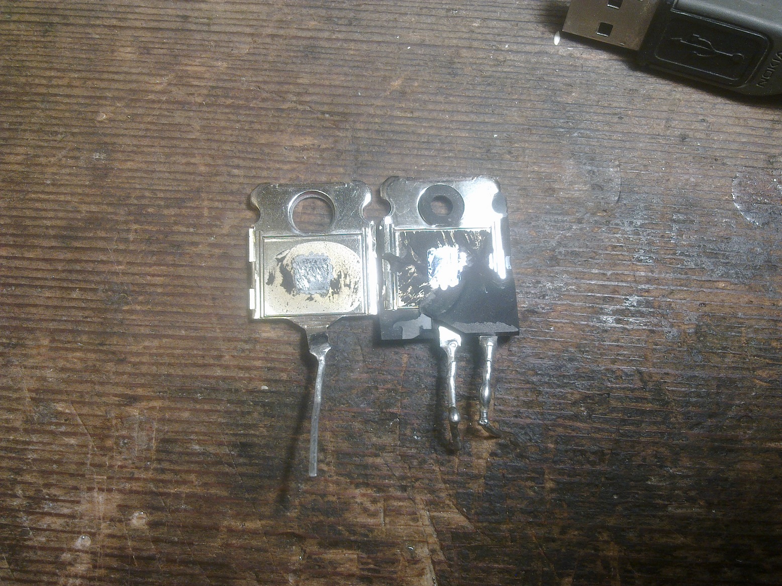

Next step: Removing output transistors that i got with the Ebay h-140 kits(2SC5200).
I had some more 2SC5200 laying around from Polish supplier.
Comparing China to Polish, both look same, crack them open and see:
China has about ~3mm Die Size, Polish had ~3.7mm Die Size, in terms of copper and everything else, they are same.
Installed now Polish 2SC5200 back to the H-140 kits.
Turn on: Turn Off, the End...
Conclusions: Output Transistors 2SC5200 are bad for these kits ?

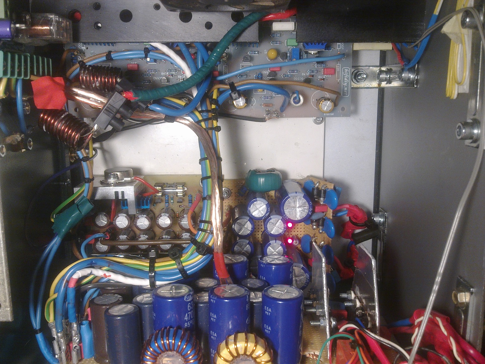

Solution might have been found.
In my opinion its a source where the AMP is connected to. It is a Computer DELL Optilex 780 rear 3.5mm analog OUT.
Before receiving OR-H70 Suomi Speakers, i changed my primary computer from laptop to that Desktop DELL and at the same night i got my hands on Suomi speakers....
Now, i get the same sound comprossion and a headache with Audio-Tehnica ATH-A900 Closed Metal Cans headphones connected DIRECTLY to that audio port
The distortion of the sound reminds me a little NE5534 driving a 40ohm headphones directly without any buffer/current output stage .
After setting UP the Laptop, connecting AMP to it, i get what i was looking for in terms of sound
Ian Finch, coils are far 5CM away from PCB-s
CSA FLEX, you mean standard AC Wire ? If so, then yes, they are ~17-18AWG.
Front End is on spot or exceeds 10mA range
I attached a schematic of the Exact PCB-s i am listening to right now.

FOR Current source BC550 and 2SC2705, for VAS 2SA1145
Wima FKP, small in size, well looking cap and relatively inexpensive.
WIMA states that FKP-s can be used in oscillator circuits, Timing, High Frequency circuits... so why not
Each H-140 Clone PCB got 14 AWG wire on GND and on OUTPUT +/- 40V. The rest wires are AC 18AWG " Front-End decoupling and Front-End +/- 41V, Output Zobel.
Thick wires have very thick insulation(BLUE ones)
Added a Pic. with mods, best explanation:
H140 amps ebay
To date having built some 24 H140 kits HT system and the ground mod works as the last post. caps input feedback etc are all evox MMK 3.3 or 44 uf off board size, changed all transistors so no fakes and used ztx753/653. Grounding is so important so do take time get it right it took me a year to get right hum etc. Both my main speakers are 4 way active with 6 amps in each 3 transformers and each amp has own bridge and cap banks. And it was no point in me saying what was good or not, as it happens my wife has a good set of ears and used her for blind testing it works. Tip make a change and live with it for a few week as things do change and sometimes get better mine did. Speaker cable are short with 8 turns and only 1.5 mtrs long and 1.5 section nothing fancy at all.
To date having built some 24 H140 kits HT system and the ground mod works caps input feedback etc are all evox MMK 3.3 or 44 uf off board size, changed all transistors so no fakes and used ztx753/653. Grounding is so important so do take time get it right it took me a year to get right hum etc. Both my main speakers are 4 way active with 6 amps in each 3 transformers and each amp has own bridge and cap banks. And it was no point in me saying what was good or not, as it happens my wife has a good set of ears and used her for blind testing it works. Tip make a change and live with it for a few week as things do change and sometimes get better mine did. Speaker cable are short with 8 turns and only 1.5 mtrs long and 1.5 section nothing fancy at all. One strange thing it’s me that turns it down now not the wife, for a simple amp it can work very well, look how long Naim to get it right, cable routes and length come into play, one of the best mods to date is using R core transformer for the supply crossover and a mean night and day stuff I will look at changing all the transformers to r core type

My H-140 boards, both have +5mV after 20mins of running. Bias ~34mA per board.
Tested the amps with high load for a few hours, heat sink gets pretty warm, but not hot... after removing the input signal the heat sink cools down in about 10 minutes.
I just got hands on Creative SB0570 Sound Blaster. It is a wonderful update from a PC intergrated soundcard
For now, re-wiring amp boards as Ian Finch suggested. Going to use twisted wires for +/-/ground to each board.

First of all, i finished yesterday my last huge modification to the H-140 boards.
I went from NCC 200 schematic to NAIM NAP-140 schematic:
1) Input resistors changed(4.7k and 22k now)
Took out BC550 CSS and replaced it with MPSA06.
Changed TIP41C and 42C drivers to MJE243 and MJE253
Now MPSA06 in placed = more collector to emitter voltage. It gave me a chance to rise FRONT-END regulated psu lines from 41V to 43.5V.
Replaced avondale VBE output transistors to original MJE15003 and MJE15004.
I get an offset now after 20min (1 board 16mv / 2nd board 12mV)
What is really good news, i got now rock solid BIAS Drift is so small and it stabilized really quick.
Thats it, there is possibility i lost the oscillations. Sound is good so far
