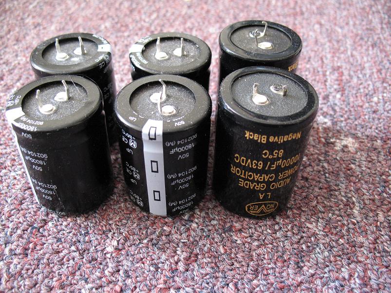

Here is my capacitors I used and I plan to use as a dual mono set up.
Andrew do you think is better to use C-R-C-R-C or just one R between the caps a la Pass F5?
I know that is a high power power supply since Class A amp.
I sow many people use only 2PC capacitor in their amplifier PS.
Even Jean Marc in his own amp, also if you look at the amplifier Nigel posted last time just 2PC capacitor only.
At the beginning (20 years a go) I did the same way but my friends told better to use min. 4 caps so I can make it CRC.
Any experience??

I did build a Cap Multi, a long time ago, to investigate how it worked. It was then that I discovered that adding a Zener+R alongside the last R of the string of RCRCRCR that you can get a two slope output voltage characteristic from the CM. The standard CM has a single slope ~ k*Vin
I never incorporated any CM into an amp nor pre-amp build.
I plan to try the Zenered CM in the F5x when I finally get it assembled.
I think a I posted an excel of the zenered CM a while back.
What an excellent suggestion . Usually it is a capacitor added to a zener as a noise filter . It sort of occurred to me something better was available form the same components , however I never got beyond thinking about it . My reluctance in using the zener is that it forces more heat out of the transistors if the voltage rises . I dare say you allowed for that ? Putting the zener on a climbing reference voltage might avoid that . It could be lets say a spare winding with 10000 uF and no great current used . That way a fixed relationship between zener and the job it is doing is maintained . The reference supply whilst of no sophistication will be nearly silent becasue no great current is flowing . It could also be CRC . No regulator as that defeats it's function .

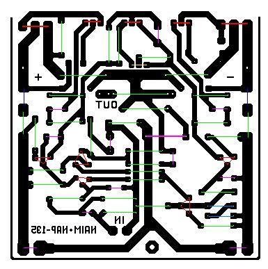

Hello
I did work on the all Hitachi mosfet amplifier layout. The Power stage and the driver stage almost done.
These way is very slow, I use the paint program to draw the layout. Need to think a lot all do I got used to it because most of my PC boards lay out was drawn like these.:eek:
To be serious I have no idea if those old JFet are replaceable with Toshiba J Fet..

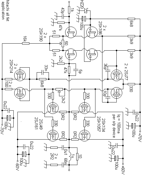

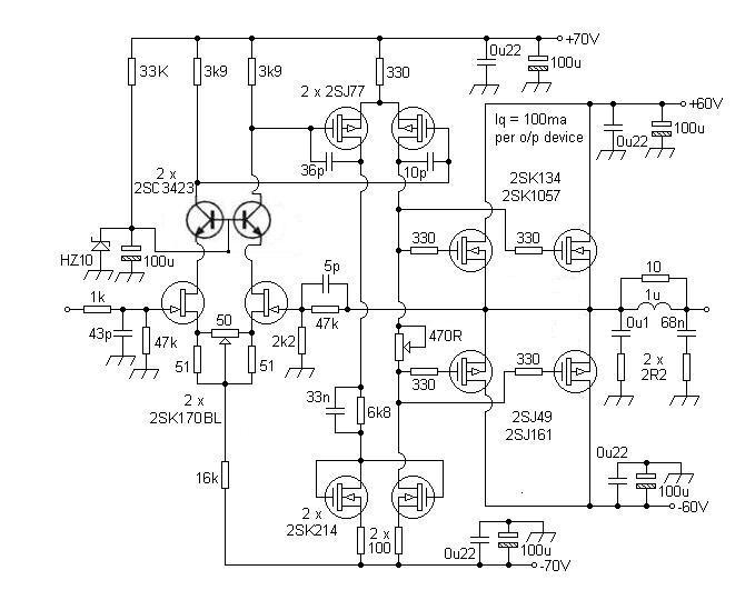

This is a doodle I did on The Hitachi design . It has 2 additions . A constant current source for the input pair ( 2 x 1N4148 , PNP transistor , 620R , 10 K ) . Provision for 2 x emitter resistors for the input pair . The lady I did it for had a friend helping her . The pictures were so as to help her discuss current mirrors etc . I retained the primitive Hitachi mirror as it works very well . Her friend changed that . If so 1 x 2SB716 is used as a diode as in more modern current mirrors . That is base to collector shorted . The PCB will do that if you prefer . To me that is a waste of a 2SB716 .
Note the equal resistance feedback arrangement from the MOSFET's , the output is taken exactly half way between them . It is good practice to do this . However because they are MOS FET's it is strictly speaking unimportant as they do not have equal output resistance . However it is still best practice to do it . At low level it will work so is worth doing . The original design didn't bother .
The top layer is just to make good use of the copper . The power wires should go direct to the TO3 transistors if possible . The cheaper TO3 P can be used ( plastic ) .
The input pair are close so as to get a good thermal match . The ground is a letter C shape . This is a bus-bar rather than Star . I take the input ground to the top of the C between 2 x 220 uF caps . I also return the Zoble circuit at that node ( my oscilloscopes says I should ) .
If a resistor is used in place of the constant current source and the emitter resistors replaced with links then the original Hitachi can be made from this PCB . Also a single VAS version as Naim if so desired . The current mirror converted into a Naim double constant current source would be easy . As said if someone gets as far as making some I would love a few . As far as I know the circuit is good to go with the PCB as shown . I suspect it is even correct size . Do check my top and bottom layers .
Hello Nigel
The attach. you posted not working (I can't enlarge the picture)
Now I have to ask you to post the schematic (how you like it or did modified) so I can see clearly. On the silk screen I see 6PC BJT.
The schematic you posted earlier I see less than 6PC.
I can make any one sided PC board, sometimes I have to some little mode if the copper traces to close to each other or to thin because I use the hot iron transfer method to transfer the ink in to the cooper. Not so good than the photo transfer. Also the red layout I'll have to rework (make it black). The size can be set up at the printer to the right size, that is not a problem.
Also it is possible to mod the lay out to the flat package power mosfet like 2SK1058/2SJ162.
I learned the best if the mosfet direct connected to the PC board. With out wires.
In case if we use wires must be hard wire and short as possible (still not as good like the mosfet soldered direct into the PC board).
The lay out I work on it is the all fet amplifier. I did go further but now I'll stop until I found out if I can get replacement for the JFets..
Did you heard the amplifier you posted in real life or just someone told you about or just run a sim?
I attach the circuit of the amp now I work on the layout just to avoid confusion.

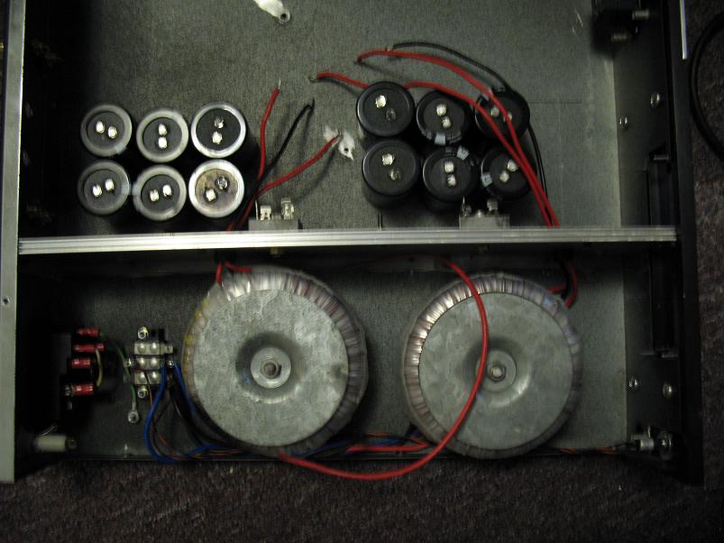

Hello
Some work done on the power supply.
I need to test the Sanken 2SC2922 device which was used originally in the Naim Chrome Bumper, of course with that need to be replaced the drivers to.
I read that was the best sounding from the Naim 140..
Also I want to test the Greg B mode..
