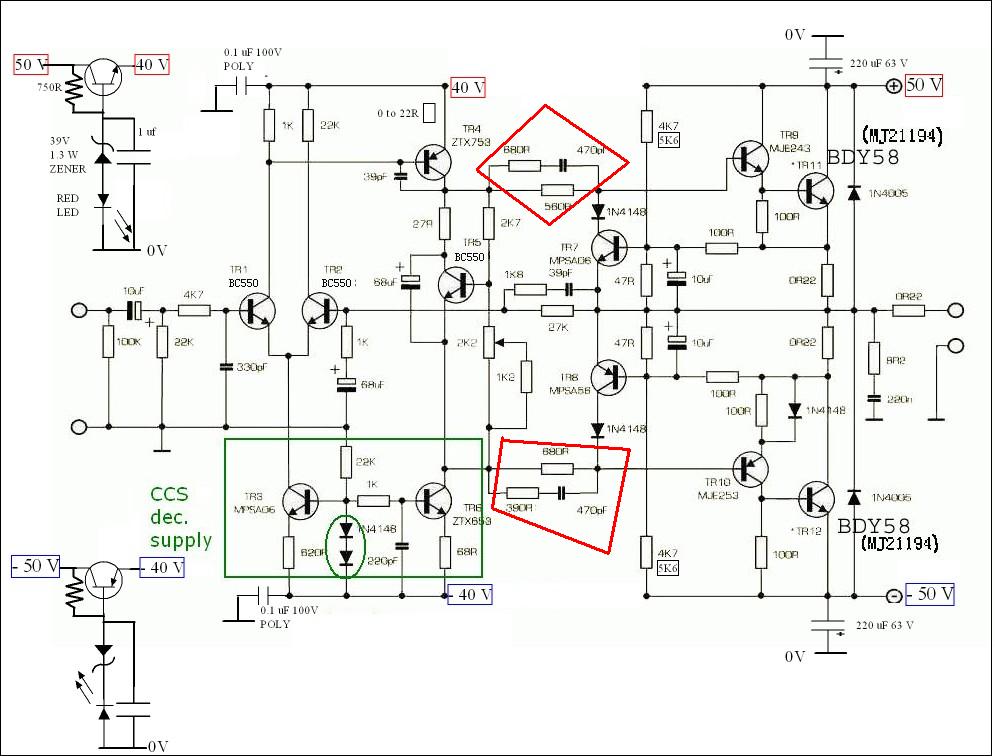

perhaps a problem of energy saving. V.A.S. (TR4-TR6) max Vp reach 40Vp
Power output Emitter follower (TR9-TR11) Gv < 1 can not exceed 40Vp but they are fed from 50Vcc
I also believe that addition of group rc has lowered slightly maximum power than original scheme.
Hi , I was just going to switch off for the day . The idea is to have any ripple in the 50 V supply well above the smooth supply . It is cheap to do .
There will be very complex ripple free PSU designs you could try . However consider how bad the usual arrangement is . Anything will be heaven by comparison . This simple idea is fast and quiet .
The amp will seem more powerful because it will maintain full 38.3 V . If you lift the zener on a red LED you can even have 40V .
Let me know if you do it and the sound .
Nigel
Hi Andrew . Ian and I were talking about how to improve this generally . Could you simulate it and see if we can keep what I've done . Personally I would remove VI limiting completely . looking at it I suspect it is OK ? Simple and cheap is what we look for . I think this idea is too good to reject . If people have a party fit 2 AF fuses in the speaker lines and keep some handy , they are not too bad and usually work . I would not without thought use extra RC filtering as talked about in the reply to my drawing as it will upset DC operating points if in the wrong places . D Self I think said 10 R max for that ( + 1000 uF ) ?
Ian and I were asking if the VI time lag operating point was realistic for modern demands ( sorry Ian if I truncate the conversation and add new thoughts , do forgive me if it was with someone else , I am not above that ) . This could be a very useful exercise .

[/IMG]
Thanks Andrew and so simple to do . I put in the 40 V LED mod as it is cheap . The resistor can be 470R as before ( 750 R if LED current unknown ) . Check maximum LED current ( usually 30 mA ) and if so 470 R is about right as it was before . The LED is a handy indicator that circuit is powered and shifts the voltage up about 1.8 V . Any red LED will do . The first unmarked caps shown at the start of voltage rail can be 0.1 uF and would be polyester 100 V types . Note Zener diodes are fitted in the opposite direction to normal diodes .

Thanks understood. I like this solution of decoupling.
I need only trim my beautiful gold plated red pcb :wiz:
next weeks I hope to begin assembling some parts.
talk to you soon :wave:

I have read your posts in this discussion. Very interesting. I was surprised by his revelation, the secrets of Naim, the 22K resistor at the collector of the input differential pair. Thank you very much.
Now I wonder: Are there other secrets in the Naim?. In the post, 98, 99,100 is argued that there is a configuration error. The connection point between the positive output transistor and the resistance of 27R is incorrectly represented in the diagram. What is your opinion?

Hi , I read your post and thought you were absolutely correct . If I send you the amplifier that possibly inspired the Naim ( Sinclair Z 30 which was a kit in 1969 ) you will see that the Naim is much better and almost modern . The Sinclair Neoteric which preceded it is a work of genius however not commercial ( it is said to be a design classic and might have inspired the Lecson ) . If you get it right I hope you will post the results .
If you use the design in Self you will have to recalculate as he gives examples for Darlingtons or CFbP ( Szikai ) . I don't remember for a Quasi complimentary design although I might be wrong ? The Naim is half Darlington and half Szikai . I would guess choose a resistor half way between his examples perhaps ? You will have to follow all of his advice if you want to benefit ( mount the Vbe multiplier transistor near the power transistor as he shows ) . I found the Sinclair stuff so here is for anyone who likes tech talk .
http://www.diyaudio.com/forums/solid-state/194744-very-first-blameless-amplifier-prior-1969-a.html
The advantage of doing it as you suggest is to make the initial switch on period better . After half an hour not much difference . To be honest Naim type amps do not draw much power and should be left to stay warm . I remember a man saying he would leave his girlfriend because she switched off his Naim amp . That will take a week to be right he said . I would say the Self circuit will account for fluctuations of power and room temperature better . If you do it please do a before and after bias check ( measure V of emitter resistors ) .I would like the before and after data for all to see if you can ( clip type test leads and over hours of use ) . Take readings when not playing music .

One thing will be to take out all of the compensation and protection and be responsible people and not party with the amps . You will be surprised how much we can take out and it will get better . I beg that you keep a clone to reference too . It is too easy to say a thing is better just because it's your own design . R/C question . I will answer that tomorrow if can . My next work project has turned up so I must get on with that .
R+C//R
There are plenty of text books that deal with the R+C//R compensation . Most require high level maths . I speculate that this was to get an amp without an output choke to drive Quad ELS 57 the reference speaker of Naim Audio 1971 . The Quad is a complex load . If anyone can find a Spice model for the Quads it might be fun to verify this . The striking thing is the R+C//R is not symmetrical ( nor is the output stage ) . This all looks like the work of a genius . Leave well alone I would say if asking . At the pub my friend suggested that these would have been set with a dummy load and square waves at ( 7 kHz I thought ) . In the Self type amp this would be a 100 R resistor .
