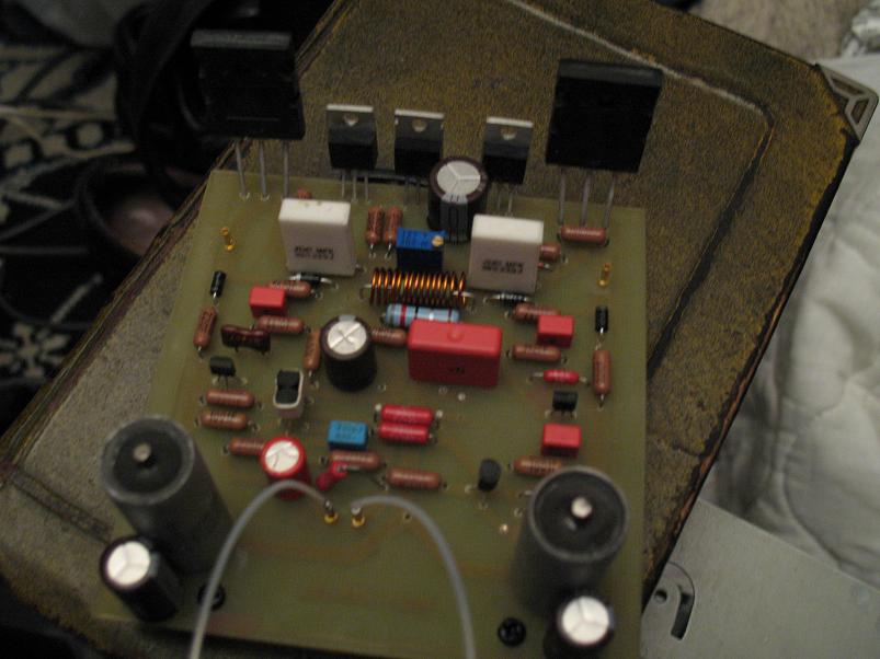

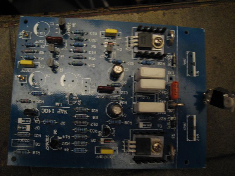

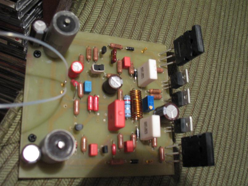

Brainf
My advise to you for VAS 2SC970 /2SD2240 will be not the best choice .
Please use ZTX or like my blue board 2SB647 /2SD667 . Just pay attention because different pin out . The 2SB has thicker sound but not as clear as the ZTX .
My advise to you forget the silk screen on the board .
Take the schematic and build the amplifier after the schematics . I know it take a lot of time but in that case you will be sure all pars is in the right location .
I had problem with my blue board to .After I hock up it had no sound at all and I have very large offset .
I spent hours until I found out the Input ground was not connected to the main ground on the PC board also you can see the LTP transistors are reversed . To many mistake if you go after the silk screen .
I post my old blue PC board and the new home made PC board which use the NCC200 schematics .
Greets
