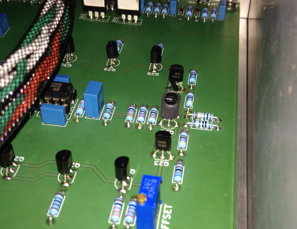

The work begins...
Soldering all the "easy and low" pieces.
Resistors, diodes..
The the trimmer, the BC550Cs (the first with the highest HFE)
and so on.......
Sad to say, the 100ohm resistors in series with the two BC550C emitters are not present in the pcb layout.
To fix this the straightest way that comes in my mind is this:
Softly bend the emitter pin, and fit the 100ohm resistor.
This work has to be done for both the first 2 BC550C.
The one shown in pic is the first the signal path encounters, therefore the one with the highest HFE. (15%+ roughly).
I know, i know.... how horrible is....
Then:
all the original ZTXs transistors, those provided with the kit and marked upon the pcbs all have the collector and the base swapped against the new components.
the 2sa1145, 2sc2240 and 2sc2705 all have to be soldered with the pin 2 and 3 swapped. BASE and COLLECTOR has to be swapped.
Mounting it with pins bended like this is not so hard, but it exposes the component to some risks. Hitting the component could cause pins to touch togheter and...... "saludos......"
So, BE SURE pins are not touching (of course..), maybe some isolation is required. I will see later.....

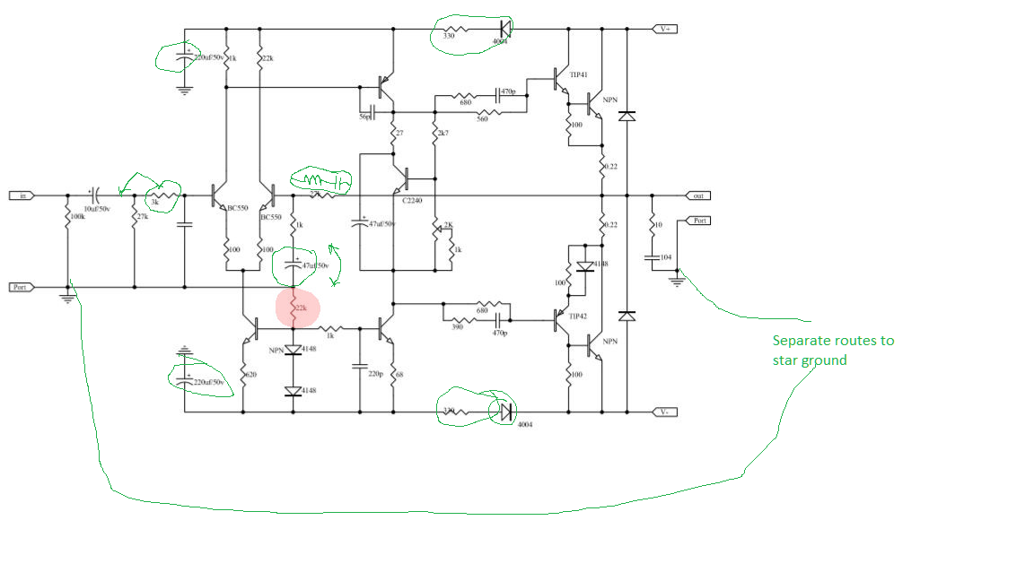

I'm always interested in the design choices people make.
The things I've highlighted in green are a little different from Naim.
There is always a healthy desire to improve the original and why not try? Especially since the original's transistor selection criteria are not published, there may be a "system" effect where if you have not correctly selected transistors then, say, regulating the front end might make it sound better.
The Naim design requires some careful selection of parts so without this selection, it is worth trying circuit modifications to hear what happens. But best not to lose sight of this and wrongly assume Naim made amateur design mistakes. I think they only make professional design mistakes.
But I guess you know that the schematic you have posted does only have some details common with the original Naim amplifier schematic. Then why did you post it?
Example:
Regarding the insertion of psu regulation (D+R+C) on the front end.
It's worth trialing this in a way that you can judge the effect using your own ears on your own system.
The popular logic for this mod is probably that voltage regulation is always a good thing, especially so on the front end which is more sensitive to it.
And yet, Naim did not implement this on its NAP140 design. It could have done, easily. It had many, many years to discover its merits. So why didn't it?
The trouble is, if you don't have a good explanation for this, you are sort of saying you know better than they do.
That's not to say it won't be better on a particular Naim clone in a particular system. Maybe. But it definitely won't sound better in a real Naim system.
As a matter of interest, regulating the front end of Naim clones has been tried before without success (probably many times by others with similar thoughts, though not posted here). Don't ask me to remember where in this thread it was. Doing this seems like a popular response to seeing similar, simple topology amplifier designs, wanting to improve them and this is certainly one well known, low cost way to way to reduce noise and distortion.
The problem with doing this is one of throwing out the baby with the bathwater. You wind up up with a better performing but bland sounding generic amplifier with almost no PR&T effect. May I suggest that you could have built something else, like a full blameless design, without attention to special semi types and construction techniques if that's all you wanted. In other words, don't bother with Naim clones as the basis for a more ambitious amplifier with only better technical performance as your aim. Regulate the main power supply if you must do something about noise but don't separate the front end supply if you want something that has Naim sound qualities.
One reason given for this is that by isolating the front end, you also sever that weak signal path that exists between the stages and contributes to the characteristic sound quality of the type. In the absence of measured evidence to the contrary, I'll continue to accept it as valid here.
The kink in the reasoning here is the premiss: “Isolates the front end”. That premiss forces the conclusion that a broken signal path is the culprit.One reason given for this is that by isolating the front end, you also sever that weak signal path that exists between the stages and contributes to the characteristic sound quality of the type. In the absence of measured evidence to the contrary, I'll continue to accept it as valid here.
Perhaps some clarification is needed. Since the power rails are considered to be the secondary signal path, placing a regulator inline or adding a separate regulated supply there would surely break or severely attenuate audio signals on it. In that sense, you could say it was an unbroken signal path that was the culprit.
Bigun has experience with this idea and chimed in previously in regard to AKSA's designs and Naim clones generally. Perhaps he has more to say following on from TGM10, his own Naimish DIY contribution.
