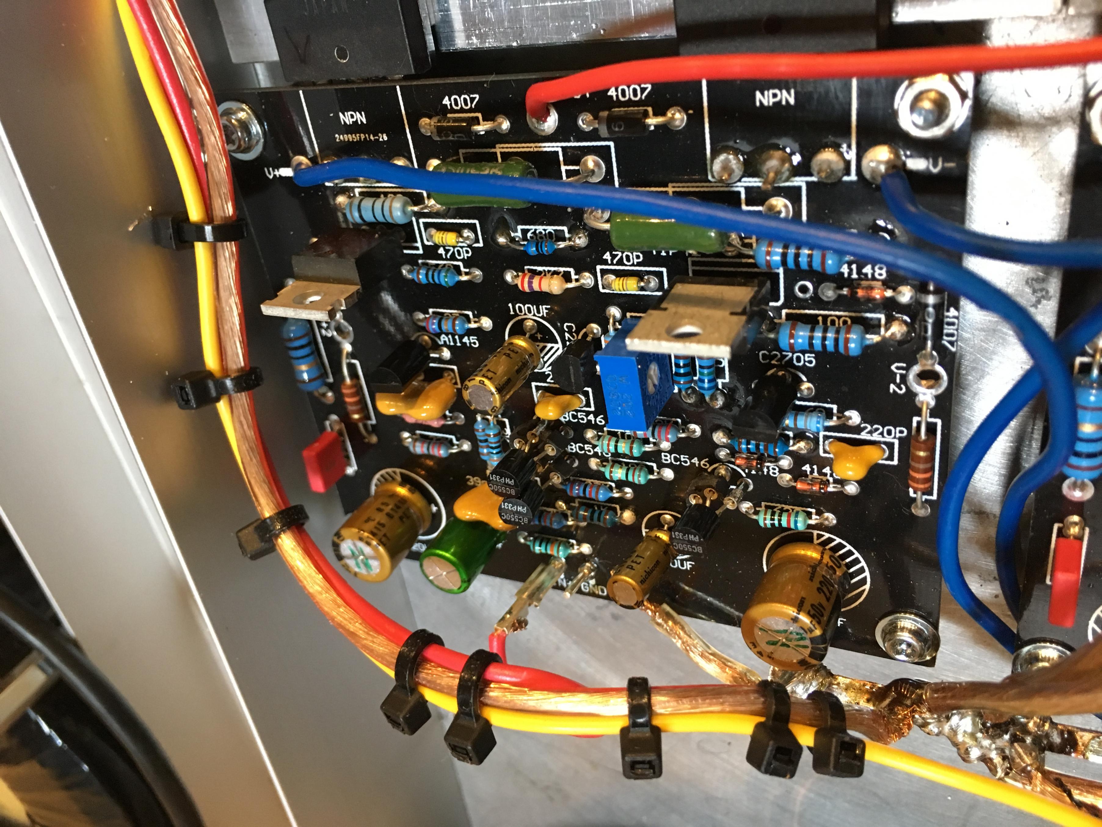

Hi guys,
2SC2705 and A1145 did not come in time from ebay due to problems in china post office :S
This time i ordered them trought turkey post office... NCC200 is physically finished but,
does NOT work without VAS transistors ...

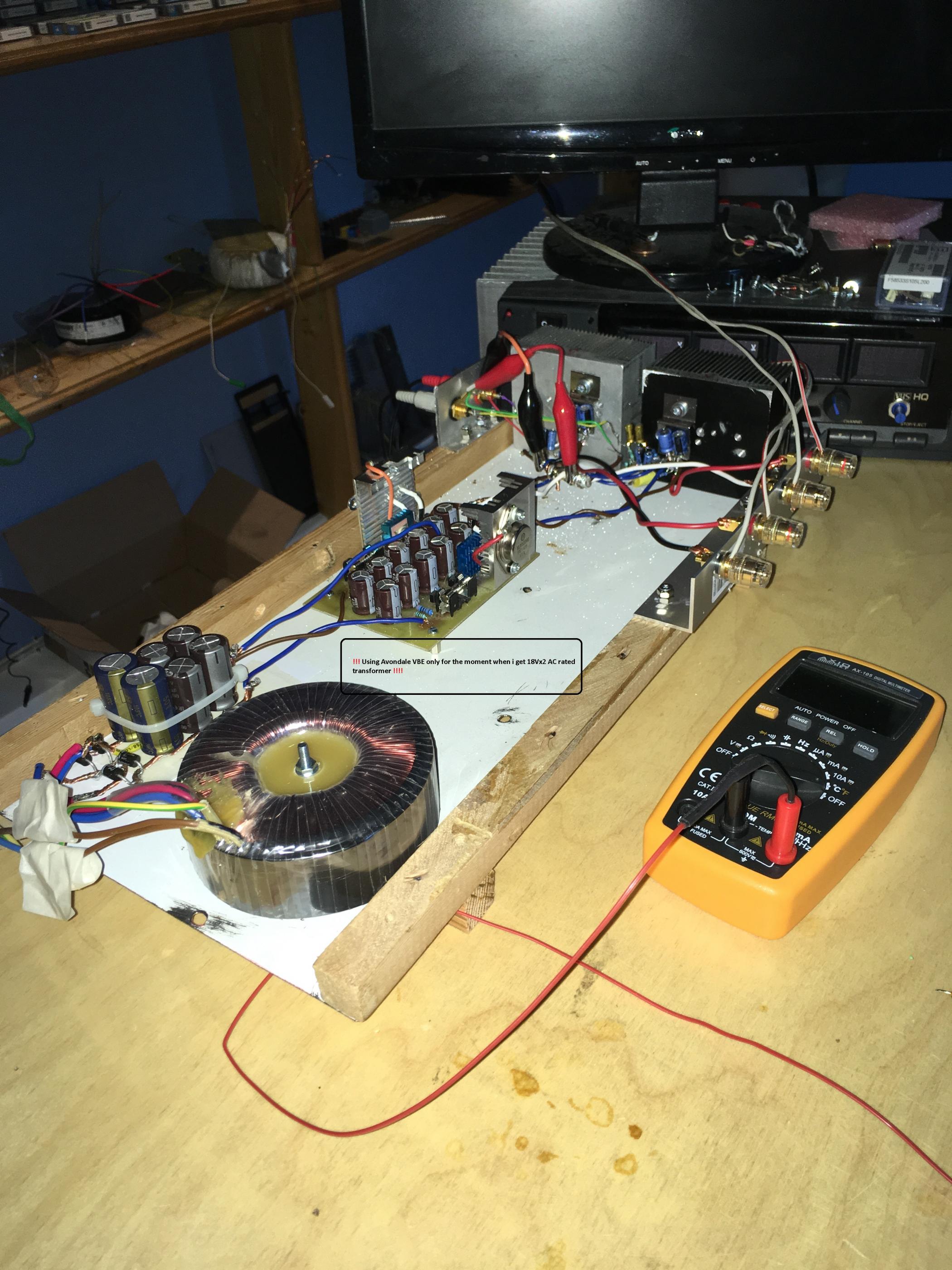

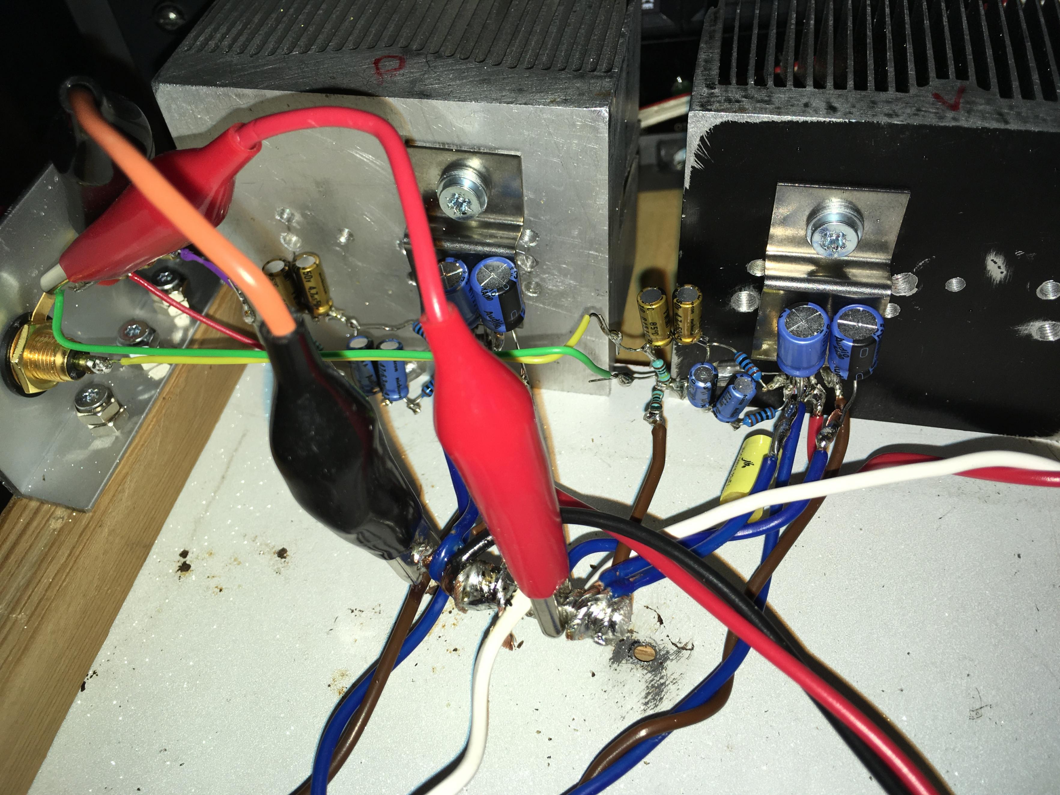

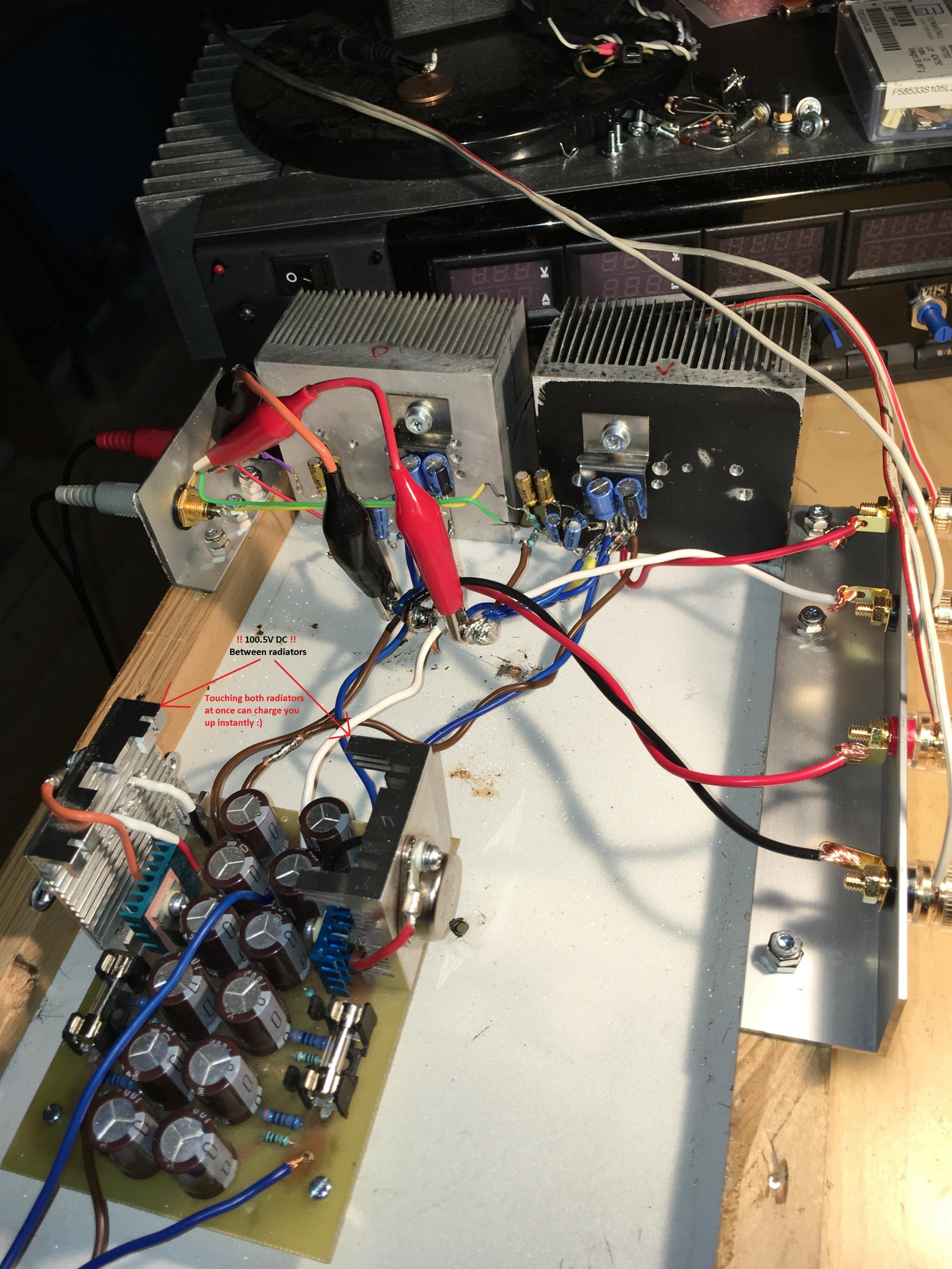

in Mean-time i build a dirty LM1875T, a pair into this awsome case Chips came new and as a gift.
I followed SC 20W LM1875 schematic, REMOVED 10R resistor from circuit to ground on both channels..
This 10R resistors ruin the sound when LM1875 being listened as STEREO from 1 PSU.
Avondale VBE in action, dropping to +/-25V from +/- 51V Regulatior radiators are hot and dangerous to touch... its MJ15003/15004 series... unkillable, especially with 20W amps on the output.
LM1875 is better in stereo, easier to the ear when compared to a naim clone. In overall.. hassle free ready to enjoy in 10-20m3 rooms.

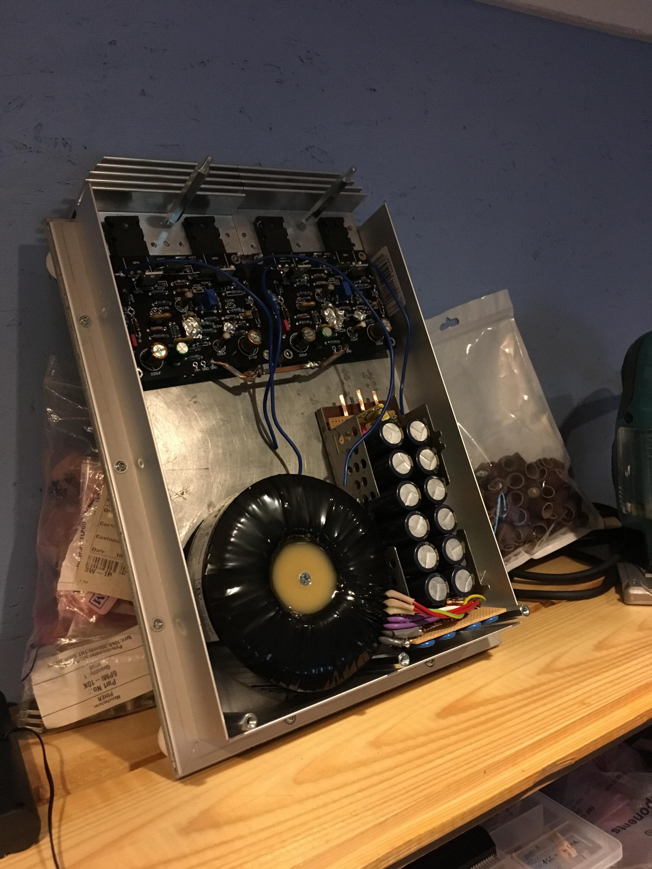

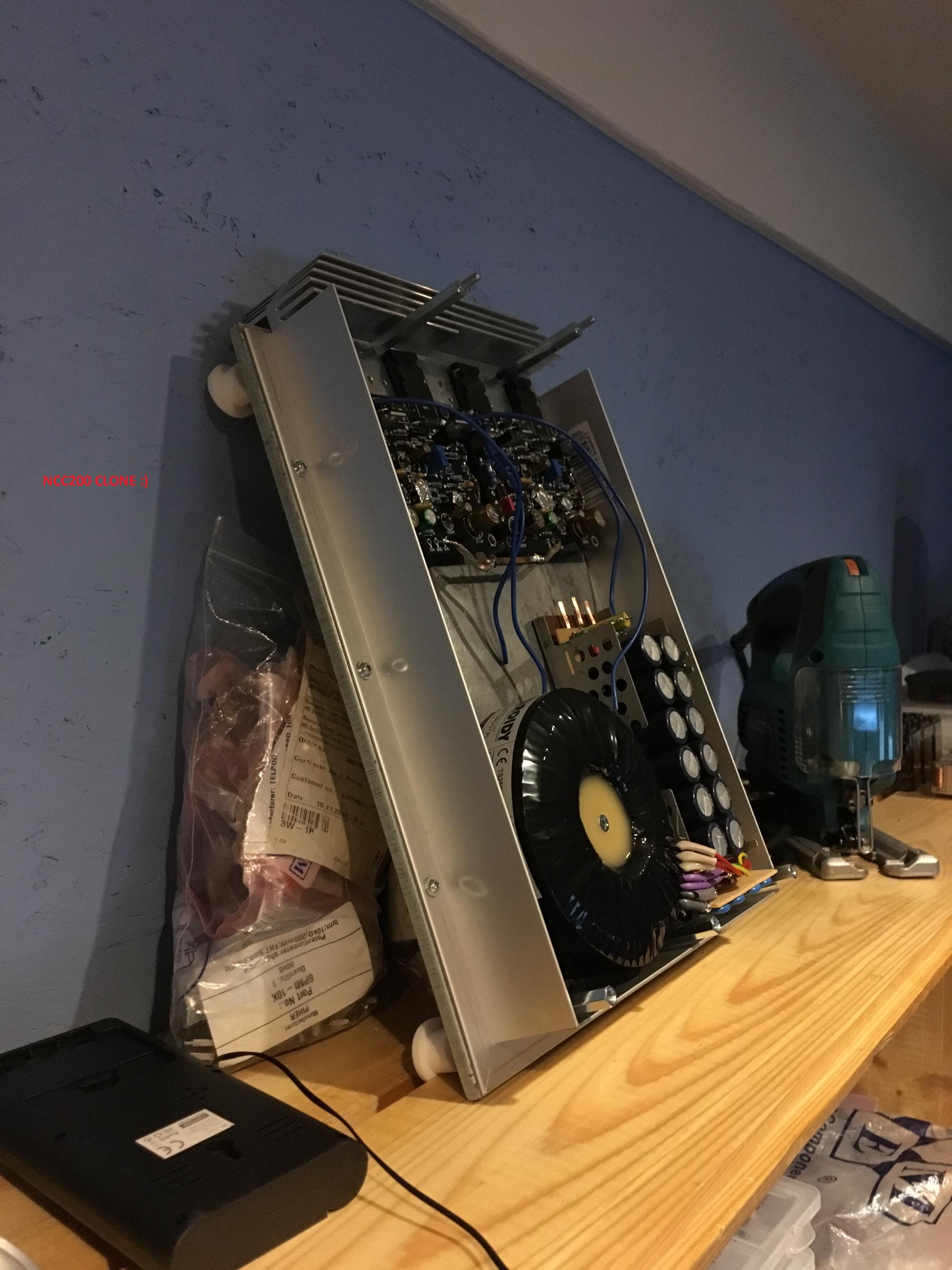

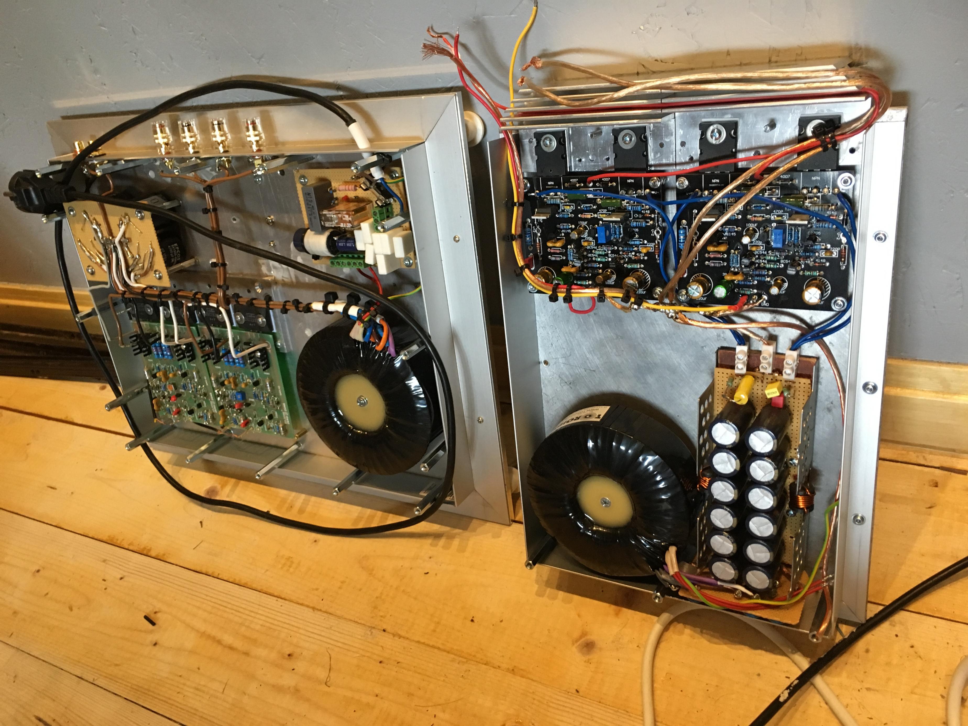

NAP 140 Clone on the left +/- 34.9V DC
H-140 Clone(NCC200) on the right +/- 37.8V DC
Both sound differenent.
In short:
NAP 140 very big sound, very rhythmic
H-140 clone dry, clear sound
I still prefer LM1875 @ home usage any time over everything Very good with all kind of speakers.
Will do few major mods to NAP 140 clones:
1. Replace aluminum case for wood and steel combination, result smaller heatsinks = a bit warmer outputs.
2. Replace all resistors with vishay MBB series 0.11€ cent per unit.
In short:

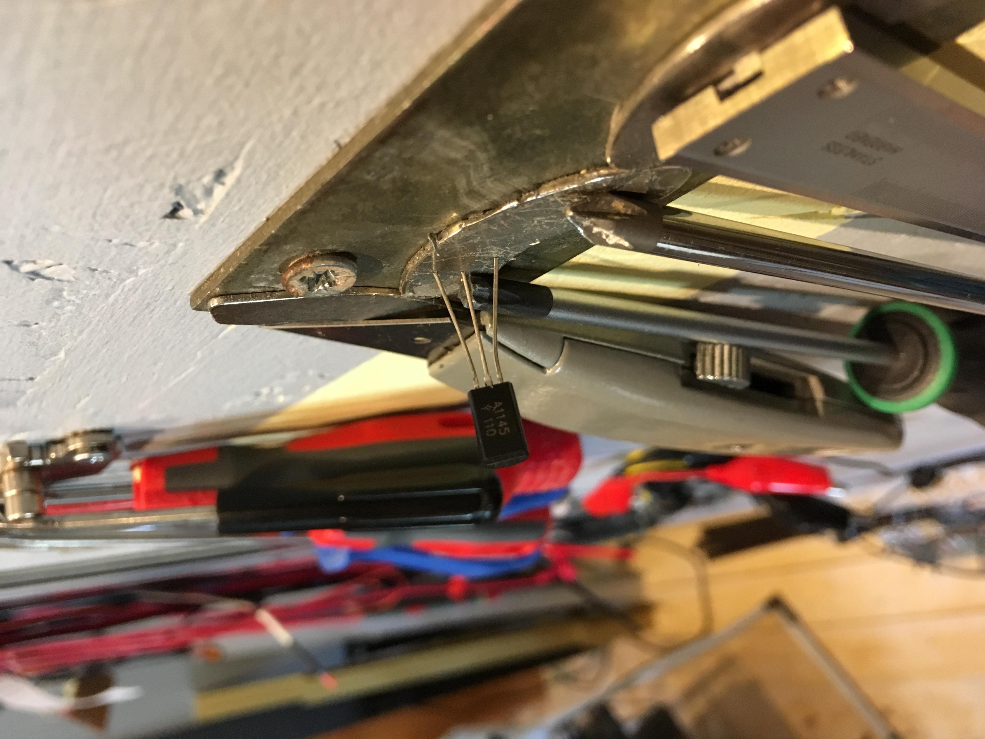

H-140 is more natural then NCC200 also... its just 330+220uF cap and 2SA1145 combination sounds better to me.
IMO chinese ppl did a good job with a H-140.
NAP140 original clone is a different beast... its big sound.
