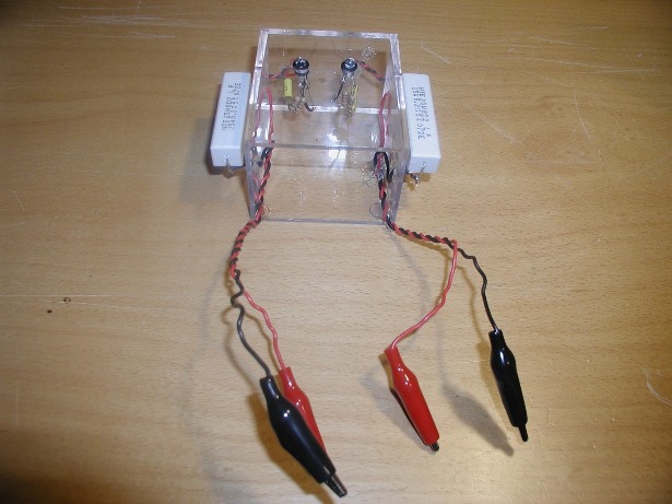

How do you determine if there is an oscillation?
from Unclejed613
"you might want to try a "quick and dirty" oscillation detector using an LED. you want to take an LED, put a 100 ohm resistor in series with it, then put a 4.7nf cap in series with the 100 ohm resistor. the "unused" leg of the LED becomes ground (polarity of the LED doesn't matter). the open leg of the cap becomes the input. then put a 1k resistor from the junction of the cap and series resistor to ground. the circuit is connected across the speaker terminals. any oscillation above 1 volt and above 20khz should light the LED, especially if the oscillation is continuous."
I built one and it works great for me. Attached is a pic. I check DC offset and for oscillation before ever attaching a pair of speakers to an amp..
The white resistors on the outside are the 4 ohm or 8 ohm dummy speaker loads. This way I don't have to attach the speaker terminals to the amp being tested...
Don't know if it would detect any and all oscillations...

Thats a very good idea by unclejed, simple and I think it would work pretty well. Actually its awesome for diyers that dont have resources for scopes.
Ruwe, good input, now many builders here can sort out a problem I think most of them have. This is a quite a good sounding amp when its operating properly. Strange why nobody mentioned the oscilating problems without the use of some peculiar cables before, Julian Vereker certainly had a peculiar way of doing things.
Its better to test with a speaker load, or rather with a dummy load at first but with some capacitance. A purely resistive load is not of much use and does not represent a accurate speaker load.
Yes, interesting small indicator circuit. Can be helpful if the oscillation is constant and not just a very short spike.
I totally agree with Homemodder, that pure resistance is not a realistic load and will not cause oscillations if we assume that the amp circuit is properly designed. I think that this amp is generally simple to build and to make work, but it's part of the whole Naim system, and it needs the right front and end to make it perform at its best.

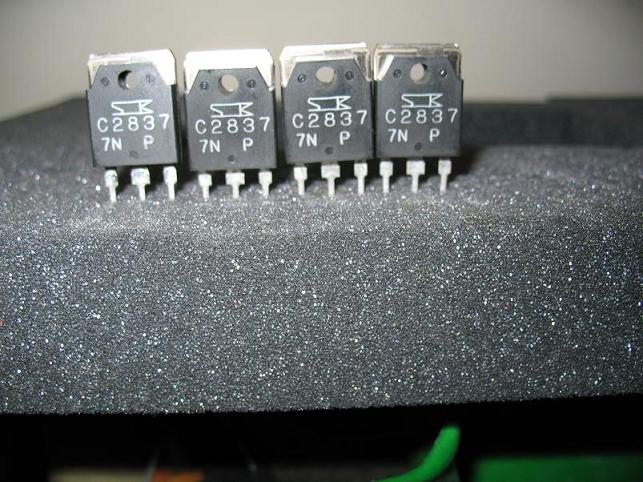

Hello
I have pair extra Naim 140 Clone PC board for sale with 4PC matched (original) Sanken 2SC2837 power transistors .
I will include the part list and the schematic of course .
I ask for these $35 .
These is a brand new professional made PC boards . The 4 Sanken cost at least half of the asked price and if you want to get matched transistors you have to purchase 15-20PC .That would cost you more than how much I ask for these set.
I know on the Ebay available as a kit but half of that kit you have to replaced .Better resistors min.Dale , the Toshiba power transistors are probably .... you can read at the ESP site .Even someone wrote on the forum he needed to replace the Elna Silmic ll capacitors because the sound was lifeless .
What I want to say if you build up the Kit U use what ever you think is the best !
Greetings
