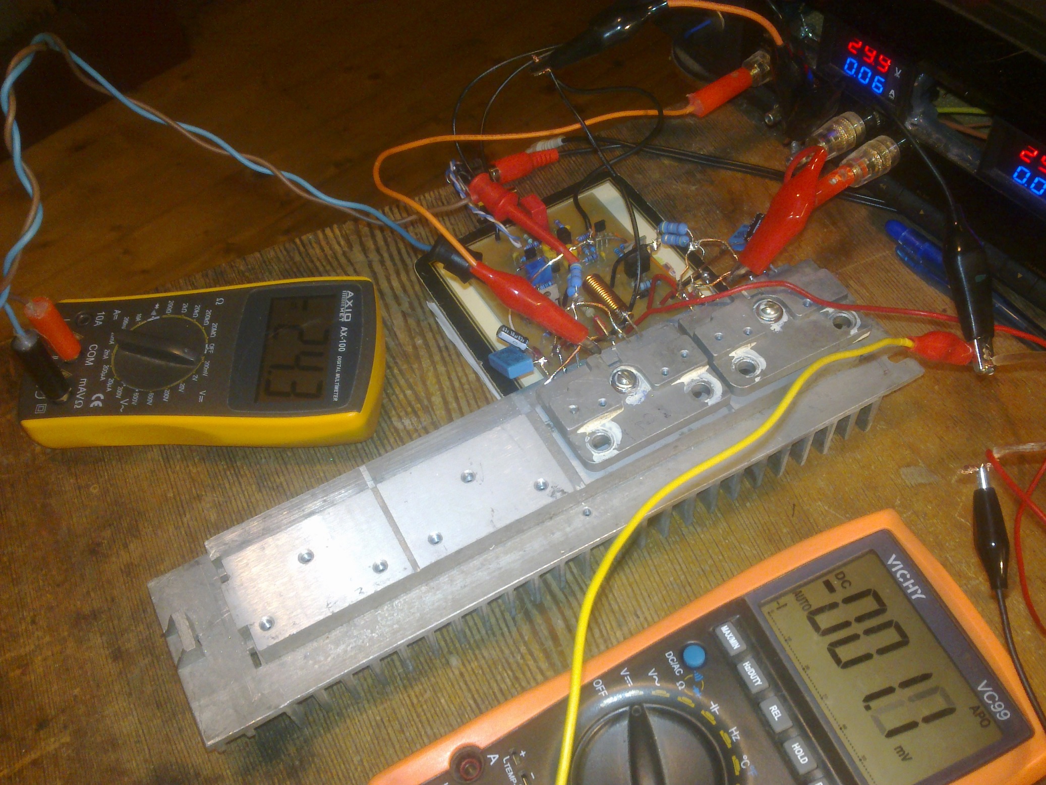

Few problems occured with BIAS 2N5551 transistor on naim. First, i can't set the bias below 1mV(emitter resistor) when the pot is turned all the way down.
Second, whole 1 channel amplifier board takes 19.98mA when 1mV is present on emitter resistor. It means output is taking 4.25mA and 15.73mA is going into VAS and LPT ????
EDIT: And one more case, when speaker is connected to amp output, voltage on emitter resistor rise from 5.2mV to 5.5mV, no matter what bias is set, voltage always rises by 0.3mV and stay's stable.
Laboratory +/- 30V supply.
EDIT2: on normal listening, the voltage drop on emitter resistor is set always to 5.5V, i meant 5.5mV, sorry

The voltage across the emitter resistors of TR3 and TR6 can be used to calculate the current in the input and voltage amplifier stages. Have a look at those values first, since I think the currents should not be more than 1.5 mA through TR3 and maybe 10 mA through TR6 but your parts and supply voltages have changed and you are off the clone path so it's difficult to know what you have there now and what to expect as the outcome. Perhaps you should simulate your changes first to check for correlation with actual measurements. Otherwise, you'll be lost in incorrect operation, such as a bias currents running too high. Post the relevant schematic, parts values and relevant voltages if you can.

I apologize, should have calculated current on both resistors.
19.98mA - 2x 4.25mA = 11.48mA, more realistic.

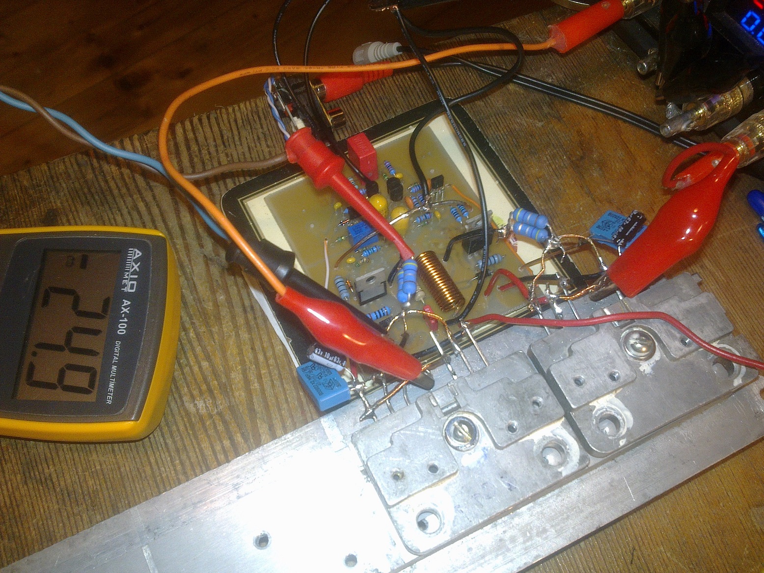

Removed completely VI limiter from NAP250 circuit.
Then, installed ZTX753 VAS and ZTX653. MPSA06 in CSS and LPT is formed with BC182B transfer resistors. TIP41C series as drivers and TOSHIBA 2x 2SC5200 @ output.
None of the resistor or capacitor value is changed or added except MPSA06 emitter resistor which is 560R atm and 2SC5200 47nF+10uF decoupling capacitors. Offset is ~1.1mV
When ZTX series took place, magic happened(changed 56pF to 39pF), everything @music became so interesting. Never heard a mono speaker playing so nicely .
Amp is bright, very very tight and lots of details, i don't have words to describe this situation. NAP circuit should become more juicy, more mid and less bright with MJE253 as drivers. Will do it when H-140 are taken out from the AMP case
Technically, it became much more stable then it was(H-140 clone, with mods or not, doesn't really matter). Nasty tones like in 1K-3Khz range are much much softer to ear. I just don't have headache's by listening to mono.
Lets hope that stereo with 1 transformer center-tap winding will be as good as it is right now .

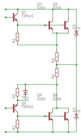

Didn't want to ruin the party by adding VI limiter back into NAP circuit. So, i have decided to add more output transistors in parallel. Is it possible while keeping naim concept ?
Right now, toshibas are paralleled without emitter resistors for current matching. I have tried lots of different techniques (with emitter/collector resistors) but sound is immediately worse, boring or god knows what else.
This is the configuration i stopped on, gives best results compared to previous parallel configurations:

Paralleled output transistors without emitter resistors is a dangerous game to play.
Andrew, do you have some advice to parallel output transistors, is it possible to do it right with naim circuit ?
If VI limiter is installed back into the NAP circuit, it would be useless and un-configured for Toshiba 2SC5200 and you guys know how to tweak it ?
Another idea is to get TO3(naim like) 250W rated BUV transistors, but then how it will sound, cost per unit will be skyrocketing and Ian Finch wrote that slow is a No GO.
Every output-transistor ought to have it's own emitter resistor.Andrew, do you have some advice to parallel output transistors, is it possible to do it right with naim circuit ?

with care, skill and low voltage one can get good performance in a single pair output stage without using an external emitter resistor.Every output-transistor ought to have it's own emitter resistor.
The stability, both thermal and electical, comes from the internal emitter resistance.
But with paralleled output devices one must use individual emitter resistors and preferably select near equivalent devices.
Andrew, I was referring to the intention to parrallel the output transistors, in which case emitter resistors are a must.with care, skill and low voltage one can get good performance in a single pair output stage without using an external emitter resistor.
I suspect 0R1x6 for 4 devices not bad. That is add one to each emitter and retain a common one as in the drawing. The circuit as wrongly drawn might work up to a point. That point being one transistor doing mostly nothing.Also things will get very hot when in theory they should be a little cooler for a given load ( device certainly ). Audio MOSFET's can be stacked with no source resistor. Exicon supply in matched sets for people who want to. Even non matched real Audio FET's work OK as they do not have the same thermal problems ( they have some ). Exicon 20N/P16 for example and BUZ900/905.
I don't think that using more output pairs is going to be successful on sound or safety. It hasn't been for me and others who have tried it on small amplifiers without over-current protection devices. Naim never did this on their amplifiers up to 300W/4R, preferring to use bridged amplifiers and high power single pair transistors. Frankly, I don't think you'll see a benefit in doubling the output pairs for a shorted output event. You'll see bigger sparks and fires, though.
