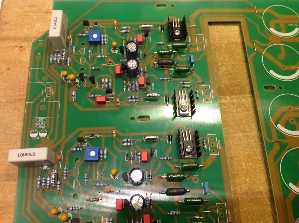

I am surprised this has solved your hum problem. I would not expect a lack of quiescent current (in one channel) to cause 50Hz hum (in both channels).
I was surprised as well, but the hum vanished following the part swap and it was also possible to make it stop prior to replacement by applying downward pressure to the trimmer. Not sure if you saw a comment in an earlier post whereby the hum could be made to go away by knocking the front panel, indicating a possible mechanical problem although I had assumed a bad solder joint rather than a faulty part. I guess this could also be attributed, though, to a fault elsewhere on the PCB where the flexing caused by the downward pressure on the trimmer was enough to break, or make, a faulty connection or affect another component's behaviour. I'm going to be keeping a close eye on the situation and I'm keeping an open mind.
On another occasion, which I haven't previously mentioned, the hum stopped when I touched the tip of a X1 'scope probe on the base of TR9, the NPN driver for the +ve-rail-connected output device, but then started again at the next power-up which was performed immediately.
Could it be possible that the trimmer, if open circuit, was making the amp more susceptible to interference pickup which led to instability? The channels do have a common 0V.
Is the hum situation repeatable by adjusting the output emitter voltage drop to the level it was before your fix.
It would seem the drift in Iq setting due to the trim pot made the amplifier marginally unstable (on a cusp) and touching TR9 base gave it the little push it needed.
I tested the pots on my PCB, and one of them was already defective. Good finding howarthcd! I replaced them with good quality Bourns pots. You could see that I also replaced the tantalum input caps with Evox MMK
Seems unlikely. C3 (the Vbe multiplier cap) keeps the impedance relatively low which makes noise pickup less likely.
I've never heard of instability causing a 50 Hz hum.
Anyway, good spot on the trimmer problem. I have some "Bonens" trimmers - to be used with caution!! You would have thought "Buorns" or "Bournes" would have been closer
The is no LM317 for the preamp either. I'll use a discrete Jung regulator.
Looks good so far! What led you to pick the Evox MMK capacitors over the tantalums?
Also which series Bourns pots did you use to get the correct pin spacing?

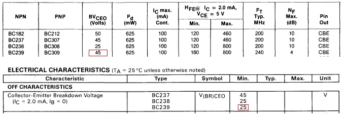

The list is interesting. On page 10 the voltage rating for BC239 is given as 45 the same as BC237 however the values are in terms of V(BR) CEO as distinct from V CEO. On the other hand the datasheet gives 25 minimum BC239 and 45 minimum BC237. Check this link out. https://www.jedec.org/standards-doc...collector-emitter-base-open-vbrceo formerly b
It was the same in the 1984 version of the book, image attached:
https://ia801703.us.archive.org/32/items/MotorolaSmallSignalTransistorDataBook1984/MotorolaSmallSignalTransistorDataBook1984.pdf
Why the discrepancy?
I would assume that if it was an error then this would have been corrected by REV 6 and certainly not carried through for at least 13 years.
