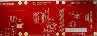

Some progress......95% done the mainboard. Final dimensions are 2.95 inches by 12.4 inches. That is large enough of to mount 4 miniSharc units side by side. Needed 4 layers because of the I2S routing :(. Added PCB manual switch bank for TOSLINK options. Also USB switch was added so we can cycle through the 4 miniSharc USBs. This will allow for changing the data without having to unplug each unit. Will use the 4 config settings to keep track of different sharc configs.

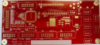

Some progress........95% done the controller. Ended up being roughly 4.5 by 2.5 inches. Managed to get done on 2 layers. Will be able to:
1. IR remote. NEC generic and Apple remote.
2. 2 Displays from New Haven. NHD-0216SZW-BB5.
3. Encoder.
4. Control for 4 DAC boards.
5. Control for expansion Mainboard.
Hopefully this will fit inside a normal 2U case? Will have to see. Internal ribbon cables to connect everything. Still have to determine how power will be distributed.

I was pondering using the nanoAVR in a build, but I have not seen the board to know if there is even a header that can be used. I was figuring that the base nanoAVR is the same in the NanoAVR HD and the HDA. The HDA just has the 8 channel DAC attached. I think that your idea of feeding the minisharc's is interesting. I could get by with 16 channels (3 way fronts, 4 subs, surrounds, center, and SB's). Do you have the miniDSP boards on hand?
Hi wcwc,
I have the nanoAVR HD and the nanoAVR HDA on hand as well as a miniSharc. I've scoped the header of the nanoAVR HD and it seems like it outputs some signals on the header that I assume plugs into the miniDAC8.
Since the miniDAC8 must use the same header hardware config as the miniSharc (it plugs into the minisharc) I'm assuming the headers match up; however, I did notice that the nanoAVR HD might have a different MCLK pin allocated. It seems to be 1 pin over. That said I will be cutting that MCLK header pin before I install the boards.
This should not be a problem as the miniSharc performing as a slave input does not use the MCLK pin. Seems like the MCLK pin is always an output. This should also be ok because the miniSharc claims the I2S input uses the SRC before performing the DSP calculations.
The reason for a custom DAC is 2 fold. I'm not sold on the noise floor of the nanoAVR HDA (I have some efficient tweeters) and I wanted some isolation between the DAC and DSP.
So are the HD and the HDA board units the same, except for the DAC8 board being added for the HDA?
I believe they are as I'm able to upgrade the HD by buying a miniDAC and putting it in a new case. There is an upgrade link on the minidsp website that I can't seem to find right now.
I'll report back later when I've opened them again but I've loaned out the HD and the HDA is in use till I get the PCBs back.

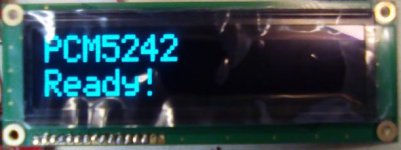

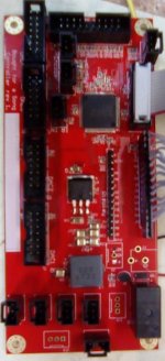

Some Progress. Controller is populated and processor alive! The DACs are taking a long time to populate by hand. Even with the integrated output drivers 32 channels are a lot!!
Display is alive and working on PCM5242 I2C interface. Hopefully will get volume and filter selection working soon.
