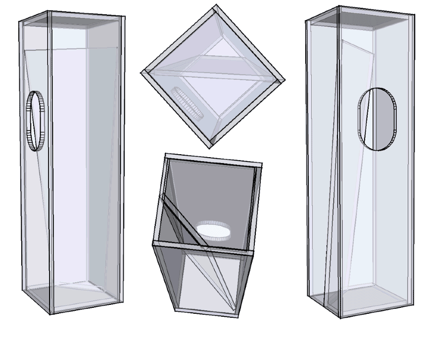

Note that the 1/3rd number is an approximation. The optimum offset is dependent on the taper ratio. Basic numbers buried in MJK's alignment tables.
Depending on what you are doing a single fold can work well, an example: http://p10hifi.net/TLS/downloads/B139-TTL-map-100707.pdf. Mount a mid-tweeter above the woofer and away you go.
attachment.php
(this could use a 90 degree partition to make it esier to build)
You can also do a single fold and unload the back "half" early (Bob Brines IIRC was the 1st examplei saw)
