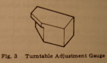

You wouldnt happen to have one of those Nak disk table height alignment blocks?
Yes I do, I'll gladly measure it for you. I will email you a picture as well to make your life easier. I don't have a manual for the OMS-4 anymore, could you please email a copy to bhomester at gmail dot com? I'll figure out which jig it is and get you that information. The standard Mabuchi motors are used. I'll try and dig up a generic number for you.
-Chris
Anatech
I have a Nak p/n for that block (OC82258A) I believe it is 18.8mm height. That would be really helpful . Heres a pic of the gauge.

Hi Dave,
That doesn't look like any of my gauges for Nakamichi. It's possible that I simply measured from the TT top surface to the mech surface. I could tell more readily from looking at the manual.
I was authorized waranty, but all my manuals stayed with the shop when I sold it. Nakamichi a=had more jigs and test tapes / discs than any other manufacturer. Well, Teac certainly came close I guess.

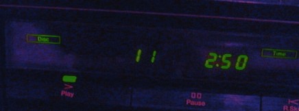

By the way. Is dim LED display segments pretty common in these units? The pic shows track 11,those two segments of the of that particular readout are the only segments that are dim the rest of the segments are full intensity...........

Hi Dave,
After a lot of use, yes. Those digits are the most often illuminated. Happens with the TA series recievers as well.
The OMS-3,4,5,7 are interesting. I think they are the last of the parallel DACs. Soon after they switched to a serial data stream. Nakamichi used a shorting type deglitcher and ended up with a smoother sounding D/A stage.
