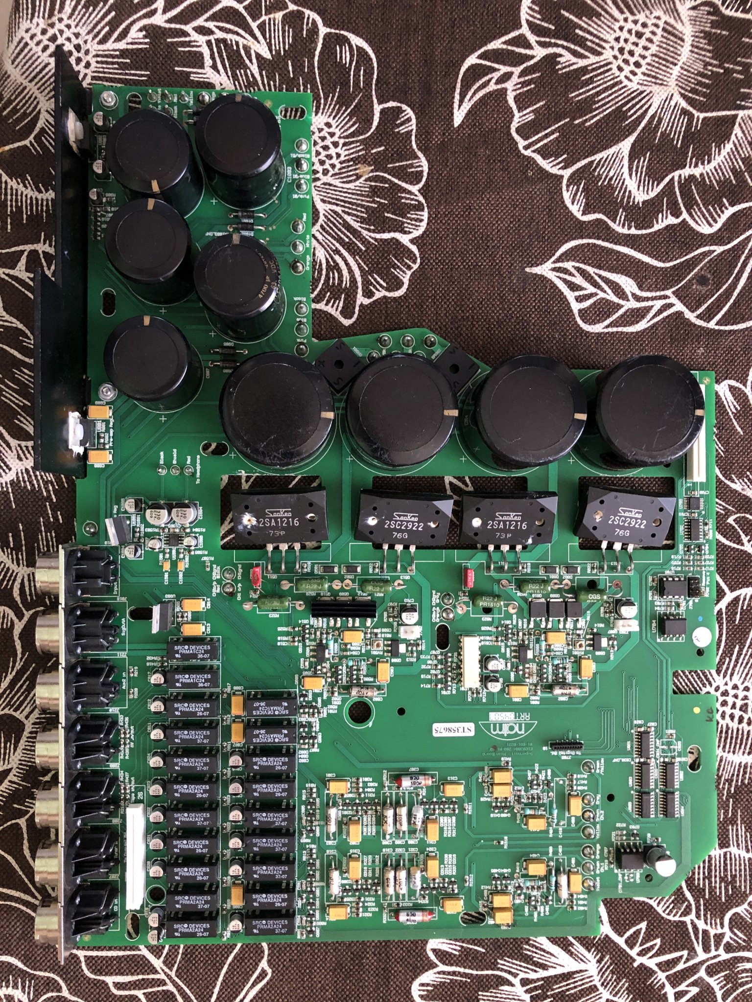

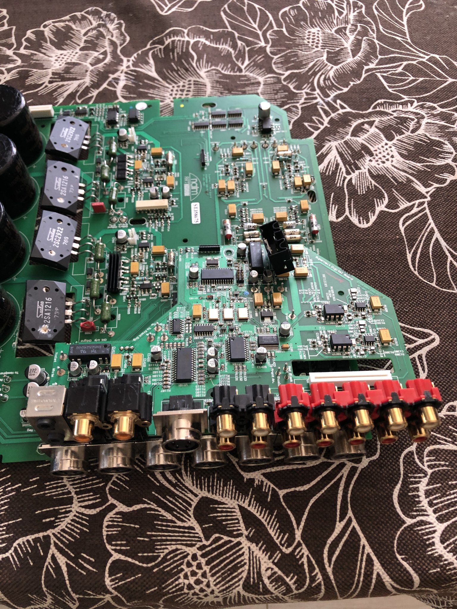

I bought a Naim Supernait (version 1) on eBay a few years ago and it was not functioning properly. I missed the return timeline.
The issues- right channel has pretty significant buzz/hum.
Amp sometime automatically mutes (safe mode?)
One input plays, a few have no output and one (the Tuner) input through my main house breaker once. Yeah, the main one....
I've pop'ed the hood and nothing looks obviously damaged.
I have a meter but no scope or other audio repair equipment. I'm confident in replacing a cap or resistor if this forum can help me diagnosis, otherwise it's going to have to go back Naim for the $1k+ repair.
Thanks all

Does the amp play a while and then mute, or happens quite fast at turn on? A spike in DC can do this as can output devices shorting to the heatsink.
Try this - disconnect speakers and with one input connected, connect your multimeter to one pair speaker terminals, red to red... set to mV DC, you're looking for a big DC spike at turn on.
The internal bias may need adjusting, certainly a recap is in order by now, try that anyway. With power on and nothing connected you could chase the voltages around the board to see if regulators are working, rails are correct...
Input problems are a pre amp problem maybe? An independent technician will cost a lot less than NAIM. Can you find a service manual?

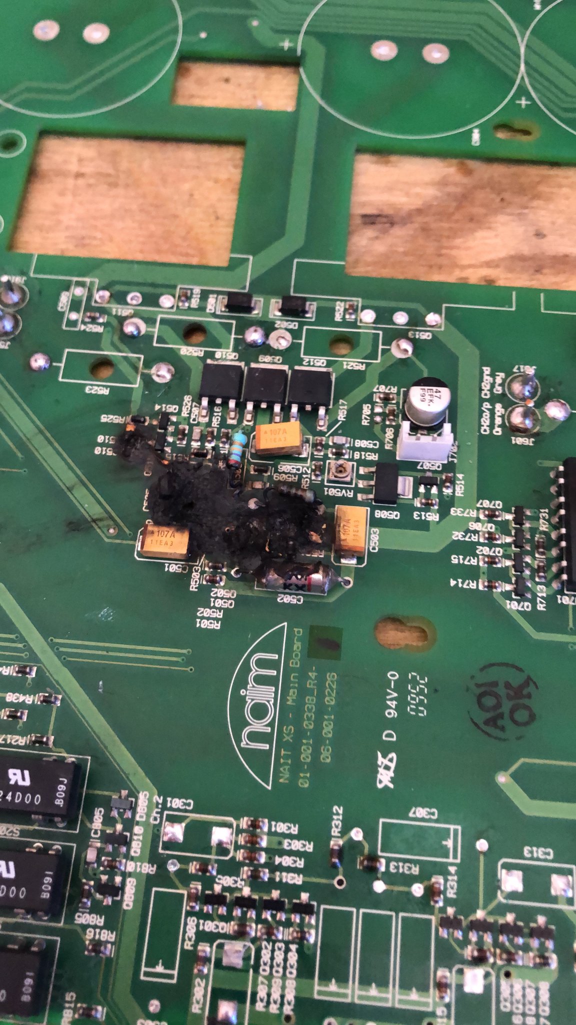

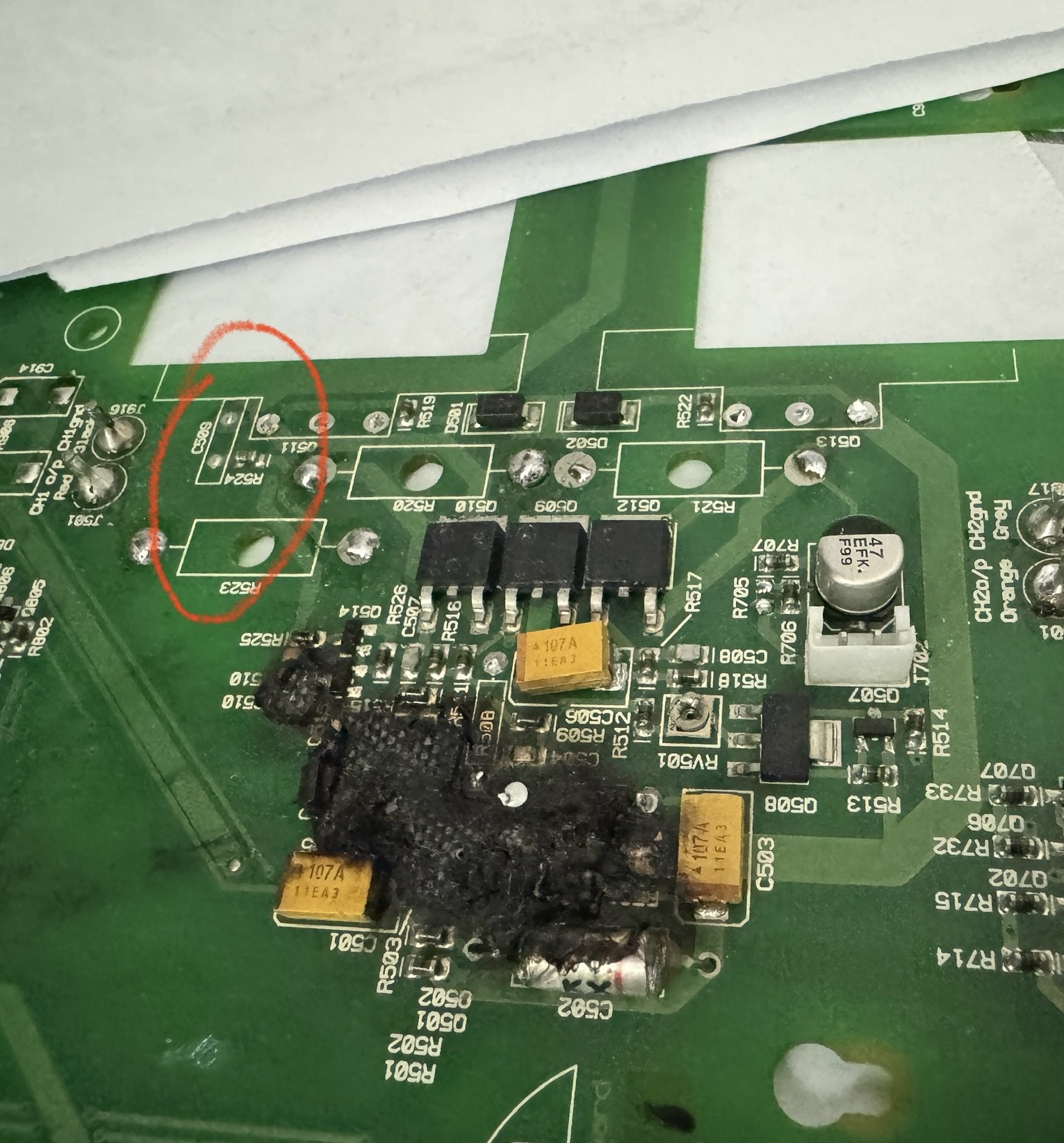

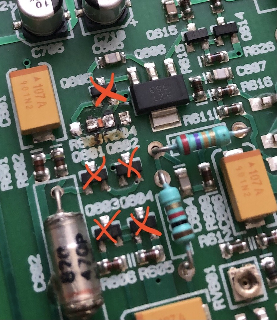

From another channelHow can you get component if they are destroyed?

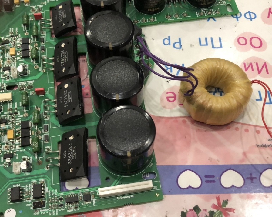

Its condition when i got board SN1An interesting capacitor!
Perhaps this is a problem...!
Maybe other peoples worked with iron
I got the new from NaitXS donor
hhhWonderful how do you fix the charred PCB?
Get a new from official service center if his a have it and trade without reparing in him office
not for all services
But if you have are litle damage maybe with drilling and romoving the black burns a fixing it may be not
