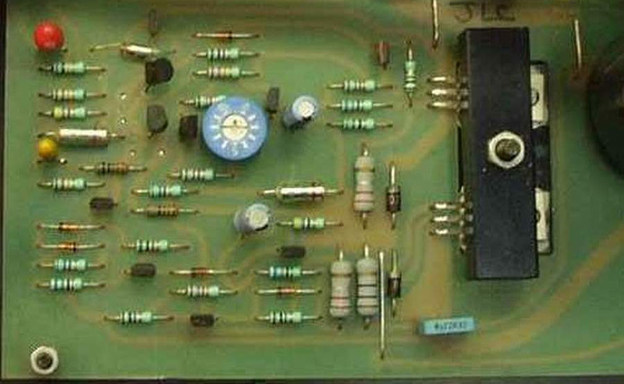

hi,everybody:
thank you all at first!
I "crack" the nap90 amp schematics lastnight,yo!
as your say so:"as same as their seriers",no more difference...
here is one channel of nap90's PCB:
:D

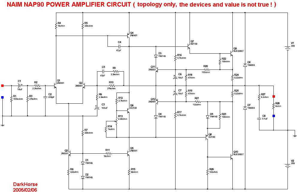

Stabist said:
That remark at the schematic about values - does that mean this is another Naim on schematic or that you "changed" the values purposly?
hi,Stabist:
the values is referenced to nap135 & 140 & 250...
I have do simulation at this schematics ,it can work,but output point voltage isn't 0V to the groung,so I have to adjusting R6 to let output point is 0V...and adjusting R13 to let output stage Iq is 150mA.output power 40W(RMS),THD=0.022%...
please trust the circuit topology only,because I don't know the devices and their values!
cheers!
WINCO

the interesting thing is that, there really are no other naim amps, ie 90, 140, 250, they are all the same circuit, its only the psu that differs.
ditto with the preamps, they are all the same, just the switching and perhaps features, and bit more regulators.
the basic amplifying circuit is identical.
so naim have gone on for 20 years or so, making the single same amplifier under a lot of different names with only psu differences.
isn't that fascinating, and frustrating? it means perhaps they can't design much different, or perhaps, is the only circuit that gives that definable naim sound, and changing it even slightly will completely alter the sound, so anything else isn't naim.

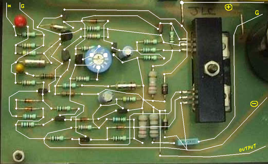

here...
the differences, obviously 1 or 2 component quality "substitutions"
but additions/subtractions
1/ decoupling caps in psu. extra
2/ diode network on power rails
3/ removal of current limiting network
4/ addition of series inductor
5/ removal of capacitor/resistor in parallel with feedback resistor.
6/ addition of local feedback degeneration in differential pair
I think that's it.
I don't FULLY understand functions of
1/ reduces impedance of psu at hi freqs.? but I have heard this enhances stability which I have no idea .....????
2/
5/
and the series capacitor/resistor network in the signal path...obviously phase alteration tho', apart from dominant pole miller caps, I don't have a clue about the rest of phase shifting cap networks anywhere

The only issue I can see is the removal of the SOA protection in a circuit that has no other means of protecting itself or the speakers.
The circuit in question is an RCA circuit. Naim has their take on it, Avondale have theirs, both have very many happy customers. New Naim amps have completely changed their layout. Thats what happens, its progress, optimisation, but behind all of this, perhaps simple is best ...
