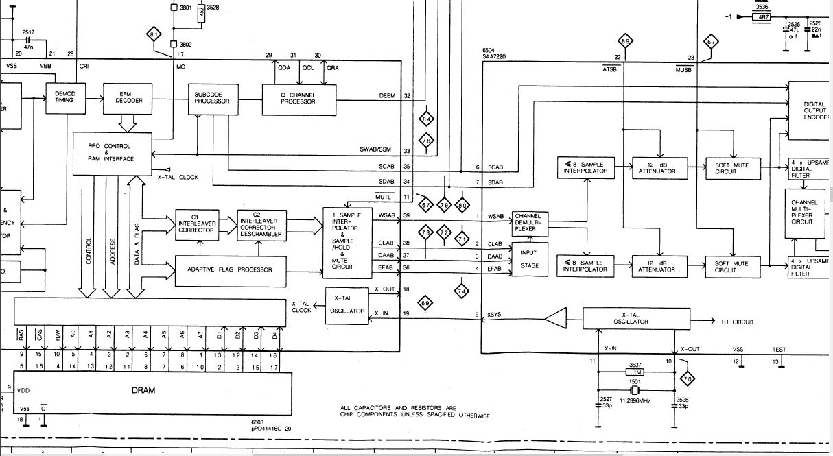

Maybe the 7220 is not generating the clock signal? Can we test it without the scope? At the moment pin9 XSYS is giving out 1.7V

A scope is essential kit really, especially for work like this. There is no realistic way to look at clock signals without I'm afraid. With something like this I would start going around every pin on the relevant IC's and make sure that what would be expected is actually there. The scope excels at that because you use it juts live a voltmeter, except now you can see any problems/noise and so on as well as missing signals.

On the Philips diagram I am looking at pin 9 goes only to the RF decoder chip. If your is different then this is another reason why its vital to have the correct diagram for your player.

I tried but I couldn't find any info on the CDi schematic. I am more than happy to pay for it if anyone knows where to get one.
Looking at the ma inboard layout pin 9 goes straight to pin 26 (xtal) of the 7310. Since there are continuity to other pins (player on or off) I think that my 7220 circuitry is shorted. I'll order a replacement and see how that goes.
