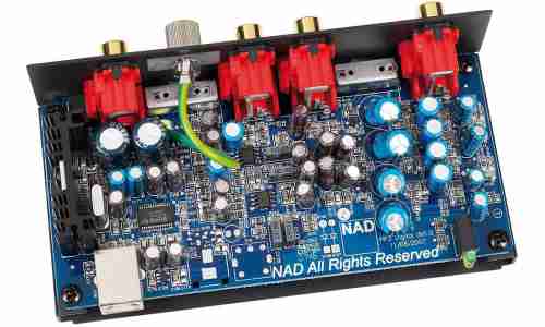

PCB Layout wanted
From a friend I got this phono part and I did not remember that I create a schematic of it and uploaded it here.
No output signal is present at both channels, both at MM and MC input.
The reason therefore is clearly too low voltages (+2/-5VDC instead +9V5/-9V5DC)
Next step is disconnect the voltage regulator from the actually gain stages to find the reason in detail - for that I have to cut the voltage traces at the right places.
Maybe a SMD chip capacitor have a transition between the voltage rails and GND.
Without a PCB layout the component in question (fault-causing component) is hard to find.
Maybe one of the members can upload this.
Thank you very much.
P.S.: I don't know the usual colloquial term for what I need, so I have attached a PDF file from a PCB layout of another audio device that shows what I mean.
  • PDF-Datei.pdf
I just note, that there are at least two PCB versions on the marked - do to the attached images. I need the wanted PCB layout from the old version of first image (from the year 2008) and not from the second image (currently version - so I thinkl).
