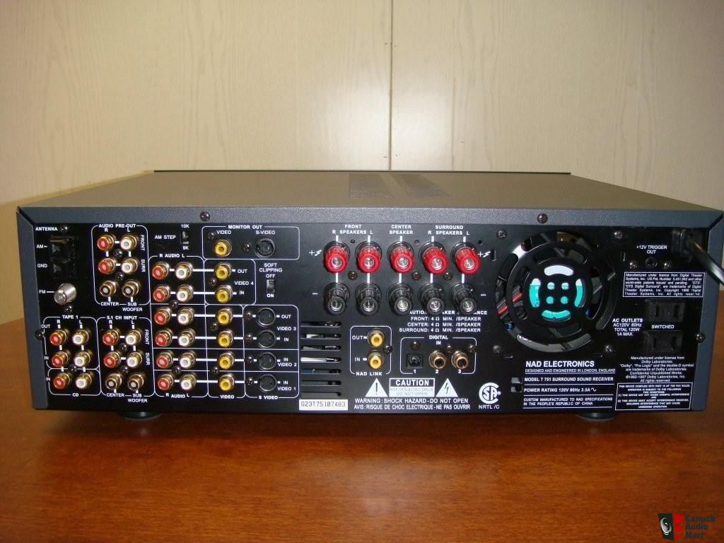

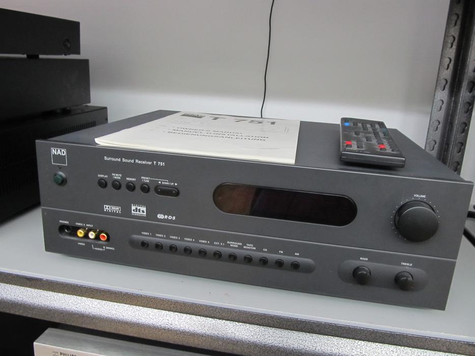

NAD T 751 receiver - right channel quiet -- then I hit it then it plays fine -- ???
NAD T 751 receiver
Right channel plays quietly sometimes, then I hit the top of the receiver and it starts playing the same volume as the left channel.
I read that when a NAD receiver had this problem it is usually a relay.
So I took it apart to clean the relay(s), but did not find any.
What could the problem be?
Where are the relays?
Should I take a picture of the inside?
