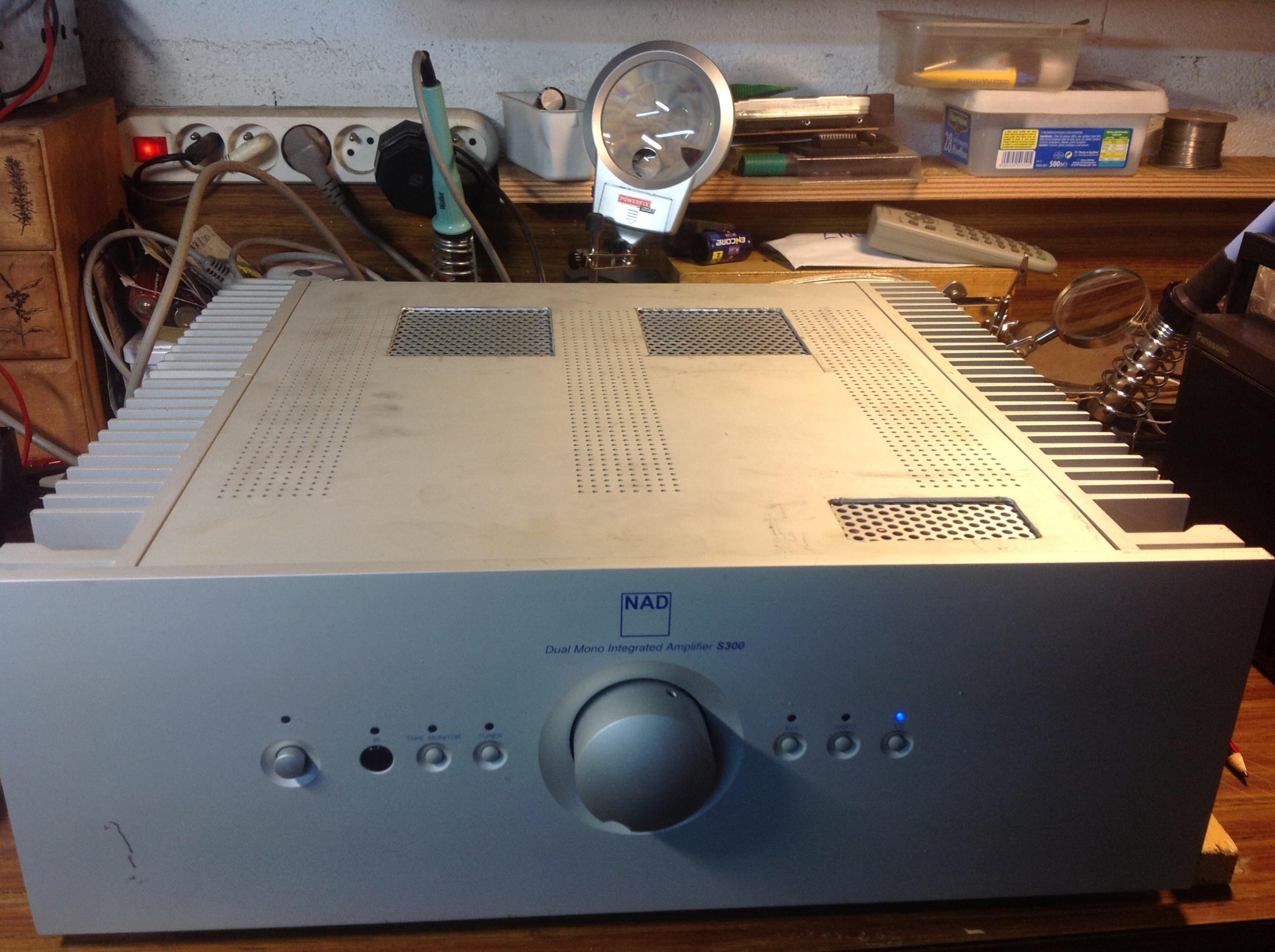

Hi guys.
Small question, maybe someone can help.
My friend has got one issue with s300, but it seems not to be discussed problems with diodes blinking or noise in one chanel.
The boards have no signs of overheating near to the crucial resistors and transistors. All looks fine except poor soldering quality (were these first experiences with lead-free solder?? damm, this look really poor)
The AMP normally is working fine, but sometimes the volume level of one channel is suddenly raising slowly but... to the top. So you have to trun off the amp quickly, as it probably kills the speaker. So you can use it, but this is stressfull

As only one channel is affected, this is likely just another symptom of poor soldering - perhaps even near the volume control. The best solution if you are unsure how to trace faults, would be to simply reflow all the joints on the input selector and gain stage (the signal handling sections) of the main PCB. Sure, it's time consuming but at least it doesn't involve a lot of discussion about "possibilities" and reduces the chance of other future problems too.
You could also try tapping around the board, using freezer spray etc to see if it provokes the fault so you can identify it but that may just be wasting time that could be spent on a general overall improvement.
