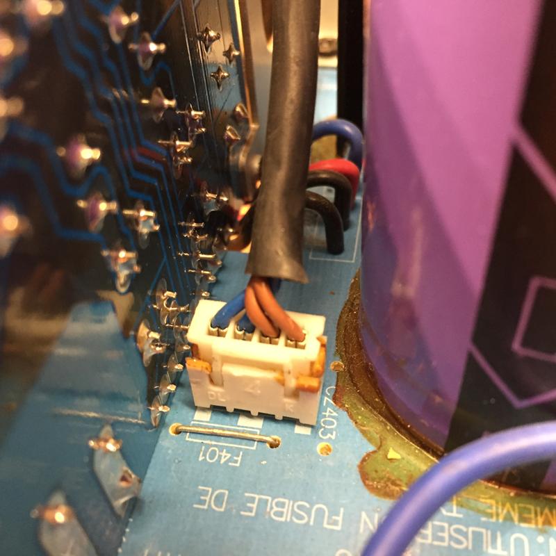

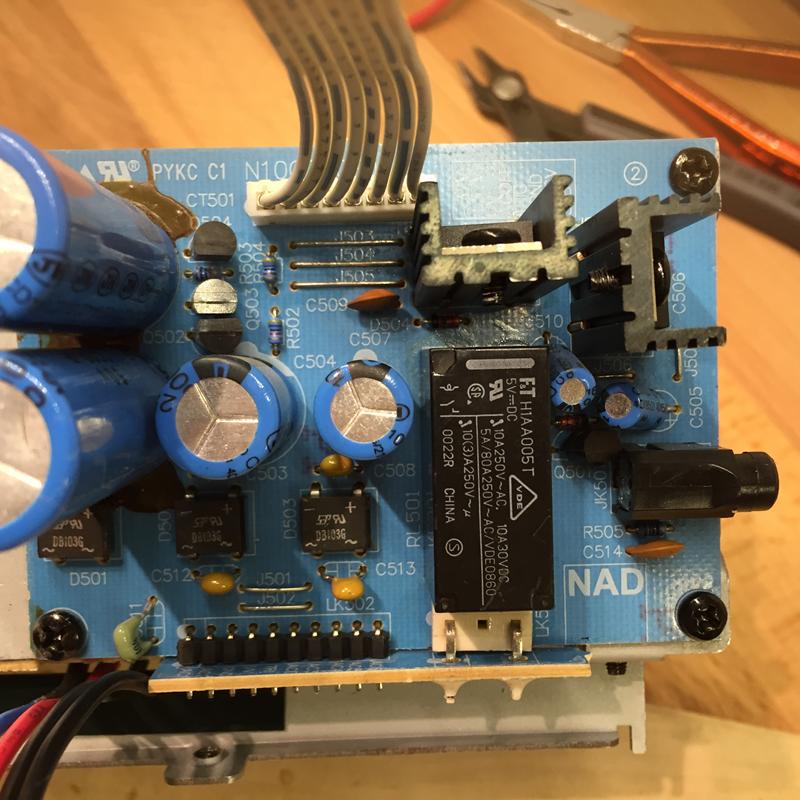

Hello, I thought I might as well continue this old thread, as I have a similar issue with a C350.
I bought it cheap as defective a while back. The protection light would come on, and stay on - same as many others have experienced. I have tried to fix it, but I'm stuck now, and would really appreciate a little help :)
Full schematics are attached as PDF.
So far I have:
Replaced the two fusible resistors (they were both open!) with solid wire jumpers, as has been recommended elsewhere.
Checked all capacitors in circuit with ESR Micro 4.0 (the russian one), which seems to be quite reliable for this purpose. I didn't find any open caps, but some of the "known suspects" in protection circuit had very high ESR (like 6r) and low capacitance. So I replaced most of these for good measure (C135, C149, C159, C160 and others). The C143 measured perfectly in my case (also out of circuit), so I put it back in.

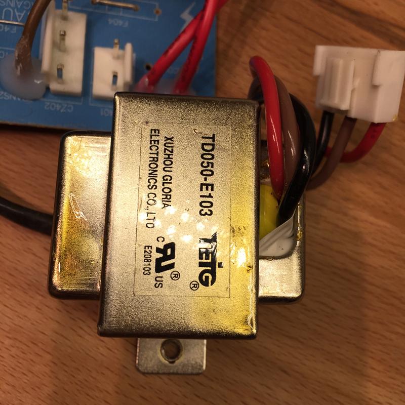

After these changes, I powered it up using my 100w bulb tester. The result is a steady bright flashing of the bulb, with about 1 second intervals. At the same time, relay RL501 clicks on and off. After leaving it like this for about 8 seconds (longest I dared..), the secondary transformer TR02 had a slight burned smell, and felt warm to the touch.
Having seen somewhere (on Youtube I think), that shorted TR02 is a common problem, I took it out of circuit, and measured the voltages. It has dual secondary windings. The blue pair gives 19 VAC and the brown 9 VAC, which sounds ok, as they are used for 12v and 5,6v output. The clicking relay RL501 looks to in the 12v circuit, but can't seem to find it on schematics - I think it is lost in the page break.
Measured resistance between primary wires:
Black-brown: 177r
Black-red: 0,52k
Red-brown: 348r
Measured resistance between seconday wires:
Blue-blue: circuit
Brown-brown: circuit
Blue-brown: open
Seems like reasonable values to me, but could it still be defective?
And if not, what to do now? :confused:
PS. If repair is unsuccesful, it is no big loss: Mainly trying to fix it for the practice, and it really is a crappy cheap construction - with power wires left chafing on sharp metal edges etc..:nownow: . A bit of pain to disassemble also, not a well thought out design.
