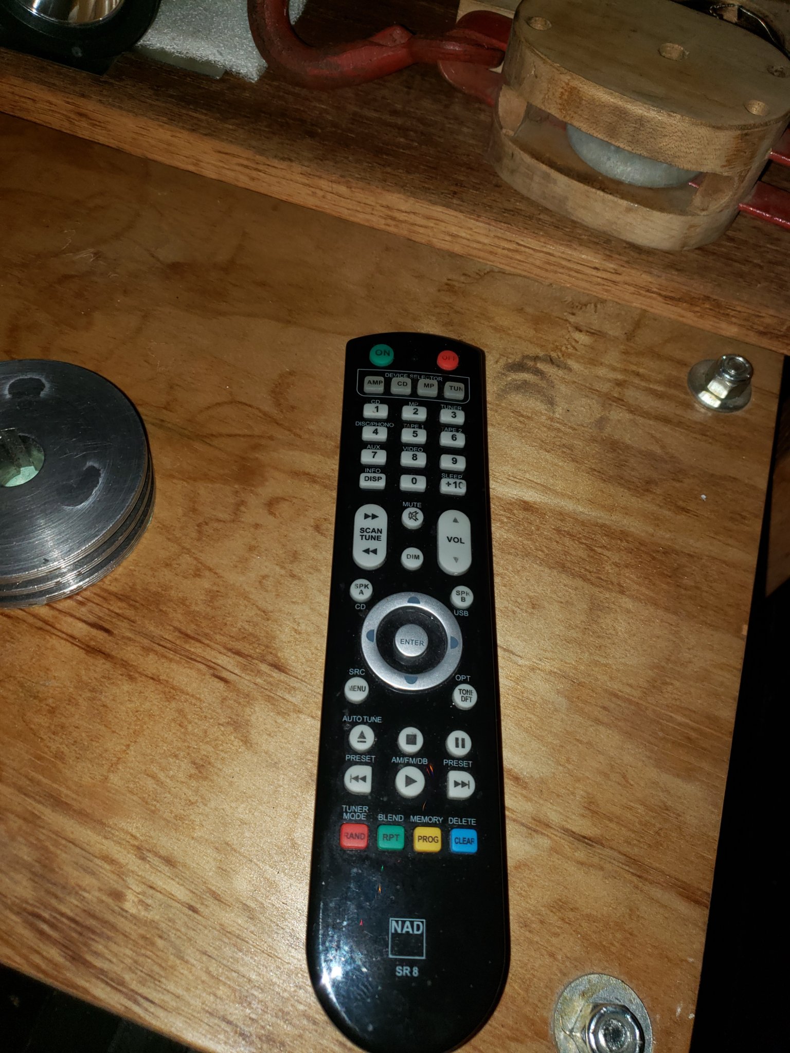

I have a nad C326bee that I was given, no information about it at all. It works perfectly in all functions. I have just bought a remote control for it, an sr-8 that unfortunately does not do any functions at all. I have also tried a remote for a C325bee which also does nothing but its a different remote with fewer functions.

Have you got the correct remote controller? If you have, is there signal leaving pin 1 of the IR receiver? If the buttons work on the machine, it is unlikely the decoder is at fault. Using a mobile phone camera, look at the output led on the remote controller, it is transmitting?
The remote controller is working, one flash every one sec, and is a nad sr-8, the correct one.

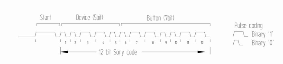

Remote faults (at the receiving end) are rare. You should see a 5 volt 'data' type of signal a bit like this. You need a good scope to be able to clearly show the data but as long as the signal is present and at 5v or so pk/pk then its going to be fine.
Most problems like this are down to having an incorrect remote.

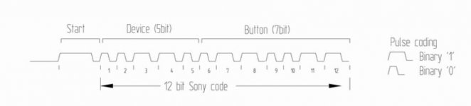

It does sound like a remote problem. There has to be more than a single pulse... there should be something like the 12 bit code I posted yesterday. Usually that code repeats over and over as long as a button is pressed.
Even if the remote were an odd ball type that transmitted just a single packet of data, you should still see more than a single 'empty' pulse.

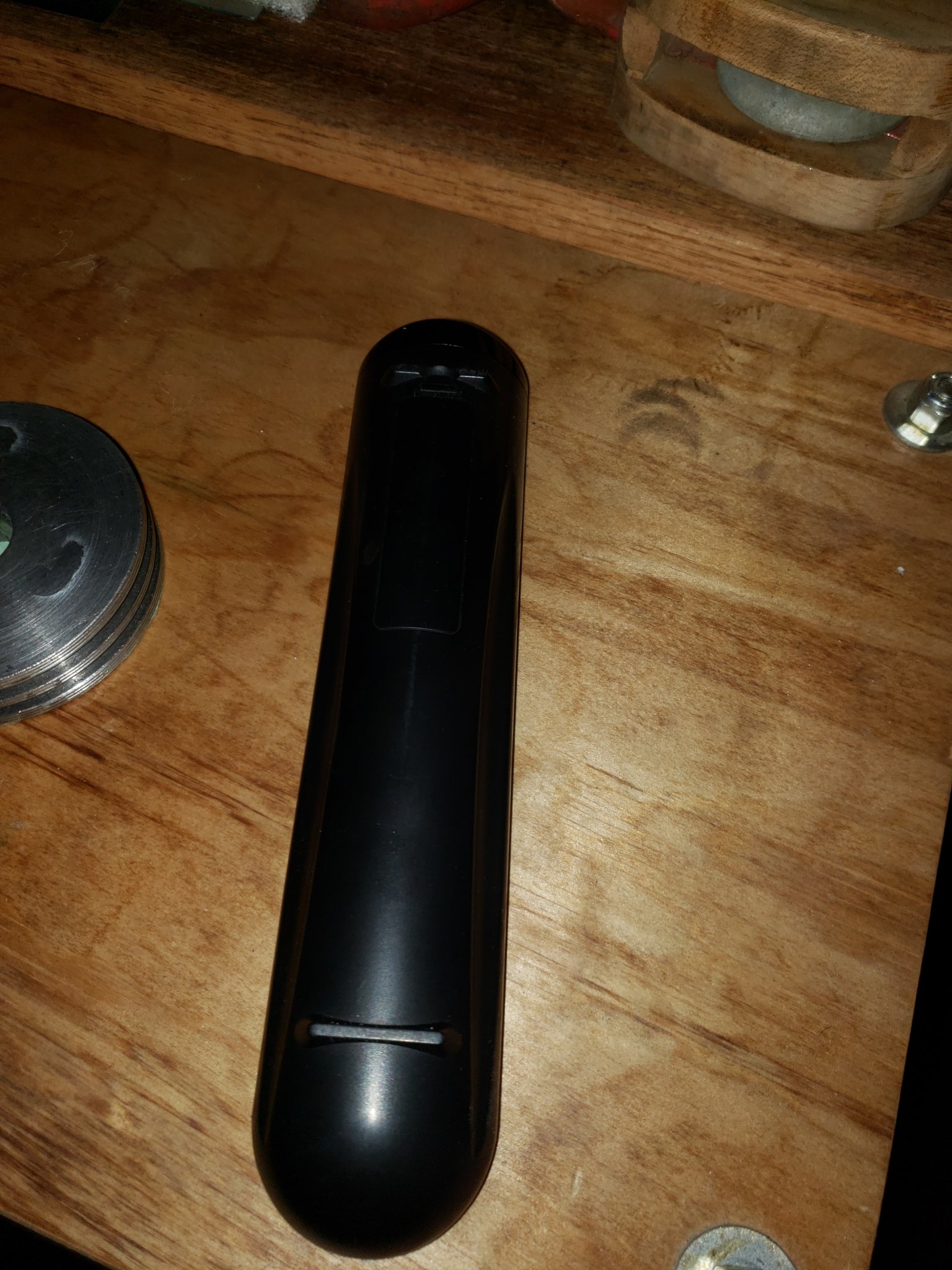

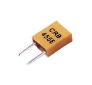

The remote has to be the problem, the question is whether its fixable or not. Have you opened it up. The only 'common' physical problems with remotes are spillage, faulty IR diodes and the ceramic resonator snapping one of its legs due to mechanical fatigue... if its that type. That was a really common issue years ago across countless makes and models.

Its new, and I did as you said and removed the batteries for a bit and it is now giving data pulses and more important is working the amp so thanks for that alot.
