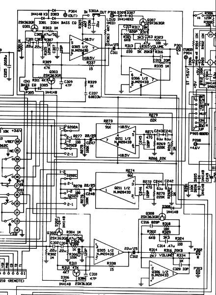

NAD 7100 channel imbalance
Some progress: All electrolytics in pre-amp signal path replaced, but to no effect.
So got the 7100 service manual (BTW a very professional copy supplied by vintageaudiomanuals.com) which has a preamp channel balance adjustment, performed at full volume with 100mV 1kHz CD input. This is via a trimpot (R 315) in the feedback volume control circuit.
OK. So I adjusted for equal output. However, at normal listening levels the channels are still out of whack requiring a 3 o'clock balance adjustment.
OK, so tried adjusting at normal listening position, and with the trimpot at R=0, still out of whack by about 2 o'clock. If I use the low level function (-20dB mute), then the channels are almost balanced.
Could it just be that the volume pot is out of whack???

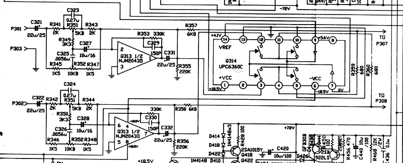

Attached is relevant section of preamp circuit. Output is at P301 and P302 which goes to tone conrol section.
Next post has the tone control section which is on the power amp board.

Thanks for the suggestion, but I have already confirmed the power amps are not the issue. The channel difference is seen at the pre-amp outputs (I'm using an oscilloscope).

Dead resistor? The low-level function just enables a voltage divider, since that works it might be a good clue.
Thanks for the suggestion.
Using the low level function means you have to turn up the volume quite a bit for the same output.
I begin to think the left and right volume pots are just out of whack.
As per the service manual, the outputs can be set exactly equal at full volume. The discrepancy only arises as the volume approaches normal listening levels.

Good - if you have a scope that makes it easy - set balance to the midpoint, volume to normal listening level, and follow the signal path looking for differences between L and R. Chances are there's a cracked resistor, cracked etch in the pcb, bad solder joint, etc.
On 3 different pieces of equipment (TV, car stereo, NAD receiver) I have fixed various problems by reflowing the solder joints. The trick is finding the one that needs it.
just replace the feedback cap in the weak channel (in order to get a well balanced power section, better replace this cap in both channels), it is a 200uF cap., all voltages in the power amp. section should be normal, the cap leakage sends the signal to the ground and causes exactly the problem.
