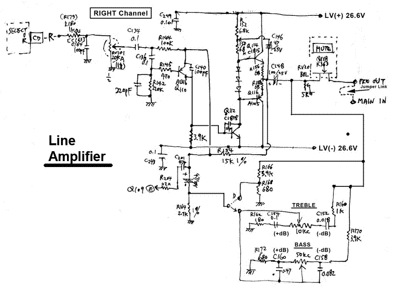

NAD 314 problem (fading channels)
Hello to all....as with most amplifiers that show signs of fading in and out once they've been on for a few hours before the fault show's up...I tend to reflow dry solder joints cracked tracks etc and clean scratchy sounding volume/controls... sometimes I've came across the mica sheet that's between the power transistors and heat sink to have small holes in it thus shorting out the devices...
I fixed my NAD 314 amplifier with this trick
Thanks to everyone that gave good advices.
I fixed my NAD 314 amplifier by opening the black relay close to the speaker output terminals.
I first tried to fix it with brown paper + electric fixing spray, but this didn't work. Then I just took sanding paper and gently scraped those two surfaces.
Now it's fixed.
