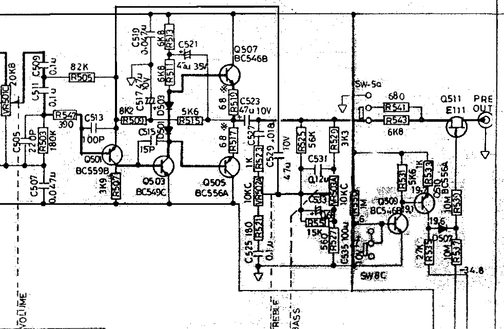

You should completely remove those transistors if you want to bypass them or use another muting method. It appears the signal passes through those fets from past experience with NAD. I would replace them with a signal relay. High value resistors to ground on both sides to reduce any "pop". Or, a high value resistance across the contacts and another to ground for attenuation while in mute mode. Depends on what the circuit is like.

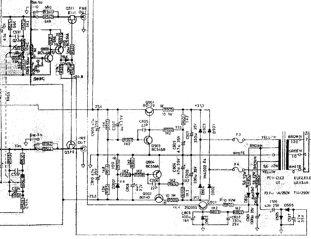

Hi planet10,
Thanks! Can you post the power supply as well please?

We can see the mute is triggered by contacts on the power switch. Q509 and 510 control the gates of the fets. Check the switch contacts are working first, short and open yourself and watch the voltages on the "G" terminals.

I plan to remove the transistors and run the signal to the balance controls. Unfortunately, I will have to let this sit for a few weeks until I get time to work on it. I will post the results.

Back from the northern Canadian Shield and after a nice BBQ steak dinner (and wine) I sat down with the pre-amp again. I could not track down the problem with the gate voltage so I simply removed the muting transistors and conected the source and drain on the PCB and there it was .. sweet music once again. There is -10V where the gates were, but I don't see that as a problem.

The supply caps are small, only 330uF on each rail. Like Dave mentioned, I have read of others having problems with larger caps on the supply. I am thinking of a nice cap (pannasonic) same size with a small 1uF poly bypass. I don't have capacitors on hand right now, so if I have to order, I may as well go with blackgates or pannasonics.
