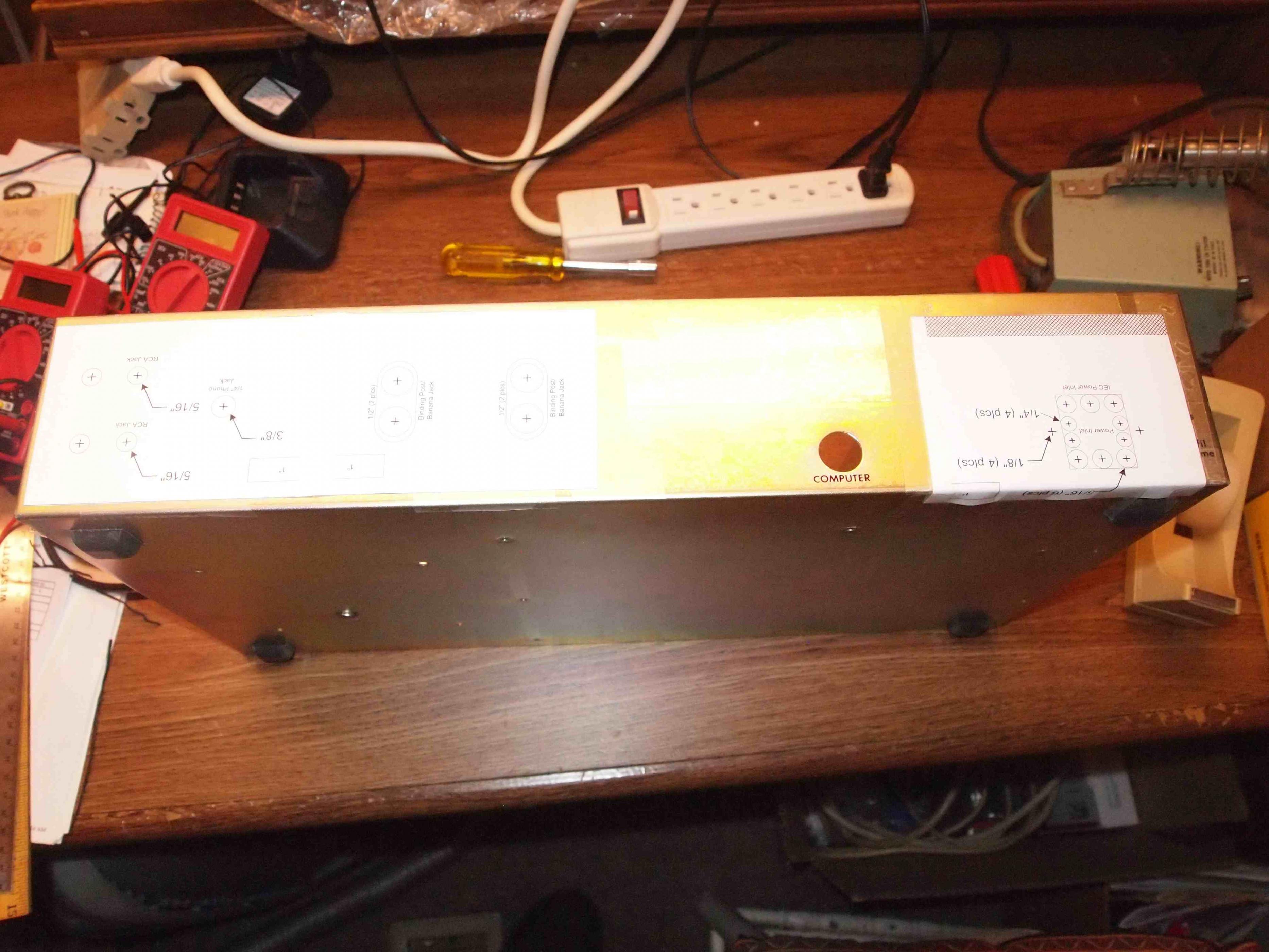

Just starting a buildup of yet another TunelabSE.
Pretty much straight from the original design, 12AX7 input tubes and 6L6 power tubes. I opted to go for point-to-point wiring in order to change the tube placement, and I am also going to use two 12AX7 tubes on the input (one per channel) to keep the 2nd triode in each tube "available" for experimenting (should I ever get the urge, time, etc.)
I'm calling it the "Nabu", after the chassis I picked up to build this in. In my search for something that would look reasonably decent, and be reasonably inexpensive, I stumbled across a source for some old NABU computer boxes.

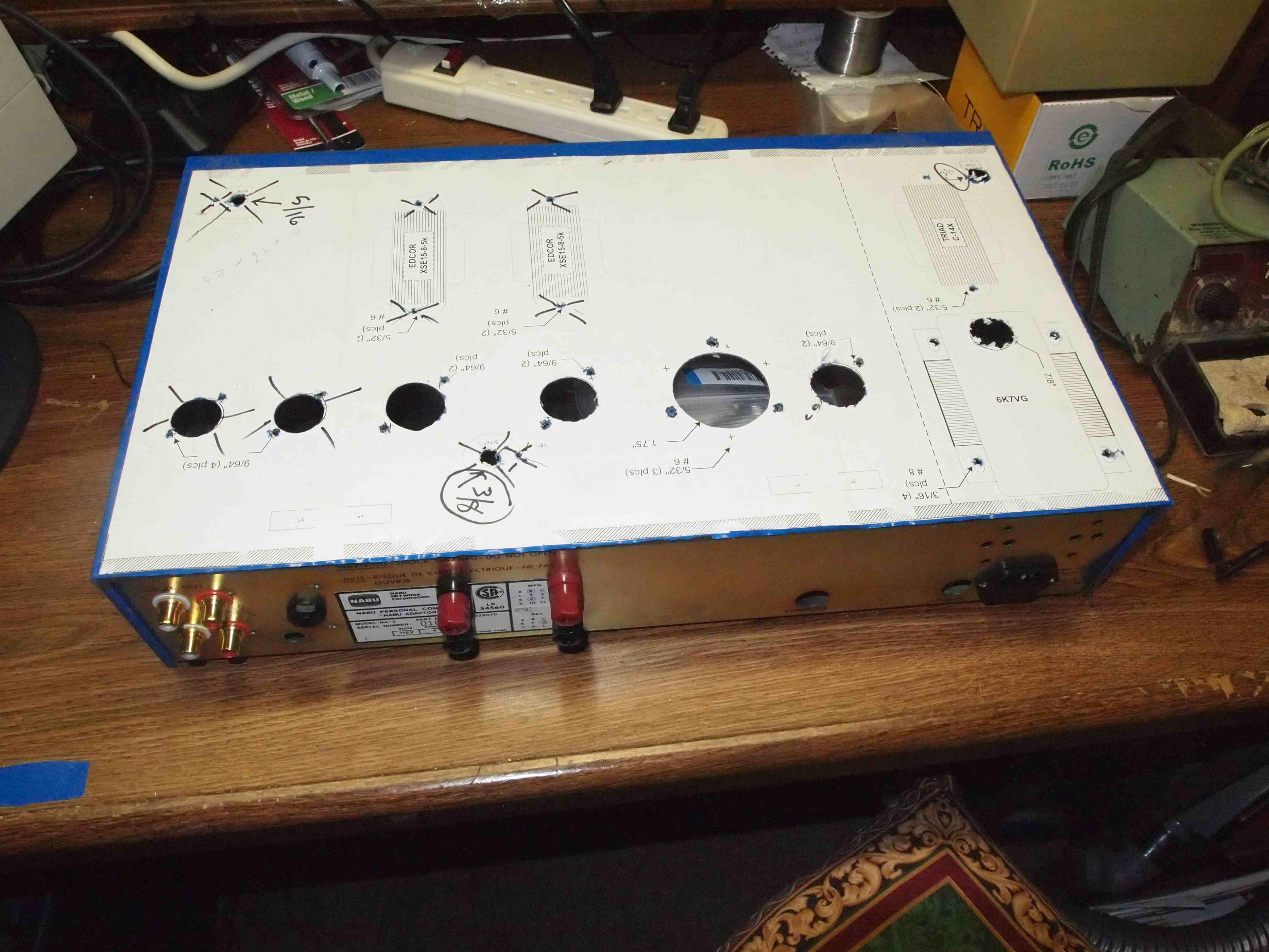

I have limited woodworking skills, and could never hope to craft some of the beautiful cabinets I see here. So I will take the easy way out and purchase something (cheep!) that I can just punch holes in.
The box is 18" x 10" x 3", and the top cover comes off to reveal a chassis with an internal wall - perfect for isolating the power supply choke!

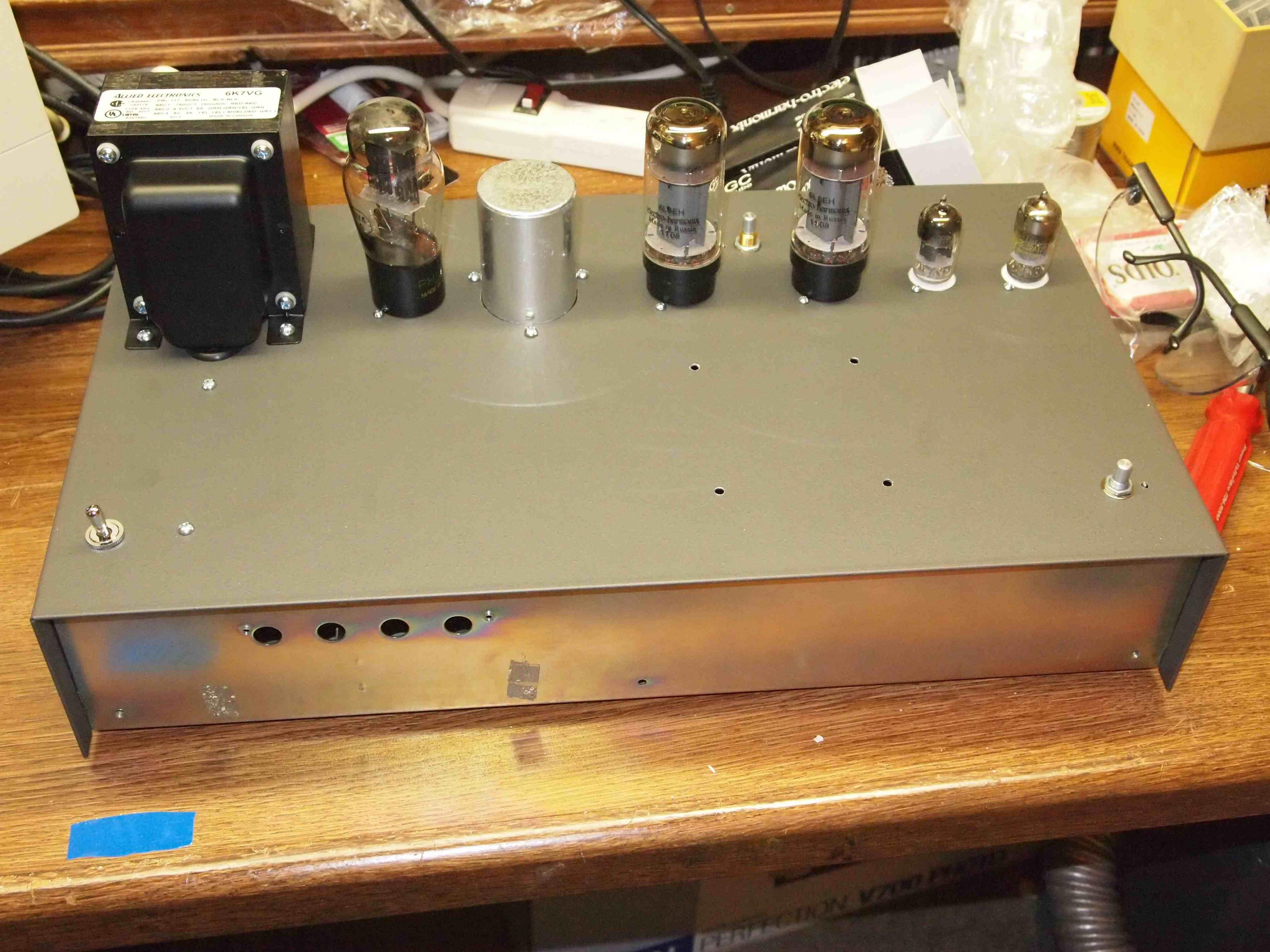

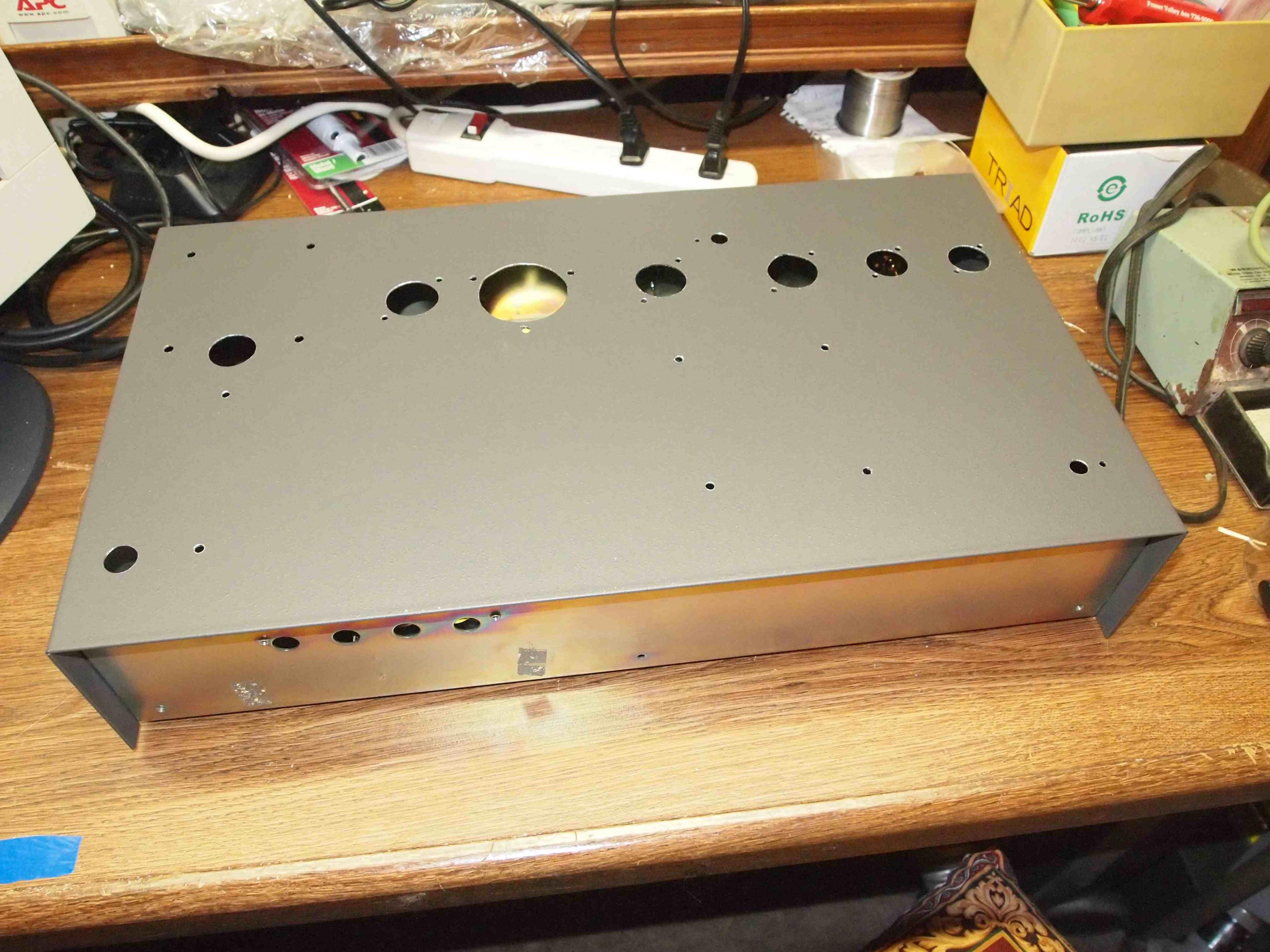

I've mounted the choke and OPTs inside, the rest of the stuff goes on top.
The wiring begins next, and I am really excited about getting this design up and running.
