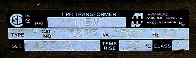

I connected the assumed functional channel and heard nothing. But wait.... What's that? Sound was coming frome one ok the choke or caps. That's a first for me. From what I can see, The smaller pair of transformers do not have primary and secondary leads, the larger two may be the same. But beyond doubt the smaller pair has only two leads each. Does that mean they are are chokes? Somebody wanna buy this thing? My brain Capacity allows me only enough space to bulld and maintain my studio at best and this is a distracton albeit quite interesting

The pair of open-frame chokes you photographed are chokes. The bigger ones are chokes IF the only leads they have are the black and yellow attached to the PCB.

In post#1 we can see that the negative terminals of all four electrolytic capacitors are connected together. So this is not a bipolar power supply providing ±X volts. Instead it is two single ended power supplies, each providing +X volts. One supply for the left channel and the other for the right channel.
The output stage appears to consist of a single transistor in TO-3 package, mounted to the enormous heatsink on the side of the cabinet. This makes me think the output stage is a single ended class-A affair, with a transistor driving the primary of an output transformer, whose secondary drives a loudspeaker.

This brand was mentioned 2003 in context with a review of two power conditioner devices - go toI aquired this amplifier. I have very little education and experience with electronics but trying to understand. I have not seen an amplifier design like this before. It is made by Foundation Research in Canada. I can not find info on it. The transformers are Hammond. Has a total of two Transistors 2N5684
