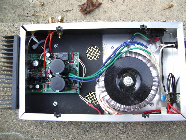

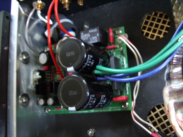

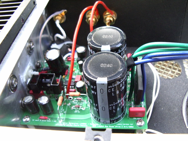

To serve as inspiration for those of you building amps, here are a few poor photos of my "ultimate BOM" amps. These are not quite identical to the kits recently offered, but they share many of the same parts, and certainly the same basic circuit.
Some elaboration on the pics: as you can see, the trannies are only an inch or two from the power supply side of the boards. I didn't twist any leads, didn't use any shielding on input or output wires, and my amps are completely silent. I mean deep, black silence. No extraordinary measures are needed to achieve these results, other than keeping leads short and not crossing signal wires with power leads.
The enclosures are the cheapest available thin aluminum. The heatsink is nearly as big as one entire wall of the enclosure, mounted on one short wall, coupled through the enclosure wall to the chip with a nylon screw and insulating pad and lots of thermal grease, spread in a skin-thin layer.
The top of the enclosure is the wooden top cut out of an old Yamaha receiver with a very large metal grille for ventilation. Nothing inside these amps ever gets more than warm.
The black material is Sound Coat from Parts Connexion. It also covers about two-thirds of each long wall. It applies directly to the aluminum and damps it very effectively. The transformer is mounted on a Spectra Dynamics Deflex Toroid Support, also from PC.
The Fostex film & foil input cap is just visible, close by the side of the board, wrapped in neoprene foam and attached to the enclosure with a cable tie. The leads can be seen easily because they're wrapped in white teflon plumber's tape.
I used EAR small isolation feet, also from PC, under the enclosure. Despite its thin wall construction, the enclosure and all components seem effectively isolated from internal and external vibration.
The input jack and binding posts are Vampire copper base (not brass) with gold plating. The hook-up wire is OCC solid copper. All connections are soldered directly to the board.
The LED is mounted on the front of the enclosure, connected by the two white wires crossing under the power leads. All four walls of the enclosure contain some element: one long wall has input and output connections, very near that part of the board; the other long wall has only the LED; one short wall has the heatsink; the opposite short wall has fuse, IEC, and power switch, a heavy-duty toggle that "snaps" real nicely when switched.
You can choose to make your enclosures more attractive, but the most complicated arrangement will probably not function any more effectively than this simple, inexpensive one.
I have noticed these amps are very responsive to better power cords. I built my own, and they sound much better than any "standard" molded cord supplied with other equipment.
Good luck with your builds!
Peace,
Tom E

The enclosure is made by BUD, available from most electronics suppliers, model no. AC-408. It's cheap and crude. There is a cover available separately, but I chose to use something I salvaged from a junked receiver. Looking at these crappy boxes, you would never suspect that they contain amplifiers that are nearly the best you have ever heard.
The blue cap on the terminals of the toggle switch was installed to address to tendency of this amp to pass motor-start spikes on the mains. It is not very effective, and I still can hear pops when a large motor, such as my furnace fan, turns on. Now, during summer, no noise at all.
The amp itself is completely silent during turn on and off. That's what the relay is for, and it works very well.
