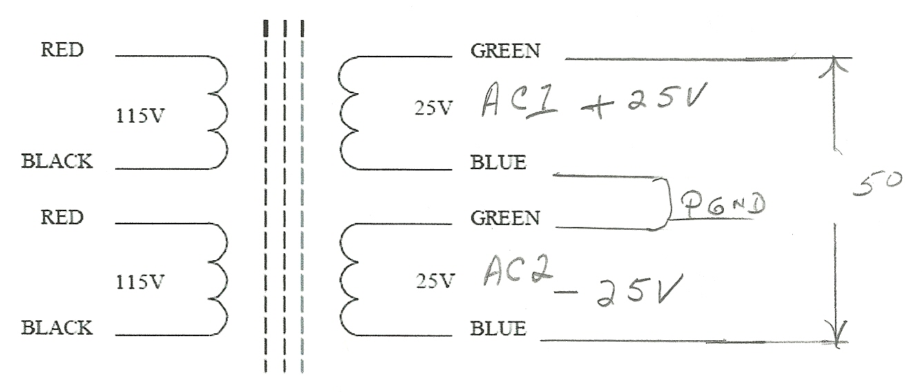

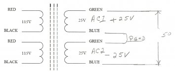

If we need 24/25 vac to each MyRefC board, What Primary voltage transformer
do we select to get the correct output voltage when the secondary’s are wired in series?
My original 12 X 12 wired in series results in 24vac to AC1, 0v to PGND, and 24vac to AC2.
If I am correct the AN-2225 When wired in series will result in 50vac to AC1 and AC2.
What is the correct ac voltage to apply to each MyRefC board?
Thank you
I think I have it figured out now, what I was confused about was the way some books explain secondary series voltage.

Hey guys,
I'm confused on how to wire my transformer now also. Could you tell me what wire goes where based on the data sheet of my transformer? It's in the link below. I use one transformer for each channel.
http://www.amplimo.nl/download/080xx.pdf
My best guess is that I have to yellow and grey to PGND, blue to AC1 and red to AC2. Can one of you confirm this?
Thanks a lot! :)
Cheers!
It looks like you want to follow the "serial operation to
double the secondary voltage" from you data sheet. Combine Yellow and Blue and use that as PGND, then use Red as AC1 and Grey as AC2.
This will give you the big voltage difference between AC1 and AC2 whereas the way you suggested would have a zero voltage difference between AC1 and AC2.
