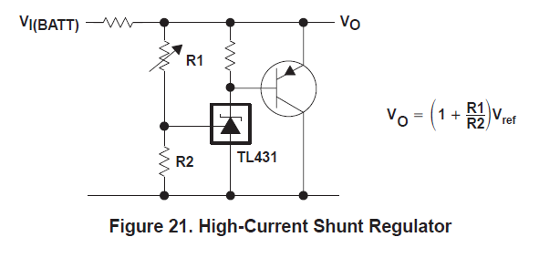

I was thinking about that simple shunt for the LM318 PS (From the TI TL431 datasheet)
Also TP used TL431 and transistors for the Sympatico...
And I suspect that also the MyRef Evolution uses a similar approach (TL471 + transistor + CCS)

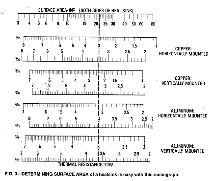

Which chip Lm3886t / Lm3886tf ?
Just wondering which chip is in the kit, do we have a chioce?
I looked at chipamp.com and he uses the insulated Lm3886TF and I used a Russ
Boss heatsink on my chipamp build, about 6"x6" I cut it in half with a hacksaw to 6" long 3" high and never had a problem keeping the chip cool.
I could use some input on heatsink size,
another post suggested "22 square inches of surface area for the LM3886T and For the LM3886TF you have to increase the surface area very substantially."
It says "Determining Surface area of a heatsink is very easy with this nomograph"
Well not for me if someone would explain this it would help.

The heatsink would be fine if it were a 3x3x2 pentium 4 sink.
