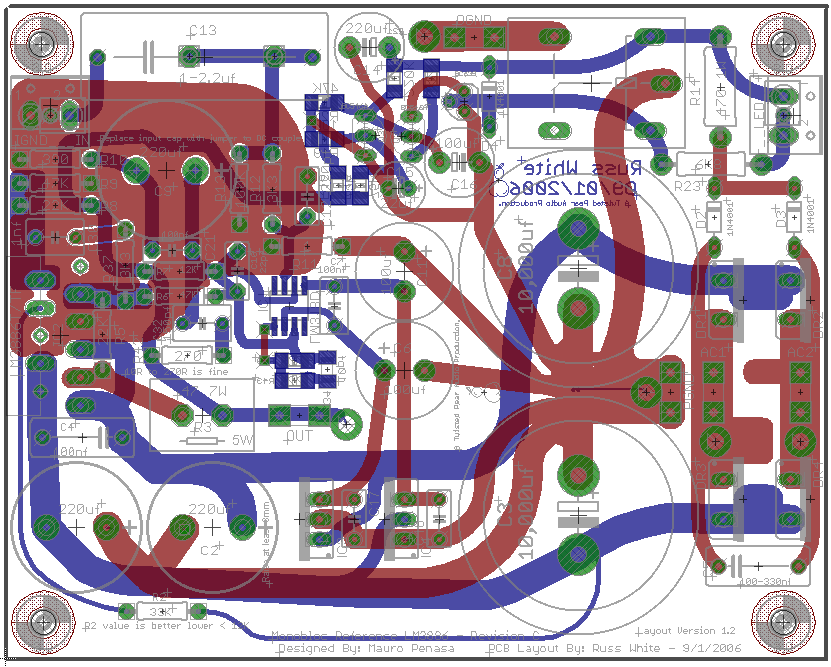

Ordered the taller sinks. 6.4W/C should do the trick very well and not leave room for doubt. Of course Avnet didnt get back to me and I had to track them down. By the time I did they were out of the 307 they had in stock this morning.. Had to go to Digikey. If you can believe it Digikey was second least expensive after Avnet. Of course Avnet is enforcing their restocking fee even though if I had been able to order the sinks I wanted this morning from them they would not have charged me, so if they had actually gotten in contact with me in a timely manner I would not have got the fee.... come on people!
Anyway, it sure is a nice day out!!
The more I look into the 24V supply for the speaker protection, the more problems I find. Besides too much voltage on the diodes, the value of R14 is too high at 470 Ohms. The attached files are from a LTspice simulation and they show only about 15 volts on the 24V rail. The relay needs at least 18 volts to guarantee switching. In the graph the green curve is the diode voltage, showing 58 volts reverse voltage. The blue curve is the LM3886 V+, about 28 volts from a 22V transformer, and the red curve is the 24V supply, running around 15V. When I build the amplifier, I will measure this circuit carefully to see what needs adjusted to bring it into specification.
If it does fit with no problems, I will give it a go. Not that having it hot is a major concern, but for my tastes 94Cº seems a bit on the high side, don't know about what long term effects could it produce...Dang, just deleted my post... anyway.
Bill, what about a 4Ohm load?
The same diodes have been used for quite a while now. How do you calculate your concern?
Spoke to Caddock about a half an hour ago. The engineer agrees with you. Fine with no problems at 5W but 7W would be a problem. We are cutting the bottom fin off of that heatsink so I am guessing about 15W/C and 15C/W is what he and I talked about. This allows for the LM318 to be under it. You only have to cut the left side of the sink. Right can stay as is. So I think that 15C/W would be a good estimation. However.. We could be safe and return those sinks and use this one
Digi-Key - HS104-2-ND (Manufacturer - 504222B00000G)
6.4C/W natural convection. Its pretty close to the same price so it would basically cost me shipping back to them and shipping again to me, but not any kind of deal breaker.
It is almost exactly twice as efficient with the same footprint.
Of course this only comes into play when dumping 100% of the power into your speakers, which would melt my speakers but I suppose some of us might actually play it at full volume for a while.

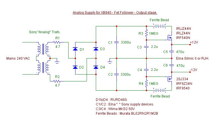

In an ideal world I would like to make also a FET based PSU for the LM318 and larger use of SMD...
Something like that:
I don't think Uriah is changing any value. The fact is that Caddock resistor's maximum power will be defined by the size of the heatsink attached to it. It is not like the usual 0.25W, 1W or 2W resistors, which are factory defined maximum power. So if Mauro said 7W output res., we might try to achieve that with a Caddock, so we must find the optimal heatsink size.Not to start anything but...
Mauro did an expert job with the original design and parts specification (values and tolerances). Why is there any discussion of "will this dissipate enough"?
I guess I lost sync when the conversation went from changing "brands" of the parts to changing "values" of those parts.
Appart from that, the higher the rated power for a resistor, the colder it will work, that meaning a longer life for the component.

I am embarassed to admit that I made a mistake on my BOM. The Caddock I used is not MP2060, but MP930, which is rated for 30 watts and a lot cheaper. It is in a TO-220 package. That has proven to be completely reliable after months of continuous use. Lesson learned: check records, and don't rely on memory.
The resistor presently selected for the kit is somewhat smaller, with less surface area for dissipation and heatsink contact, in a TO-126 package. I hope all these calculations and suppositions are correct and the smaller resistor is adequate.
The heatsink issue is troubling. I chose that particular sink because it is compact and had a decent rating. The alternative chosen by Uriah APPEARS to be more efficient but is actually slightly smaller. I am not an expert on heatsinks, but I think the rating appears a bit optimistic. How can it be so much more efficient, yet smaller? Perhaps it is more massive, with thicker material. I'm not sure how the TO-126 package will fit into it. I guess you can always use a heatsink for a larger package with a smaller resistor, but not the other way around, so it should be okay if a little sloppy.

T0-126 package could be the MP915 with a 15W rating [again...depending on heatsink]. Perfectly adequate. The slightly smaller body of the resistor and corresponding heatsink even give more compactness, which seems to be desireable on these boards as well.
Great price and for a group buy on a 100 or so is certainly an excellent choice. I think Uriah did VERY well on the selection that also kept the total kit price damb reasonable, especially considering the Obbligatos.

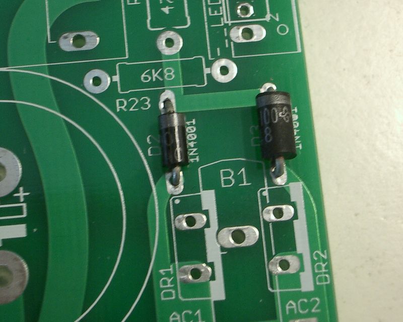

Bill_P talking about 1N4001 diodes led me to think about them particularly about the recovery characteristics of such diodes.
We spent money on MUR820 diodes for their ultra fast/soft recovery (less HF pollution) but in the same power lines we use 1N4001 standard diodes...
Uriah, do you think is possible to swap the two 1N4001 with other diodes?
If so SBYV27-100 are very good candidates (I've used them a lot of times with good results), relatively cheap and with higher specs than 1N4001.
The Mouser code is 625-SBYV27-100-E3/4

You could check if we might be able to fit a pair of MUR820 where the 1N4001 are. Although I don't think it will make any difference, because they are no supplying anything in the siignal path. What are your thoughts, guys?
Uriah,
MUR820s costs are twice...
Sure the rectified voltage is not used in the signal path but they are fed (and pollute) by the same AC1 and AC2 lines.
The HF noise injected in power lines then passes to the amp PSU...
SBYV27-100 is good electrically but it is larger than the 1N4001 so it would need to be checked for proper fit in the board.
SBYV27-100 are a perfect fit:
