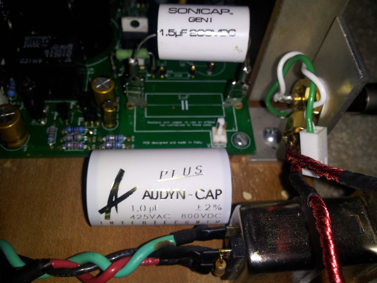

Look what the Cap Fairy left under my pillow. :D Thought they would be smaller but they are same size as the True Coppers. Will burn in and report findings an a few days.

I can't go back through all the threads, but has anyone tried a C13 cap with a value between 0 and 1uf? Would that range be too small to have a significant impact on the sound, or violate the design goals Mauro set out?
Bob,
I effectively created a cap of 0.5 uF when I put 2 1 uF K71 caps in series. It shouldn't cause any big issue and it didn't in my case. It will shift the corner frequency of any My Ref from about 1.6 to about 3.2 Hz. This is effectively the DC blocking filter, so anything below 5 or 10 Hz should be pretty hard to hear.

In fact the DC-coupled My_Ref sounds a bit thin, according the designer the amp is designed to work with a 1uF input cap which interacts with LM318 inputs.
The strange thing is that you heard such 'boost' only with True Copper...in your tests did you try the different orientation of caps?
From 0.68uF and up it will be fine.
But the amp is designed to work as intended with 1uF.
That safety factor has stopped me from trying no-cap as well.
if your pre has 0 mV DC offset you can try without fear.
But I would not permanently use the My_Ref DC-coupled.
