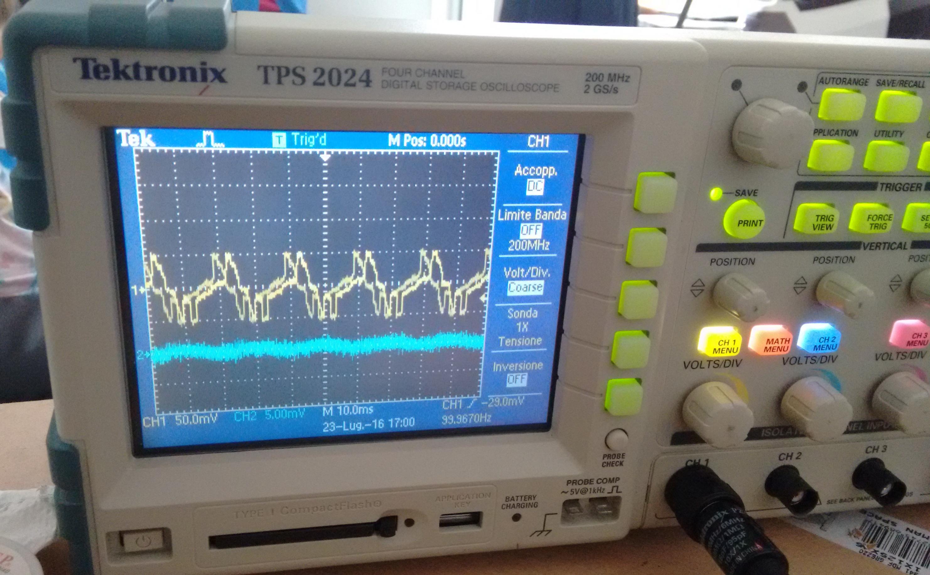

I replaced 2 zener, bd139 and bd140 (not lm317) and now I have the same behaviuor for both boards.
I prepare a dummy load of 5,4ohm with some resistors in parallel and try to do some test and measurement. I use a wave generatore on input pin with a sin at 1Hz and 100mV of amplitude and an oscilloscope probe on the load.
In attach you can see the result... the output is not clean but there is a troble at 50Hz.
If I don't put any input, the output is clean. If i put only positive pin of the input I havea strange wave at 50Hz (see attach foto).

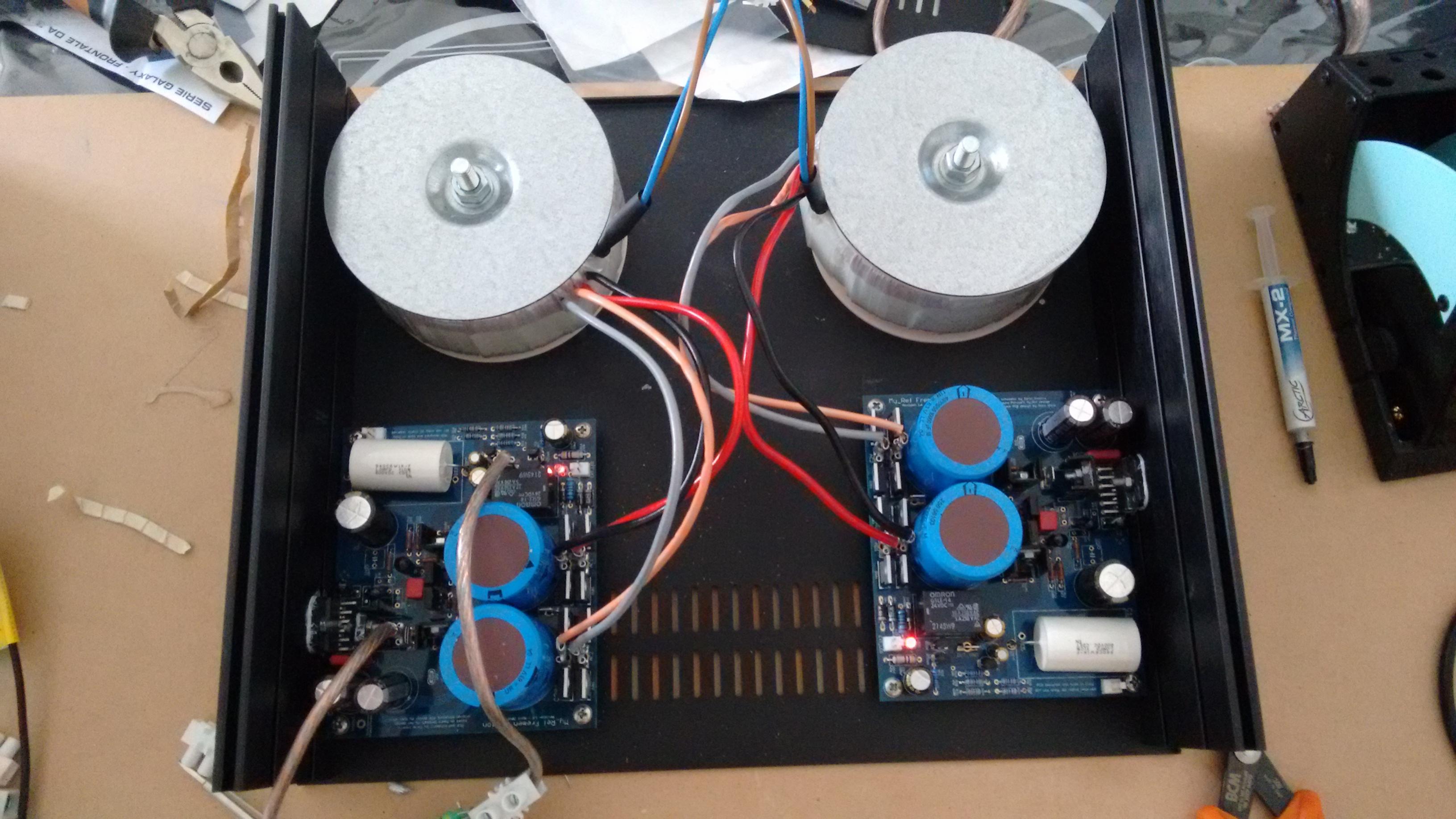

In attach also the ampli build...
I don't know if I have some wrong insulation or if toroid create interference on input...

The My_Ref is a floating design, it takes its ground reference from inputs.
Without signal ground connected at the input it will hum, the strange wave you see is exactly that.
Check also that heatsinks (the side panels) are at ground potential.
I can't see a connection to safety ground, the whole chassis should be grounded.
If the hum (with input grounded) does not disappear you should try to rotate the toroids until it vanishes.

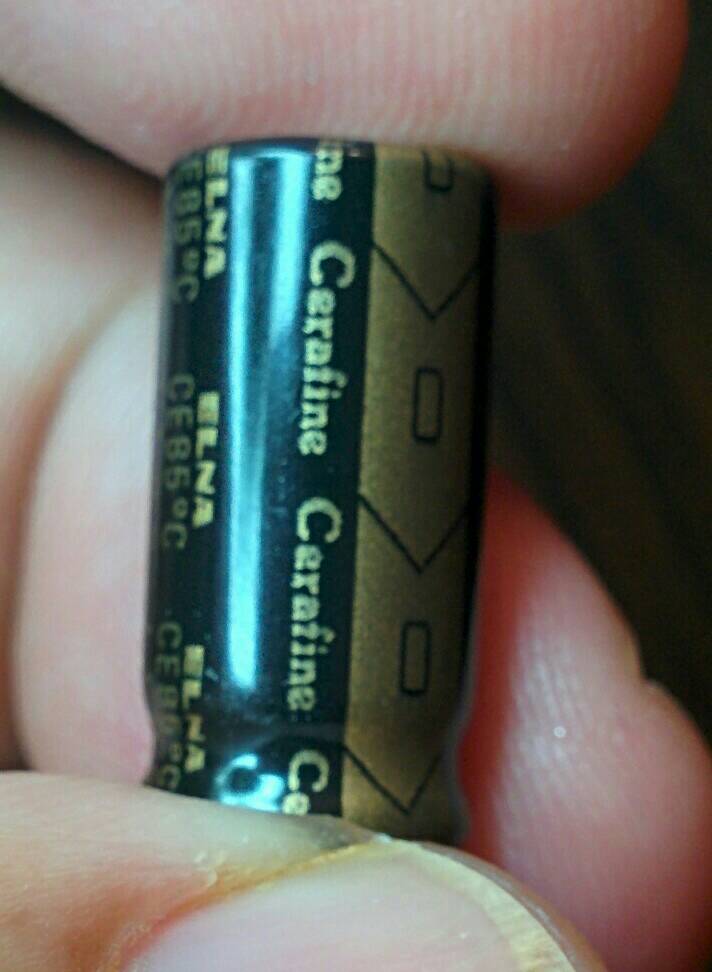

im a little bit confused about those Pk 220uf/4v, how is it possible to use them when we are suppose to use a 50 volts capacitor for c9? what is 4 v?
C9 usually see at best 2V so a much smaller rating than 50V can be used.
The theoretical maximum is 36V but just in case of fault.
So, in the past, we considered acceptable that C9 could fail in case of fault (the DC protection kicks in before anything bad could happen) to be able to use a really good sounding cap as a BlackGate PK.
Now using Cerafines rated at 50V we could have both, really good sound and circuit resiliency.
ok great to take that out of my confusion list! So we can use any audio cap like kz, es , pk or cerafines if they are rated 35v or more.
you don't recommend the elnas silmic II , brown version , but you like the black sleeve ones.
Did you ever try the nichicon ka? they are suppose to be audio caps at 105c!!!!!
And one more thing , the direction of the resistors and the plastic or ceramic capacitors, does it really matter?
Yes but that cap will have a great influence on sound, so far nothing sounded better than Cerafines 50V and Black Gates.
Nichicon ES is extremely clean but also really colored in the midrange, much better Elna BP if you want to use a bipolar, but Cerafines will sound better.
Yes, but they have steel leads, I don't bother trying them.
