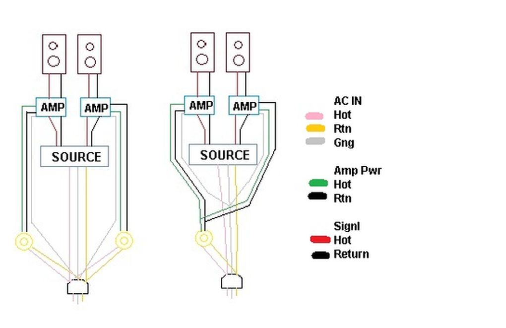

This does not happen with the MyRef because the stereo source ground is connected to the signal ground, and the dual mono at most are connected to each other via power ground which is separated from the signal ground by a resistor; if you connect the dual mono in a Class II configuration, the power ground are left floating from each other. Perhaps you have traced incorrectly.Rubbish.
I will say again: When you connect a stereo source to a dual mono you will get a ground loop.
Perhaps you have not traced out the grounding at all !
Why don't you address what I said is wrong instead of making hand waving blind statements like that.

because in post947, you quoted the whole post and did not highlight or identify what you took exception to.Why don't you address what I said is wrong
If you disagree with any one or many particular statements/phrases then be specific and we can have a useful exchange.
I have stated, in what I consider to be clear english, what needs to be done to identify the problem. You are doing the hand waving by generallising and getting distracted by introducing the HOT side of the Signal Route. I keep referring you back to the Return side of the signal route but you ignore that direction.

Sorry, in no post have I ever referred to the hot side. If I have, why don't you quote it out and highlight it?because in post947, you quoted the whole post and did not highlight or identify what you took exception to.
It has been clear that the RCA ground is connected to the signal ground on one channel, which is separated from the signal ground in the right channel via R11 in each channel. This breaks the ground loop you mention. Please check again and address the exact ground loop path you are talking about. Additionally, if people just leave the power ground (GND in the schematic) open in the MyRef, then the ground loop is not even an issue in a dual mono configuration.
Connect a stereo Source to a stereo amplifier.
That input has a Ground Loop.
That loop does not exist if one connects a stereo Source to a pair of Monoblocks.
That loop does exist if one connects a stereo Source to a Dual Mono Amplifier.
Look at the ground side ONLY to see the problem
the problem is the introduction of hum loops. If you connect a stereo source to a stereo amplifier, you will find that there is a ground loop around the connected system. Draw out the grounding system alone and you will see that loop. Draw out the comparable stereo source into two monoblocks and when you examine then grounding diagram you will find that the grounding loop no longer exists.
you probably get less channel separation.
this is coupling of the Signal, that is the Hot side.you just get less channel separation.
Trace out a stereo source into two monoblocks considering ONLY the grounding.

Sorry, but you are talking about a different amplifier, not the MyRef.Connect a stereo Source to a stereo amplifier.
Additionally, common power ground between two channels of power amplifiers also effect cross talk. If you don't agree, it's fine with me, I have no intent to convince you.
