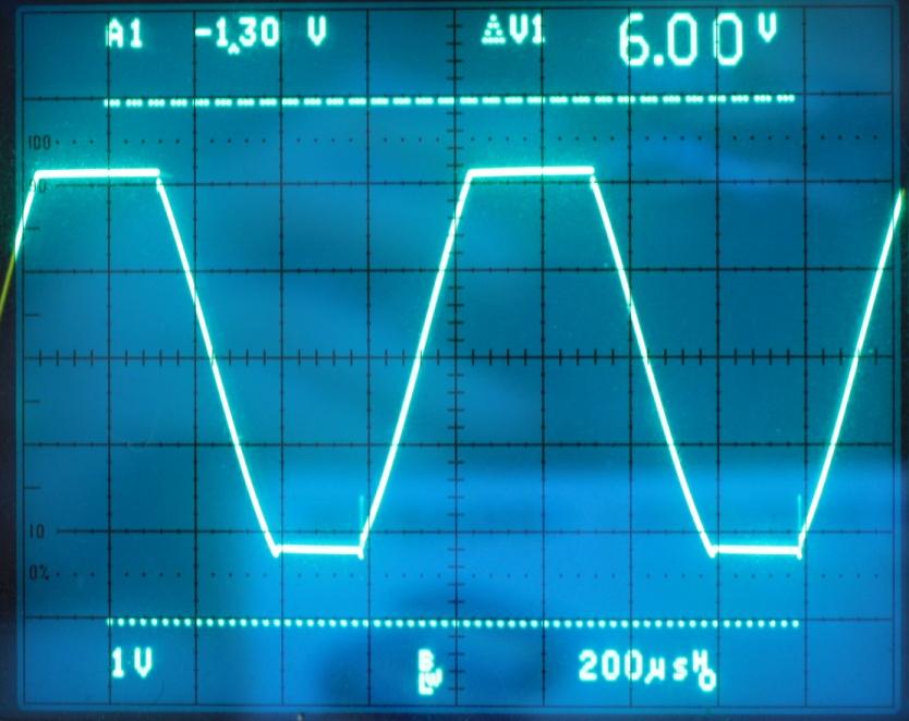

Yes, its possible and it is a little sticky http://www.s-audio.com/forum/download/file.php?id=31&mode=view (20KHz, top is the U2 output, bottom is the amp output). That's why I did not go with even deeper feedback. The clipping behavior is not good but acceptable. I could fix that, but see no simple ways to do that with LM3886. On the other hand if you listen -120dB THD amplifier, it is better to listen before clipping level anyway. I am going to make a clipping indicator, so if it does not blink, you listen the amp in a very low distortion condition for sure.

In this version have you altered the compensation to improve clipping behaviour?

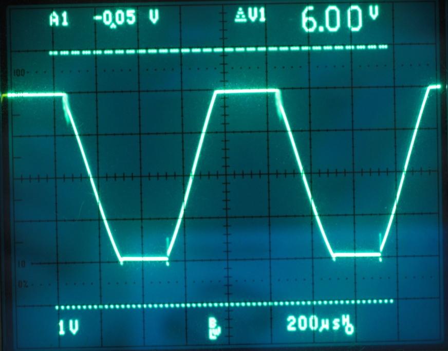

Here is clip with no load. Input is 1kHz sin.
