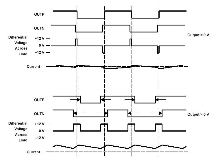

I think TEXAS INSTRUMENT is using BCA TOPOLOGY in their Class-D amps ICs.Check The Datasheet of TPA3001D1 Class-D IC.
Did they got the license or just voilating the Crown's Patent.
http://www-s.ti.com/sc/ds/tpa3001d1.pdf

The Above Quote BCA modulation is very similar to BD modulation as described by JAKA RACMAN and which is used by TEXAS INSTRUMENTS.
I am Confused Guys!
PLZ Help me.
Whats the difference between BCA & BD modulation can anyone explain?
CONFUSED COMPLIMENTS
AmPmAn

Jaka Racman said:
BCA is special type of output stage which also uses BD type modulation.
Best regards,
Jaka Racman
Can we say BCA is Modified version of BD modulation.
IN BCA the output stage employs inductors and free wheeling diodes, can assume same in case of BD modulation?
My question is If we eliminate inductors and Diodes in BCA modulation , then it becomes BD modulation??
AAAAMMMMPPPPMMMMAAAANNNN
I don't know about BD modulation, but if you eliminate the inductors in a BCA topology, then you'll get burning MOSFETs, because they are both on at the same time. If you remove the diodes, then most likely inductive voltage spikes from the filter or the speaker will destroy your FETs as well.
Can anyone enlighten us how BD without BCA looks like? Is it patent-free?
Felix
it is very simple. If you take classic full bridge output stage and designate sides as R and L and their states as H and L, then in class AD modulation you have only two states: LH,RL and LL, RH. In class BD you have aditional third state LL,RL or LH,RH. Both third states are equivalent. Class AD and BD are analogic to linear class A and B in that you have AC current flow through output stage with zero signal input in class AD and in class BD, there is zero current flow ( load is effectively shorted by alternating only between both third states) when idling. I am not sure if the principle of class BD modulation is patented, but specific implementations are (like using filterless output stage or ripple cancelation with double bridge output stage).
Best regards,
Jaka Racman
ok,...
but how do you avoid shoot through and destruction of the MOSFETs, which have, being switching devices, a very low resistance, in contrast to biased class A or B amplifiers?
BCA avoids this problem by inserting inductors, so that the energy can be stored and flow back during the off cycles. I can't really see how you can have BD without BCA.
I also found out that Rockford Fosgate has a patent on BD, but couldn't find any technical details.
alright, now I got it. It only applies to full bridge. This idea is not bad either! The main difference to BCA is that BCA can be operated as non-bridged, with the speaker between output and GND. As I understand, they both share the frequency-doubling behaviour and the smoother zero-crossing with ripple rejection.
The modulation is very different, though. In BD, upper and lower MOSFET are switched strictly alternating, and the two half-bridges operate in phase. In BCA, upper and lower MOSFET are in phase.
The BD amplifier still has a dead-time at zero-crossing. By shifting the phases of the two half-bridges, this can be eliminated, as shown in the datasheet, but this produces some ripple at zero input. BCA has zero ripple at zero input, and ripple increases proportionally with the amplitude.
On the other hand, I can imagine that BD could have lower output impedance, since it doesn't rely on filters to function, so they can be smaller. BCA needs inductors to work.
It's funny, I also had an idea how to solve the deadtime/shootthrough problem, but noone seems to use it yet.... maybe I should file a patent, it seems to be quite easy... ;)
BD modulation does not apply only to full bridge. Take BCA output stage, replace diodes with transistors and you have ground referenced BD amplifier. You can get rid of output inductors by using smal center tapped autotransformer. Very clever idea, but not mine and it is also patented.:bawling:
