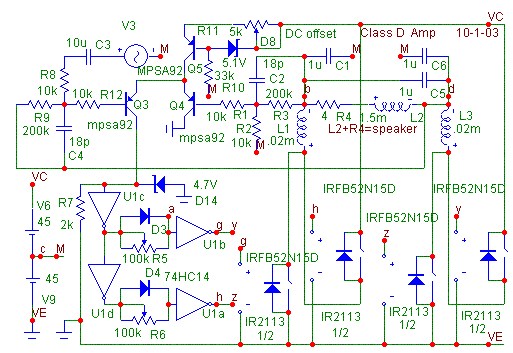

Hi all,
Now the amp has been changed and simulated to 20kz response. The feedback is now applied to both transistors in the differential pair. The performnce of the circuit has improved noticebly. The differential feedback permits the inductor and capacitor values to inadvertantly be of slightly different values, which is likely even if the nominal values are the same. Otherwise, the oscillation will not work correctly. The oscillation frequency is doubled from the prior subamp version, the power supply may need to be lowered to maximum +/-45 volts with fan cooling for full power output.
The new circuit can be done easily by stacking one IR2113 on top of the other. This way, the circuit paths are very short making the size small and EMI less. The pins not sharing the exact same
circuitry like the bootstrapped power supplies and the input and
output pins can be bent outward. Then the components can be soldered directly onto those pins. The entire amp, not counting the heatsinks, output chokes, and filter capacitor should take up an area of no more than 9 square inches. I think the amp should be able to put out 500Wrms if the mosfets are cooled with a fan, the power supplies are +/-45V at, and the mosfets are mounted on a 3X3 inch microprocessor heatsink. The link at the bottom gives ideas for building high power switch mode power supplies.
As before, the power for the control circuitry on the lower rail can
be regulated by the second differential transistor for more possible control over the DC offset.
As with the older design, the oscillation frequency can be
lowered by increasing the output filter choke values or the output
filter capacitors. The oscillation frequency can also be lowered by
increasing the value of the base resistors, R1 and R2 of the
differential BJT pair. The frequency can be increased by decreasing the values of those same components. The frequency should idle at 200khz and drop down to around 60khz at peak output. This variation of frequency raises the efficiency a lot because the mosfets have to switch less at full power.
I would like to be able to build the circuit to test it out. But, in case I don't get the chance, I am sharing the design beforehand even though I cannot say if the circuit works in real life. At the least it would need some adjustments.
Thanks everyone for your help. It makes things a lot easier.
Best Regards

Hi IVX,
wrong, magnetic flux cancels in common mode inductor, in differential mode inductor it is summed together. So single core inductor is larger than than the separated inductor used before. Do not forget that the core must be gapped or have distributed gap.
UU core is like E core without central post. TV set flyback transformers tipically use UU cores.
Best regards, Jaka Racman

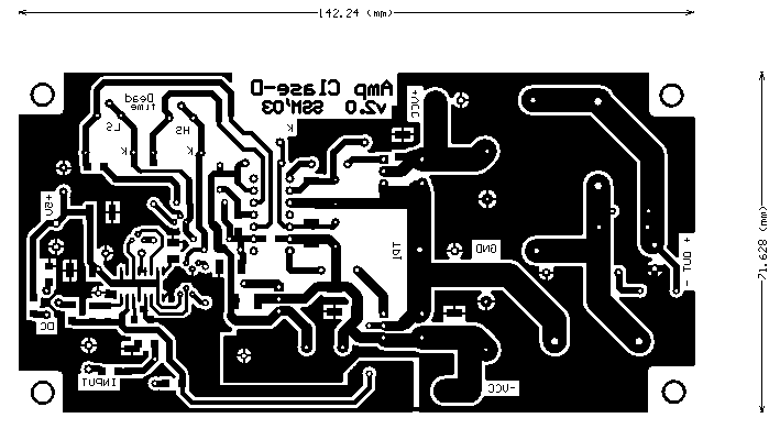

New design
Hello all.
I have finished the re-design of my PWM amplifier. I have designed a PCB board. Good news! it is single-sided! so very easy to make. The size is smaller and it has much less components.
The circuit has been greatly simplified. It is based on a MAX4295 chip, which implements a 250KHz PWM modulator itself and provide complementary outputs. They are level-shifted exactly the same way I did in my previous design, with the same dead-time control, but the XOR gates have been eliminated, thus attacking directly the inputs of the IR2110 chip. The rest is exactly the same. This should work at the first attempt, but the only issue is feedback: I will try to implement it the same way I did before, that is, before the output filter.
Have a look at the schematics and tell me what you think! I have no time by the moment to test it. I am willing to send the PCB design / schematics / construction notes to anybody who has the intention to etch the board and do some tests and share them with us. What do you think?
