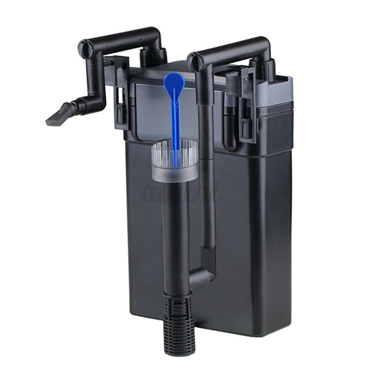

Hi BB, a couple of comments related to your issues.
1) A siphon system will work easily to allow a filtering system to work - drain or not. Millions of aquariums filter the water in this fashion.
2) With regards to the concern over damage from US technology, consider that no record cleaning fluid has been tested except possibly the one from the Library of Congress. The vast majority of those fluids were formulated at the kitchen sink so-to-speak. No manufacturer has tested their fluids in regards to damage over the long term. They just put their fluids out there with wild advertising claims. (I happen to use the LoC formula for just the above reason).
Something like this even does surface skimming.
Since there is no drain, how do they handle that. No one has responded yet. Do you use filtering, if so how on a machine without a drain?
A drain could easily be added by installing a bulkhead on the bottom if there's room or low on one of the sides. I am actually thinking about adding a return to my machine instead of dangling a tube over the top.
