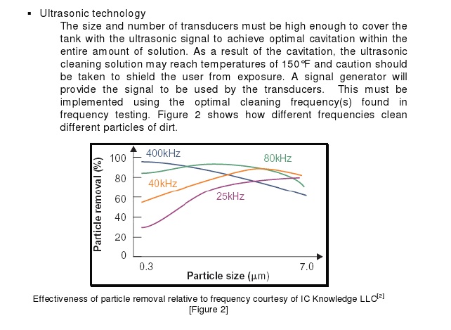

When considering filters, note that using a filter finer than 1 micron might or might not be overkill, particularly if you are using a 40 kHz ultrasonic cleaner. At 40 kHz, cleaners only remove about half the particles at a 0.35 micron particle size anyway, per the attached graphic.
If you feel the need to run a 0.35 micron filter, and you have a 60 or 80 kHz machine, and your pump can handle the pressure drop across a 0.35 micron filter, I'd recommend a cleanable, reusable one like this:
0.35 micron Harmsco Polyester filter
I use a 1 micron filter and get excellent results.
B B

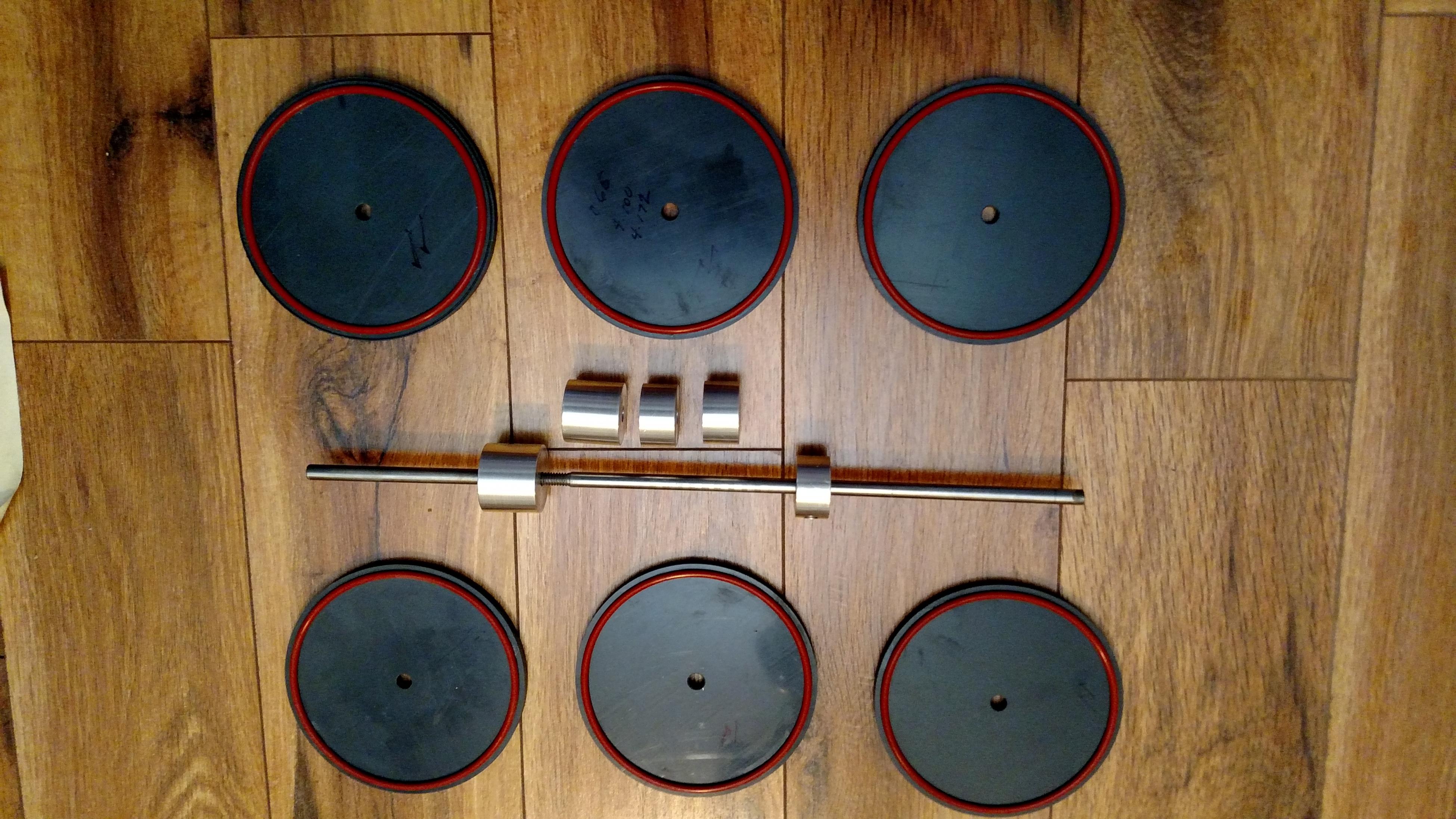

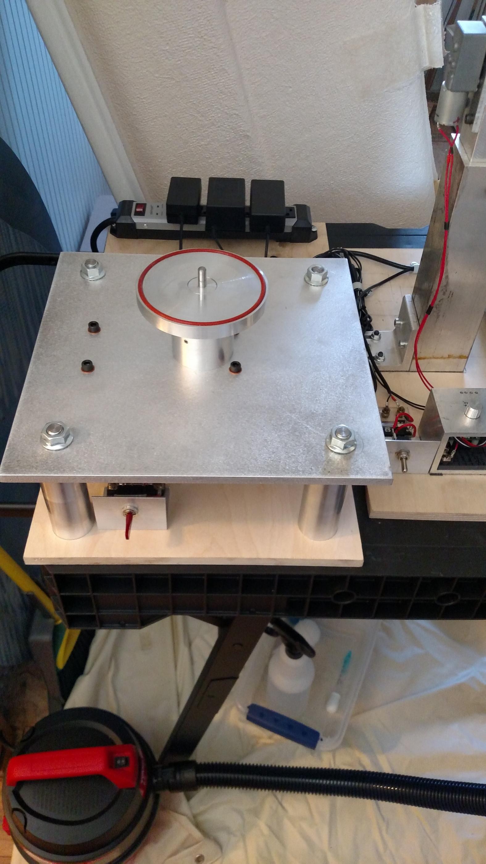

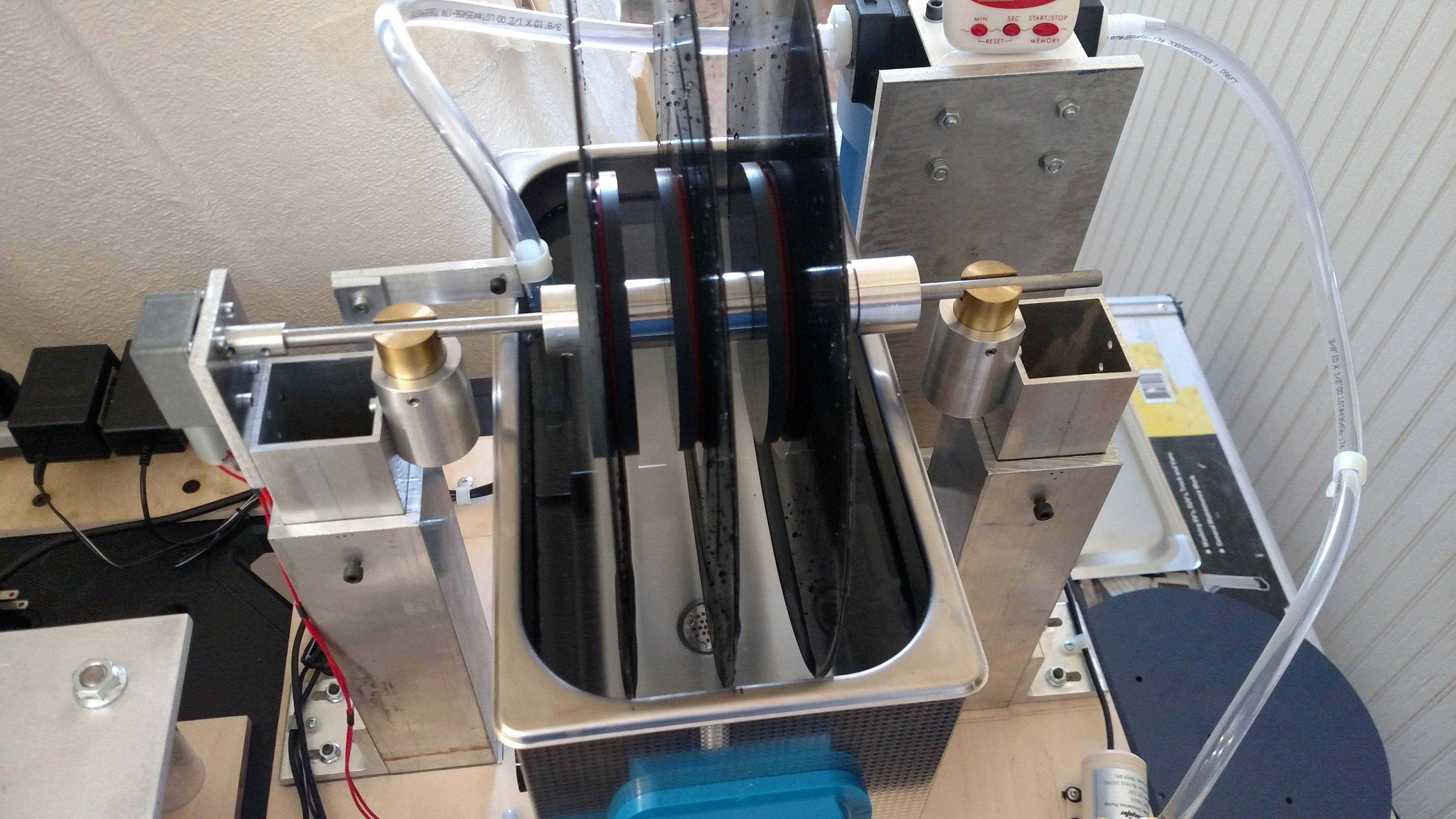

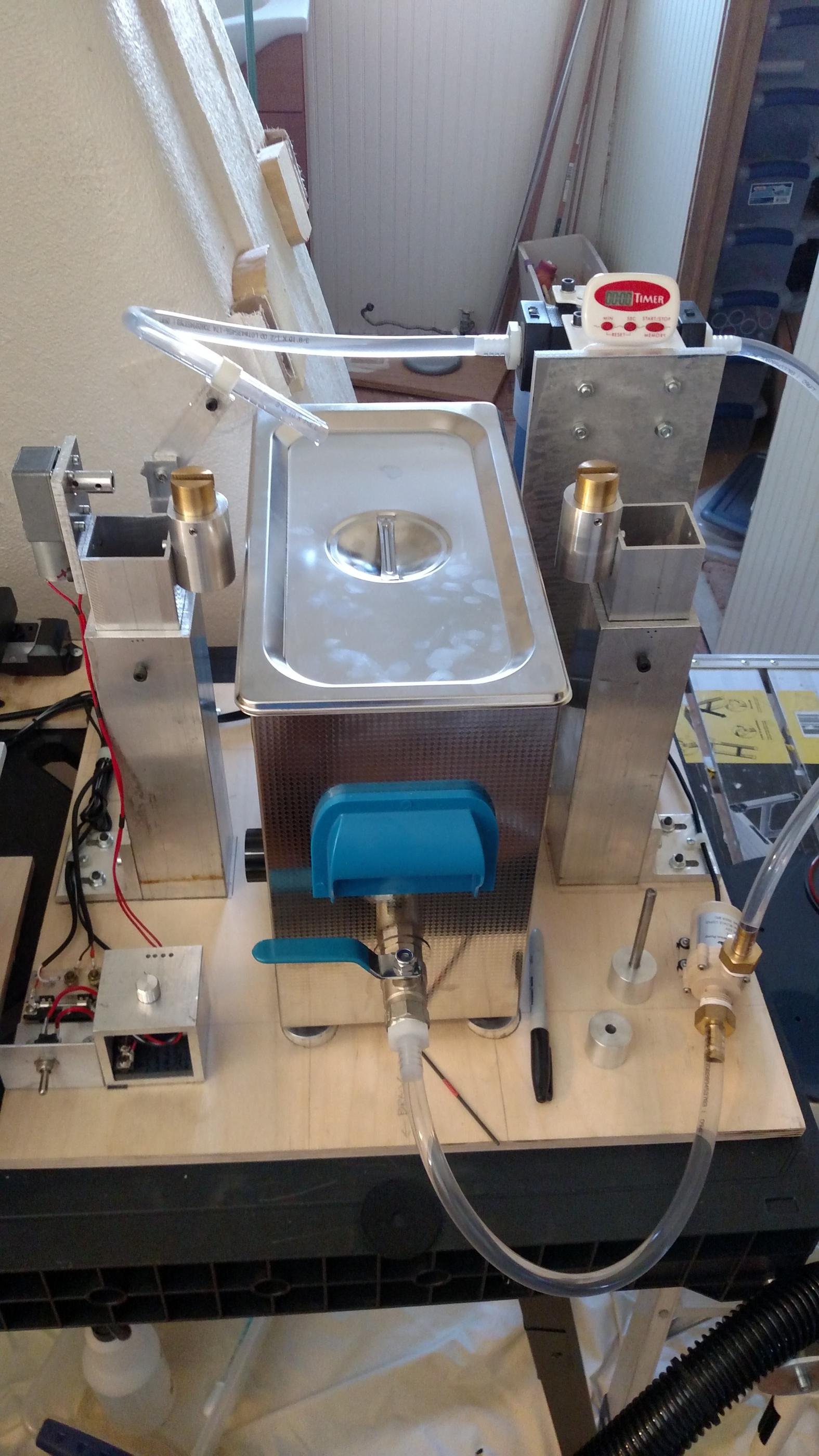

Though I would show my DIY Ultrasonic unit. This thread has been great. Used the pump on eBay that some have used and with a .35 micron filter it pumps 1.3 gpm. Put a pwm controller on the DC motor so I could get .25 to .5 rpm.
Only played with 12 albums so far. The Dynamics is really eye opening. Some congestion on some passages, major improvement. I have only used distill water with. 4 drops of dawn. Water temp has been around 85 degrees and been doing 3 revolutions per 9-10 minutes.
Also built vacuum turntable. Use a hand wand (Vinyl Vac) with it. Some distilled water, disc doctor brush, vacuum and done.
Would be nice if anyone else want to share experiences with cycles, speed, total time etc. And if they tried various cleaning formulas for the tanks. I am most interested on how it sounds than how it looks or if has a slight tick here or there.

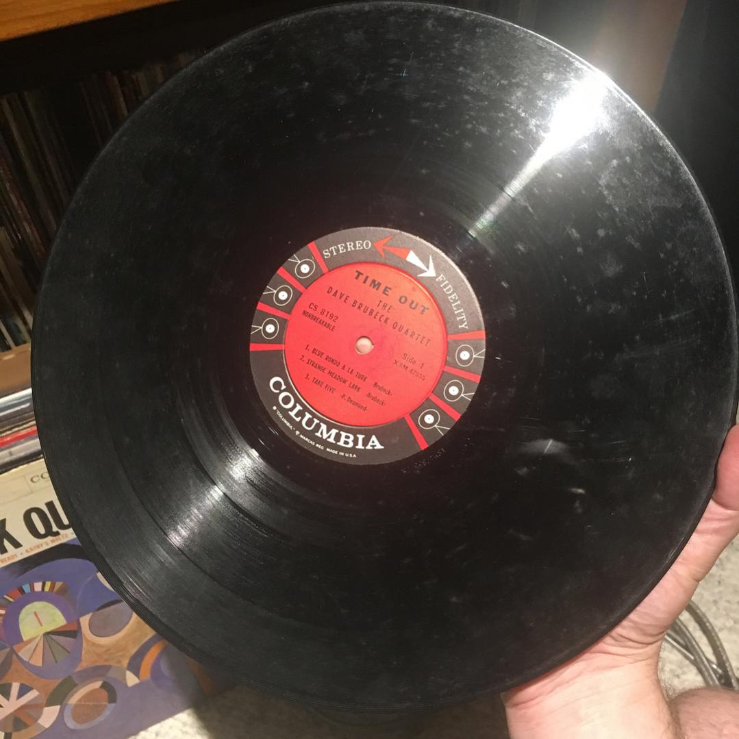

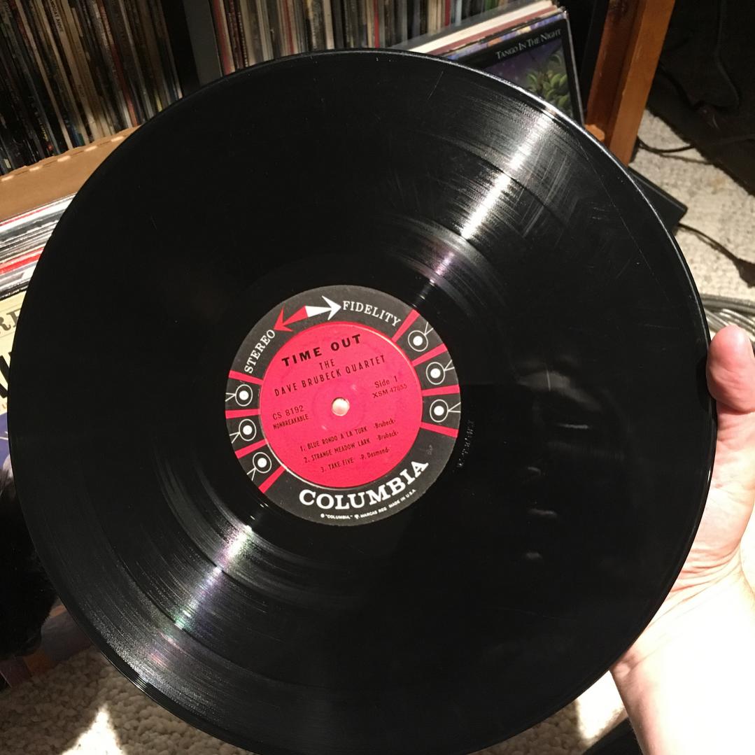

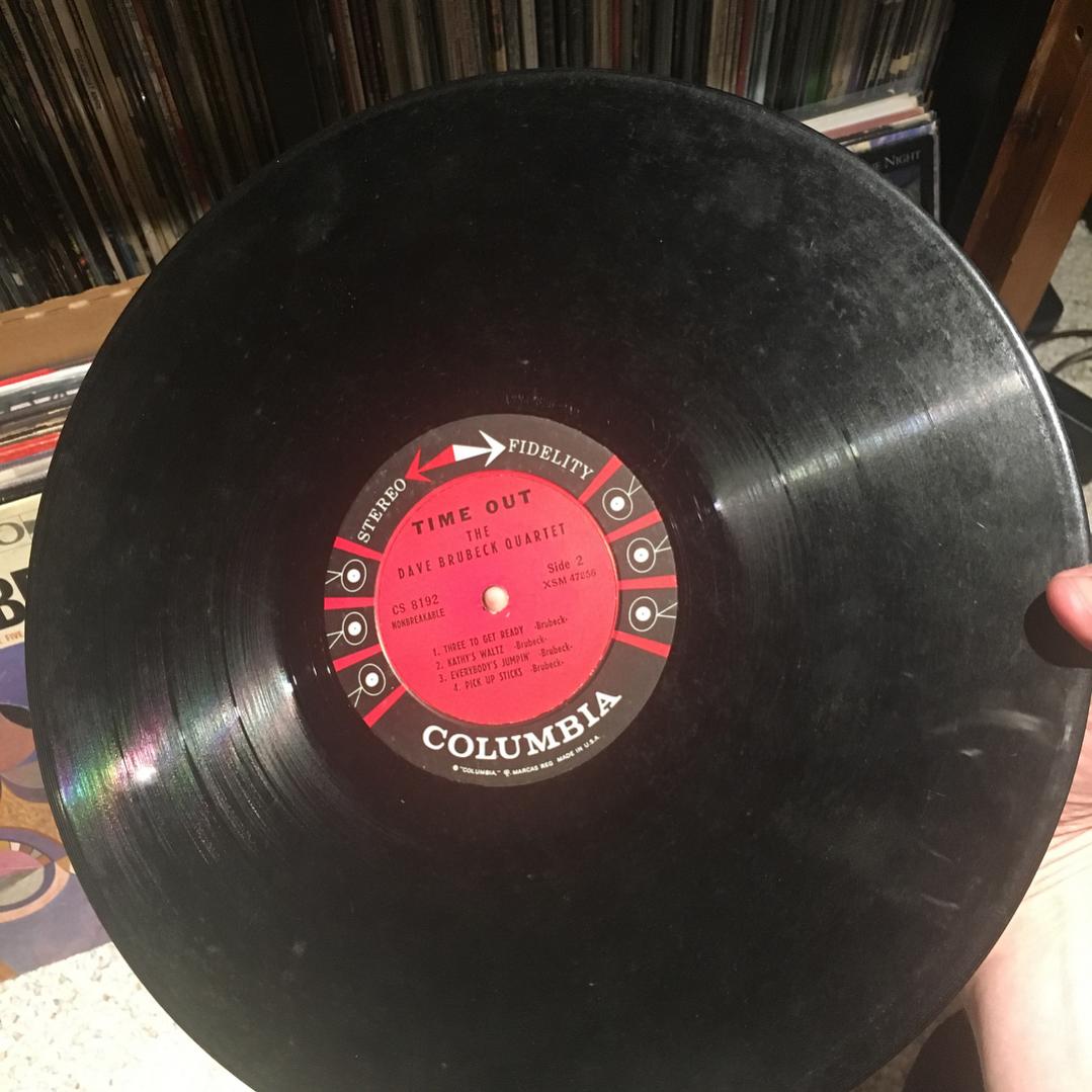

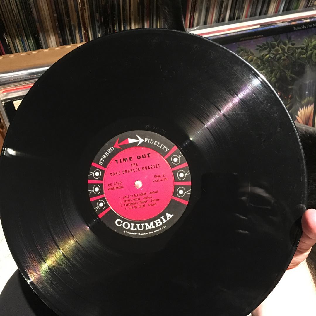

Maybe that helps with your question, maybe it doesn't. But here's some before and after of the Brubeck (you can still see where another pass or two might help). Just remember: there is no magic bullet. Each fluid or tool solves a different problem.
