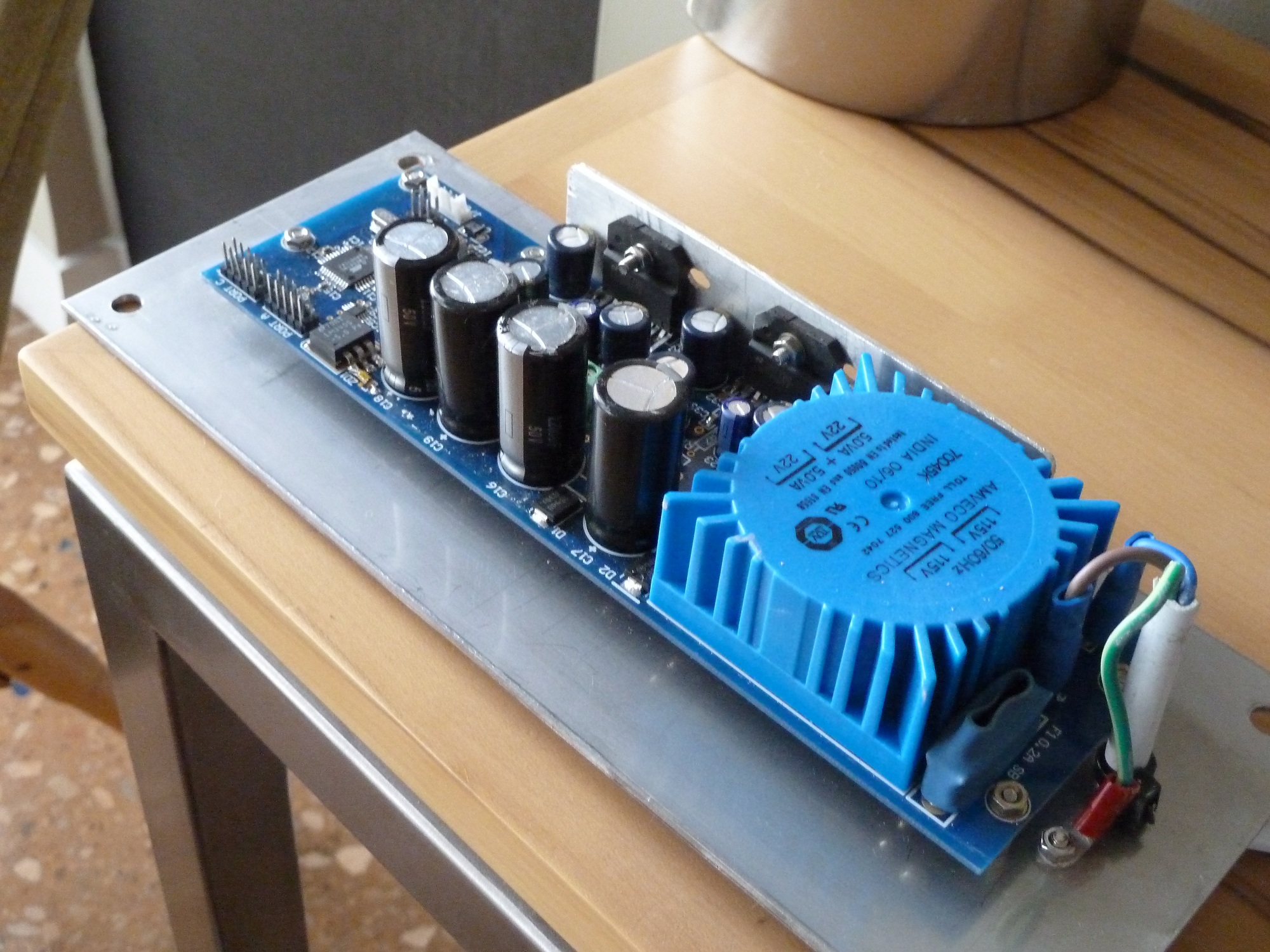

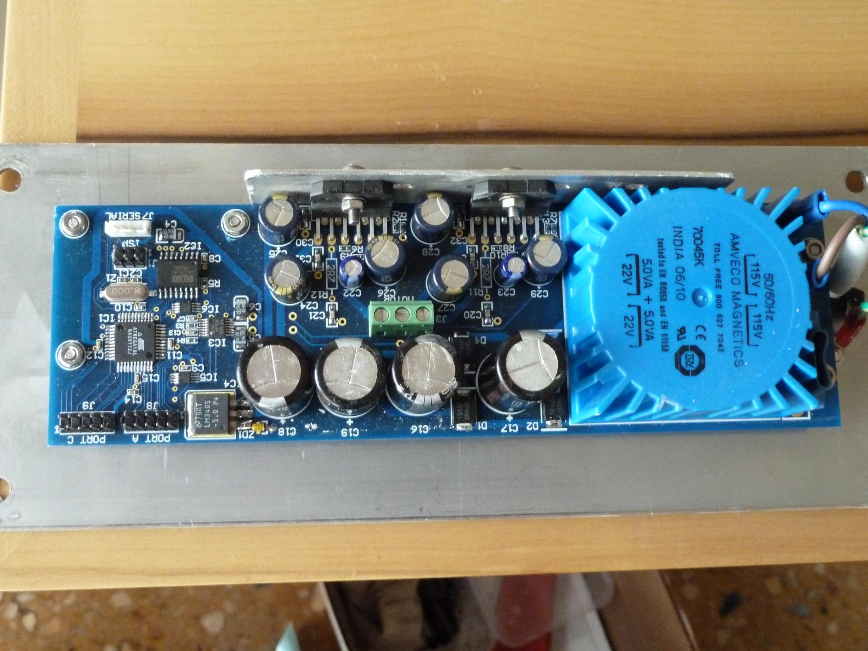

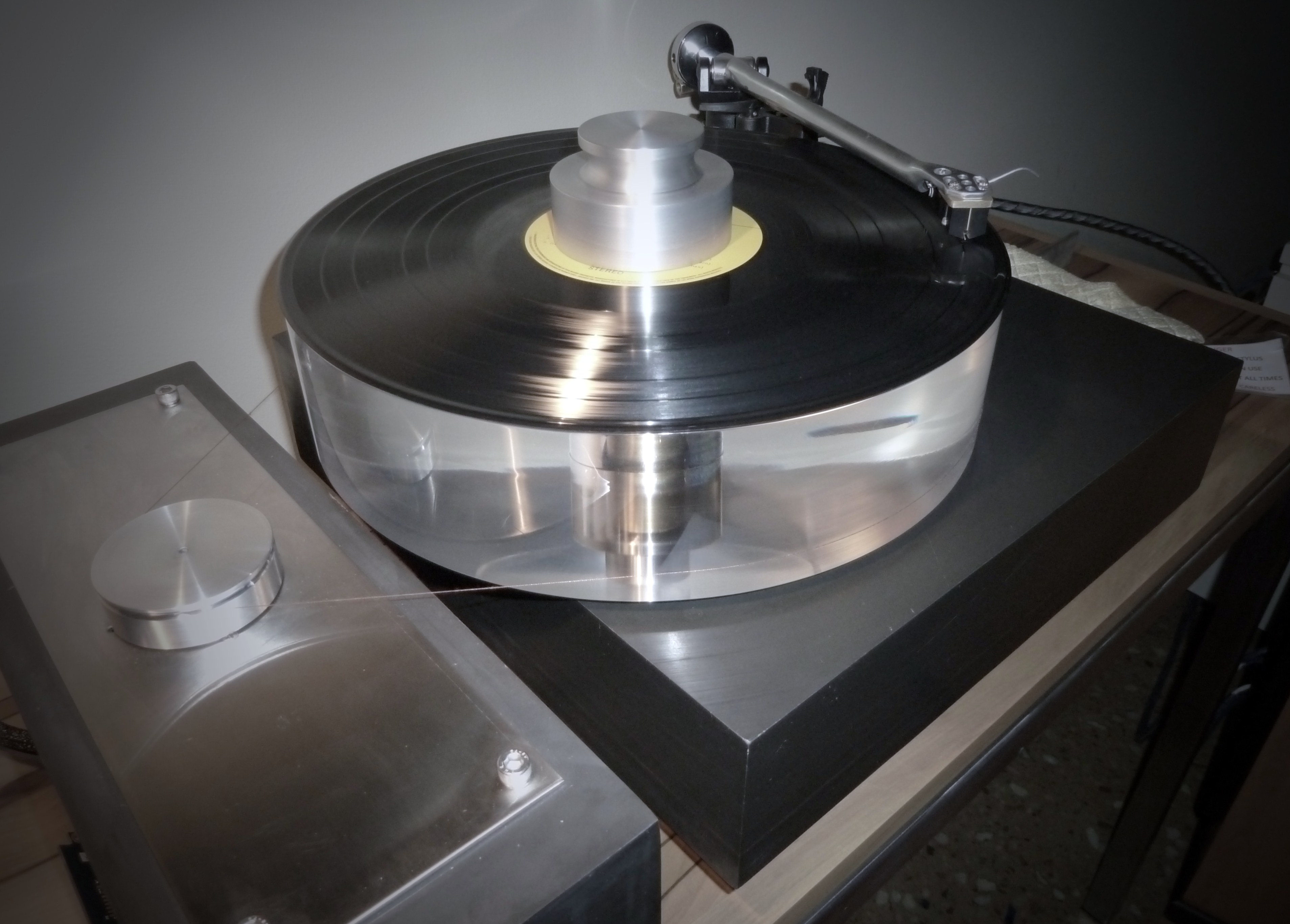

I can try. Lucky for me my brother is an electronic engineer. He designed and built the speed control for me. It is programmed to created the two 90 degree offset sine waves at any desired frequency. Voltage is also adjustable and it has a start up function where it produces maximum power to get the platter going. No push start needed here. The amp modules are basic LM3886 based amps, built in to the design.
Pics as promised:D
