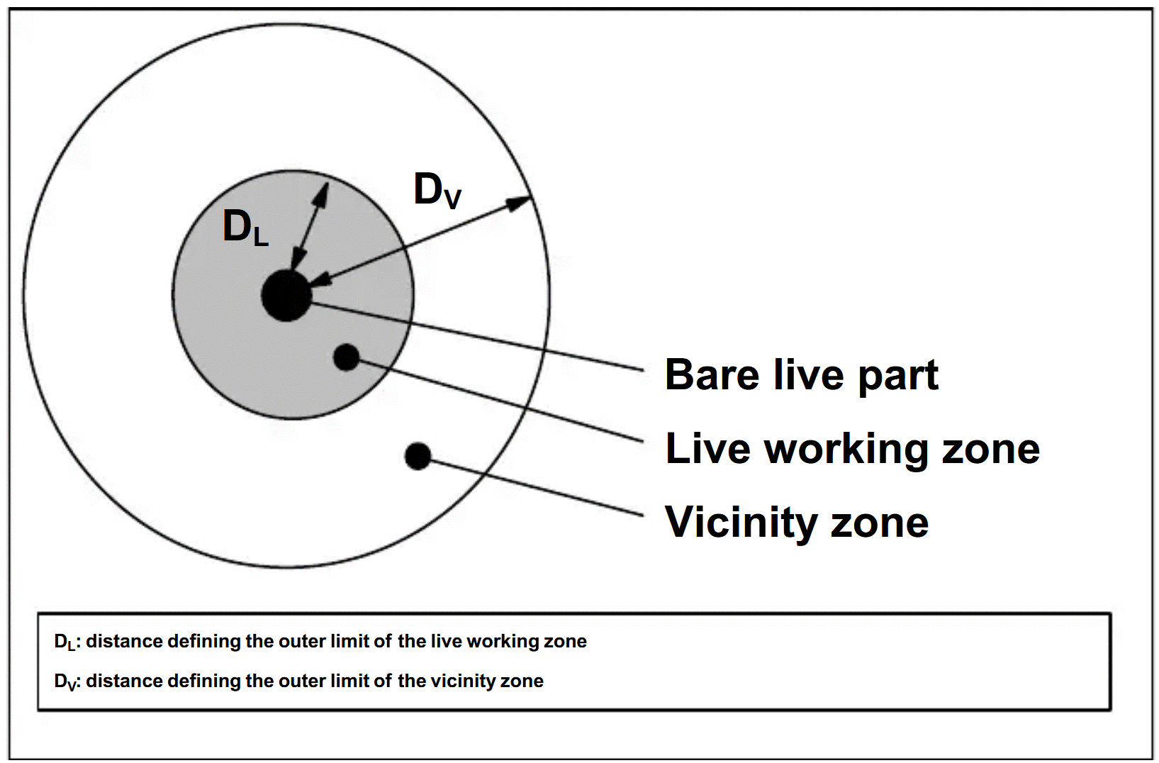

I can only tell you that in my training to become a technician for a district net operator (DNO) the only hard values that are given are minimum acceptable distances between you and a (bare) live conductor with only the air as an insulator, and even those values are called guidelines.Thanks. However, that's just yet another website that Google would also tell me about. What I am looking for is a well substantiated text from a reputable source. When it comes to information about safety and potentially lethal consequences I'd prefer something a bit more than just yet another website with ads and comic movies.
Those values (DL for 'minium acceptable distance in air defining the outer limit of the live working zone' and DV for 'minium acceptable distance in air defining the outer limit of the vicinity zone' are derived from EN 50110. For (e.g.) 10 kV they are 120 mm and 1150 mm. Below 1 kV, they are 'no contact' and 300 mm.

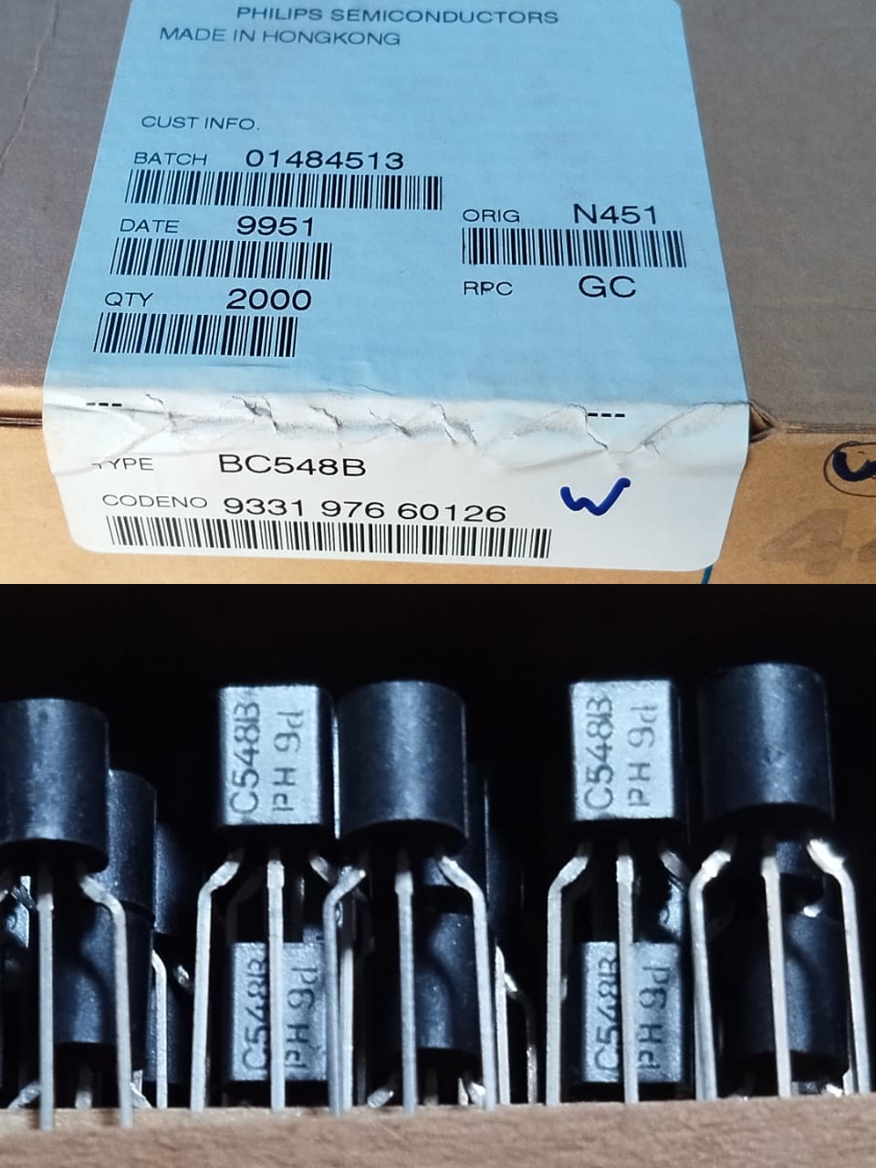

Same question i have. Vendors like alixpress full of such silver faced 'philips' to92 transistors. Not sure about their authenticity.Hi,
question about BC54... and BC55.... series made by Philips
I was sure , all BC series small transistors made by Philips got silver face plate with black letter marking , but lately faced with
BC549B transistors ( supplier claim it genuine Philips ) which are completely different means:
- no silver front paint
- smaller plastic package ( pictures attached)
Any experience how should original Philips small transistors BC54.. and BC55... series look like??
Aliexpress most probably is a synonym of fake.Same question i have. Vendors like alixpress full of such silver faced 'philips' to92 transistors. Not sure about their authenticity.
Best regards!
If they're from early 90's, i guess not. Everything depends on the source & good measurements.I didn't take any risk and bought ONsemi(FC) BC series instead.Are these fake 🤥?

Not every single component sold on Ali is fake. Those may indeed be BC548’s from 1999. Whatever it is, the seller got it cheap. The questions you have to ask is, 1. Is it possible to get them cheap and have them be real? 2. Are you willing to take the chance buy and try? 3. Does it even matter in your application?Same question i have. Vendors like alixpress full of such silver faced 'philips' to92 transistors. Not sure about their authenticity.
Any serious professional user would answer NO to all 3. Your mileage may vary.
